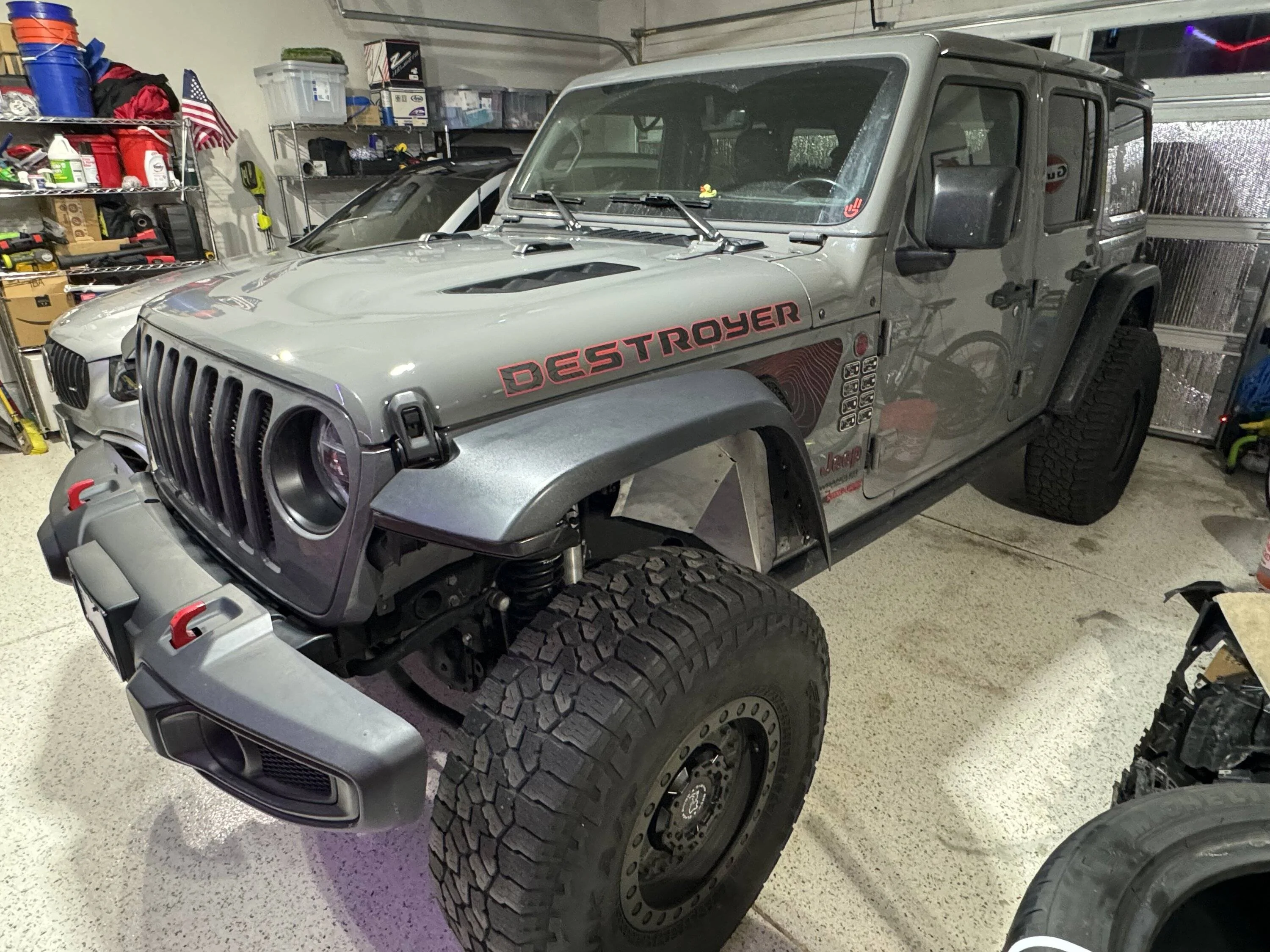

I’m a little overdue for a progress report so here’s where we’re at with Destroyer after a little over 3 weeks:
As is tradition, parts started getting ordered immediately (most preferred interior bits and minor things that are quick to install like grab handles). I put my GMRS back in and took a little more time to get the wiring and antenna coax routed a little cleaner this time. Much happier with how I have it laid out compared to before. I’m waiting on a lot of armor right now to reach me as it’s all getting fabricated (guess the CavFab and LoD backlogs are pretty steep already). I did swap the shocks out for some Fox IFP’s which made a huge difference in the way it rides. I’m still not totally sold on this Teraflex lift so at some point it’ll get replaced. I’ve already got a new driveshaft on hand so that’ll get bolted in next week to take care of any potential issues there with clearance.
One thing I’ve noticed though being under the jeep now to change oil and the fuel filter is the amount of bump stops installed. I can’t help but feel like whoever installed this lift did it for the ā€˜mall look’ instead of being truly functional. I’m gonna need to figure out how much it needs removed now that I’ve made sure rubbing my fenders won’t be a problem:
Jeep Wrangler JL Destroyer: The '21 JLUR EcoDiesel IMG_4101
Still haven’t finished the rear fenders yet…
Jeep Wrangler JL Destroyer: The '21 JLUR EcoDiesel IMG_4103

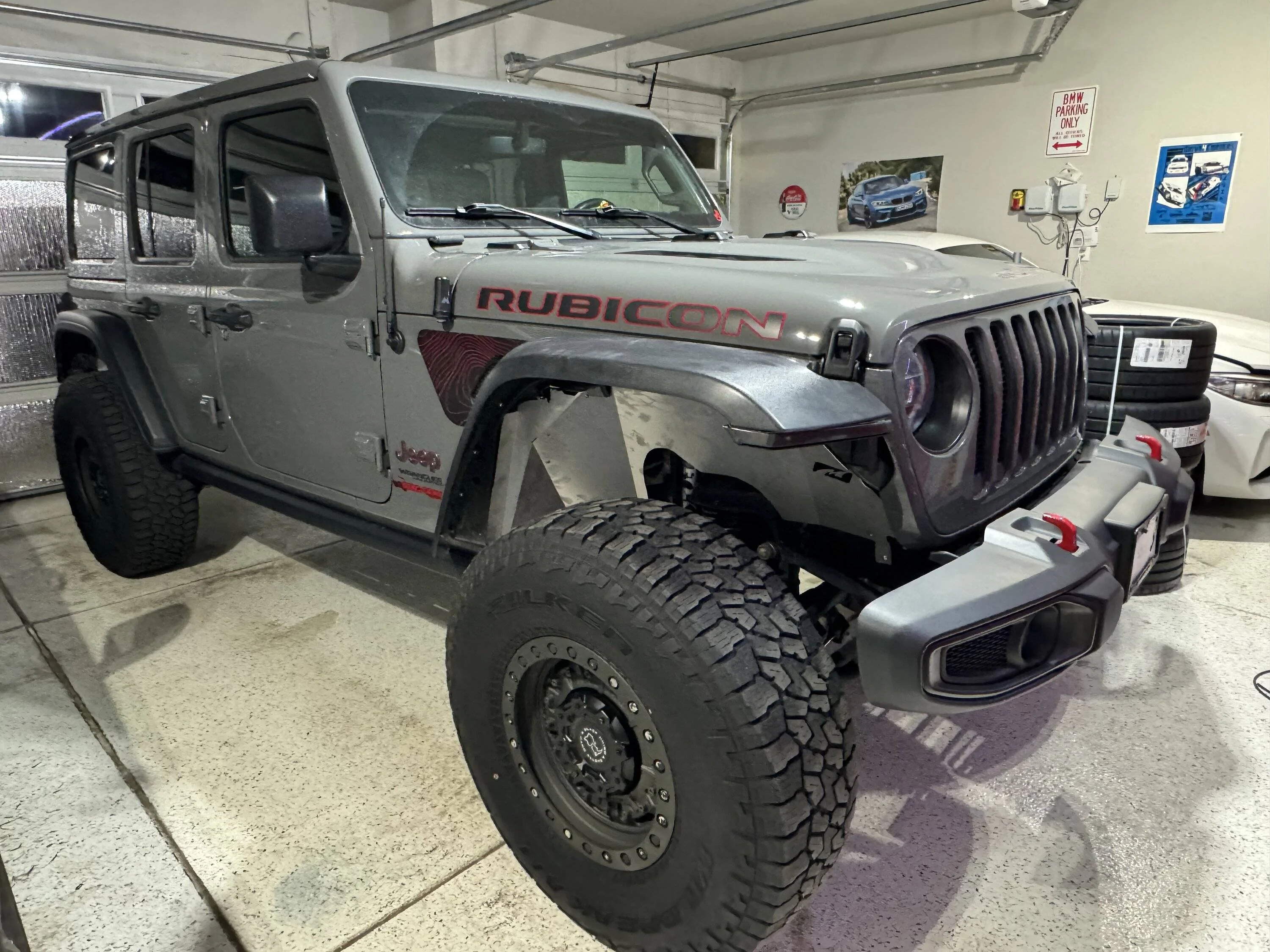

Front is coming together nicely.
Jeep Wrangler JL Destroyer: The '21 JLUR EcoDiesel IMG_4104

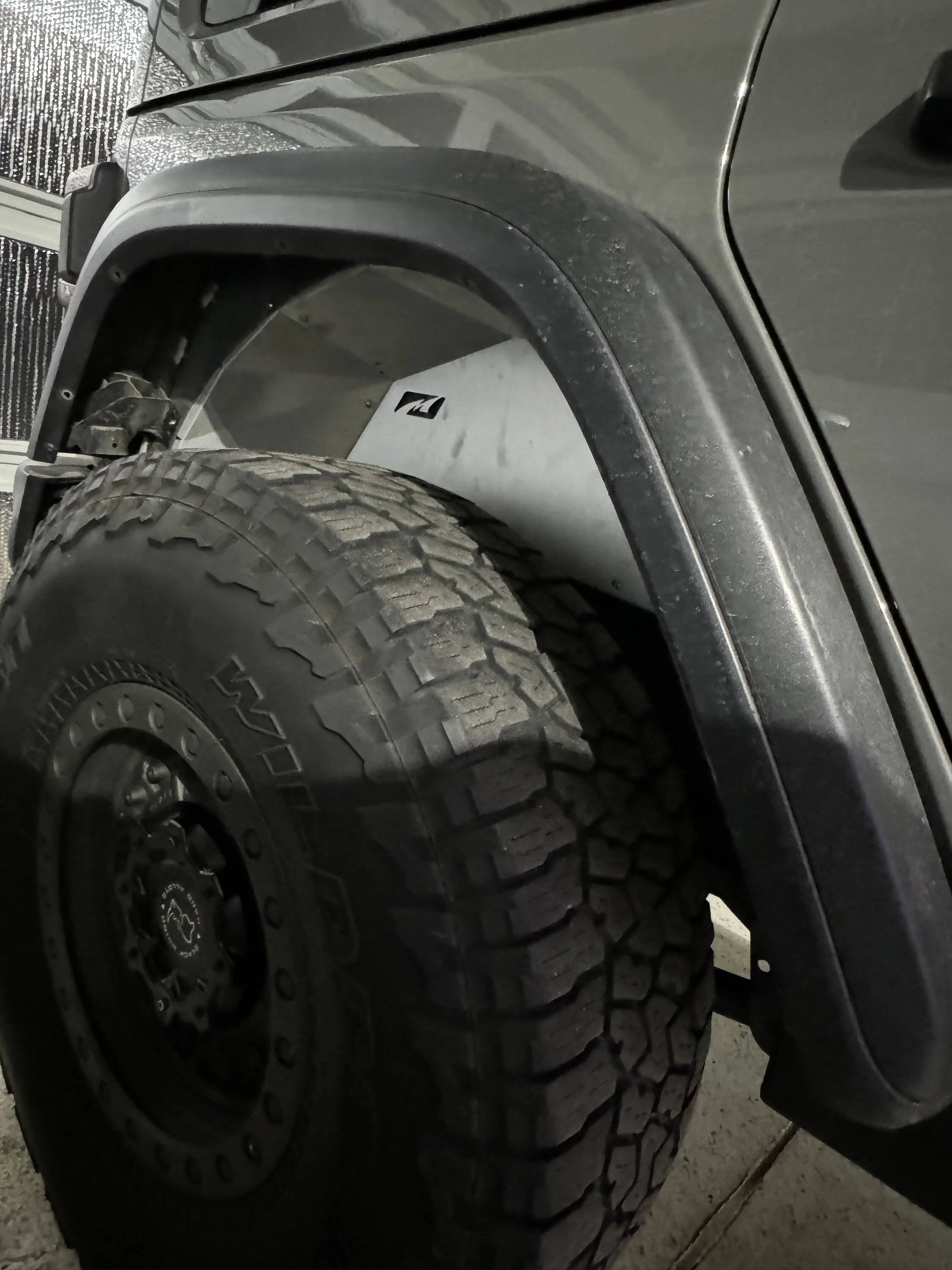

Yep, I finally fender chopped one of my Jeeps. ? Admittedly I’ve had the inner fenders on hand for a while. They were meant to be installed on my last 4xe, Achilles, but it never happened (lucky me since I don’t have to buy twice this time). The real ā€œDOHā€ moment for me though is when I realized I bought the Motobilt BLANKS instead of the precuts. The original thinking here is to minimize splash in the engine bay from dirt and debris. The sucker punch though was having to cut out the material I didn’t need to clearance for the spring towers and shock movement. Luckily my band saw made short work of it, but there were a couple trial and error cuts to slowly whittle away the material that I didn’t need.
Let my pain be a lesson for you to avoid. ?
As far as the lights/brackets go, I went with kind of an unknown quantity and ordered Infinite Offroad’s kit. Overall it’s pretty high quality and I like the coding for the lights. Looks very nice installed…from 5-10 feet back. Up close is where I have issues (and maybe it’s just inherent of these kinds of lights and brackets) but the fitment isn’t really that great. They don’t perfectly align the fenders contours up front and they stick with VHB tape. I can see them popping loose at some point so I might need to modify them at some point but the lights themselves have a 25 year warranty which is pretty incredible.
The front fenders got an ā€˜upgrade’ with Artec mounting hardware to replace all the plastic clips. I have the hardware for the rears but I’m tempted to leave the plastic clips and see how they hold up vs the fronts off road (I’m sure it isn’t gonna make a tangible difference but it’s worth at least trying).
Next updates: front bumper, winch, rock rails, and rear bumper.

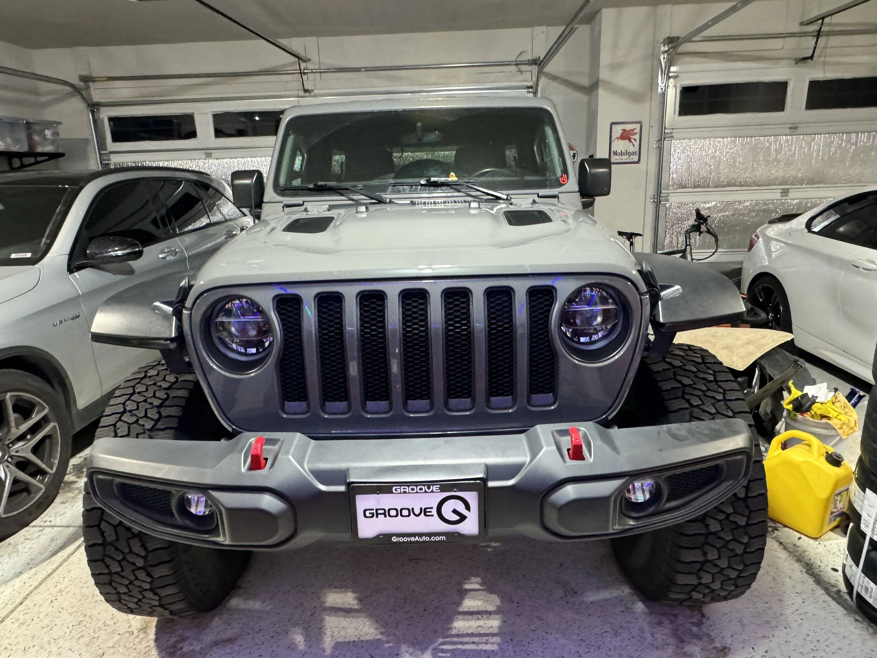

I got impatient and decided to sneak in a preview of whats been going on:
Jeep Wrangler JL Destroyer: The '21 JLUR EcoDiesel IMG_4206 small
Shouldn't have any air flow issues now. ?

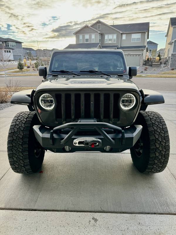

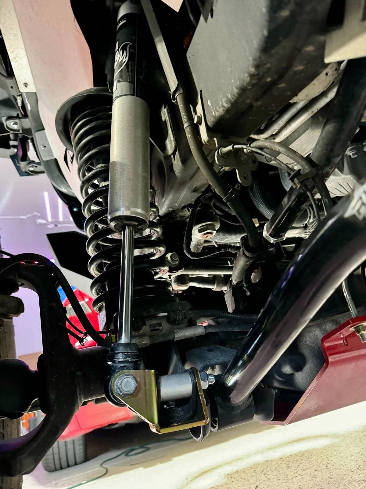

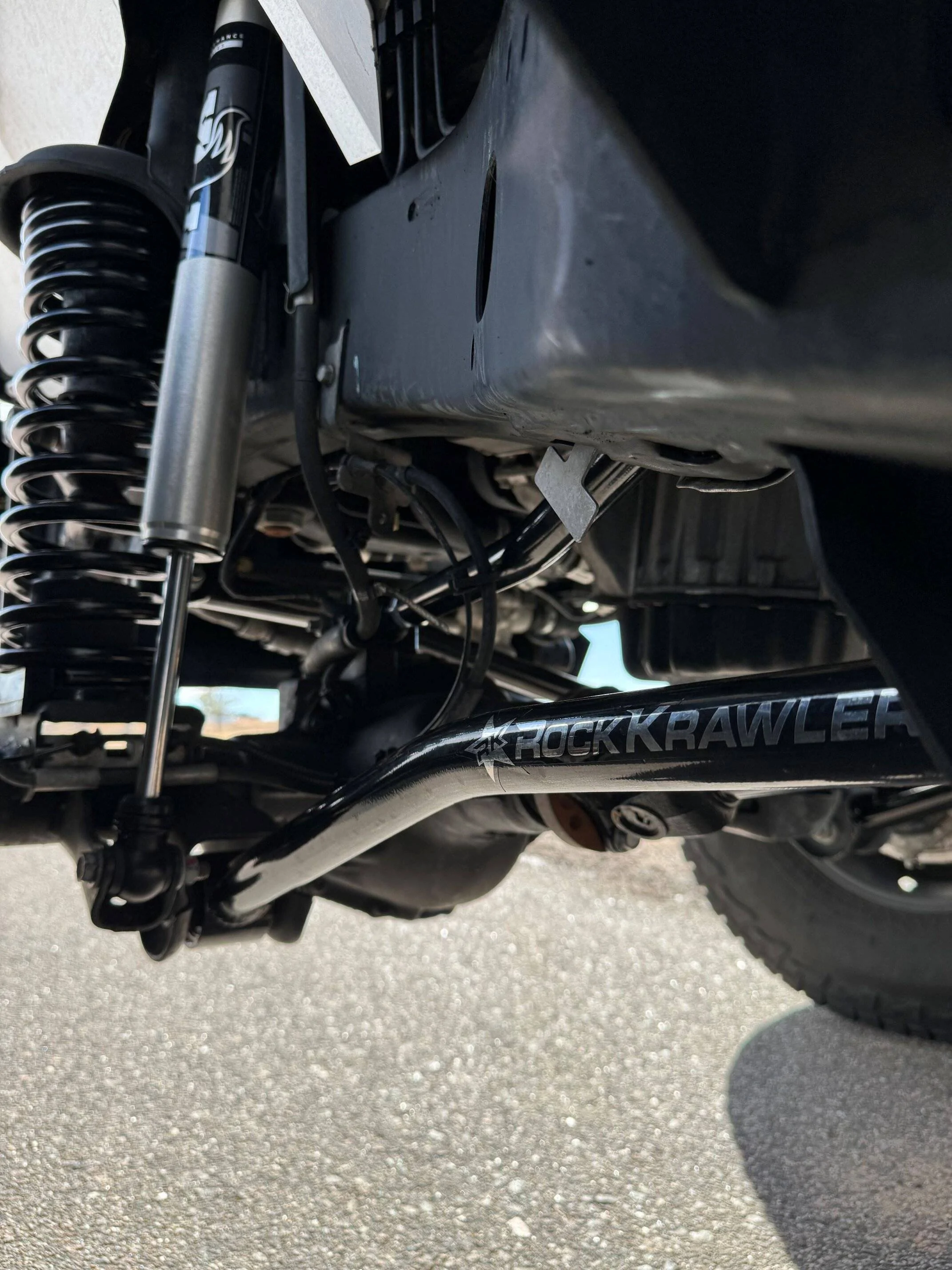

After what seemed like an eternity working in the garage yesterday, the new suspension is finally finished:
Jeep Wrangler JL Destroyer: The '21 JLUR EcoDiesel IMG_4213
Jeep Wrangler JL Destroyer: The '21 JLUR EcoDiesel IMG_4214
Jeep Wrangler JL Destroyer: The '21 JLUR EcoDiesel IMG_4223
Rock Krawler's Ultimate Adventure 2.5" lift was the choice this time around. After having 2 4xe's riding on Metalcloak suspension, I figured it was time to branch out and try something different.
Pulling parts out of the boxes gave me a pretty clear indication that this system is very robust in it's build quality. All of the arms feel significantly more stout and better made than Metalcloak. The bushings are very interesting. The inner sleeves are some kind of delrin or poly material that will fly out of their home if you aren't careful (they're all secured with zip ties from RK in the box). The trackbar is a little different in design from the arms and has a heim joint with 2 stainless caps that slide over to complete the adjustment end while the frame side has a zerk fitting to keep the bushing lubed. Everything was packaged probably about the same as MC apart from everything had it's own soft plastic bag. I don't remember that being the case for some of MC's parts so it's nice to see RK takes a little extra care here.
One thing I'd like to note that's diesel specific is the passenger side upper arm frame mount. Who the F$#% at the factory thought it would be a GOOD idea to mount the bolt in such a way that the damn DPF has to get unbolted from the manifold in order for it to be removed?! Luckily I managed to wiggle the heat shield and the bolt enough that I got it out (several hundred curses upon the engineers later) and reversed the orientation of the bolt and flag nut. How? I simply bent the flag nut in such a way that it now catches on the inside of the mount bracket (without interference to the arm mind you) and can still cinch down to spec. The bolt head is still easy to access from the outside of the frame hole. *IF you're curious, feel free to drop me a DM and I'll send photos. It makes life WAY easier should you need to unbolt it later down the road.*
Apart from the removal of the Teraflex junk testing my patience (their bushings are god awful just like stock. Seriously, don't waste your time or money on their arms) and getting everything torqued to spec, I bolted up my new driveshaft (MC) and took Destroyer for a quick test drive. ABSOLUTELY INSANE transformation here. No more jarring bounces and bangs, no more squeaks, just silky smooth road manners. It's hard to compare this to my MC suspension on the 4xe's but from what I can tell, the handling has less of a tendency to roll and dive. It's firm but not overkill. Paired with the Fox IFP's it just flat out drives like it should and doesn't feel like a handful.
Overall I'm extremely pleased with my decision to go RK this time. I honestly don't know if I'd even consider MC as a 'recommend' any more. RK might be a bit pricier especially since they rarely run sales on their products, but in my opinion it's absolutely worth the extra coin. Special thanks to @Roky for his build thread and input to this board. It made my decision easier to justify this time around.

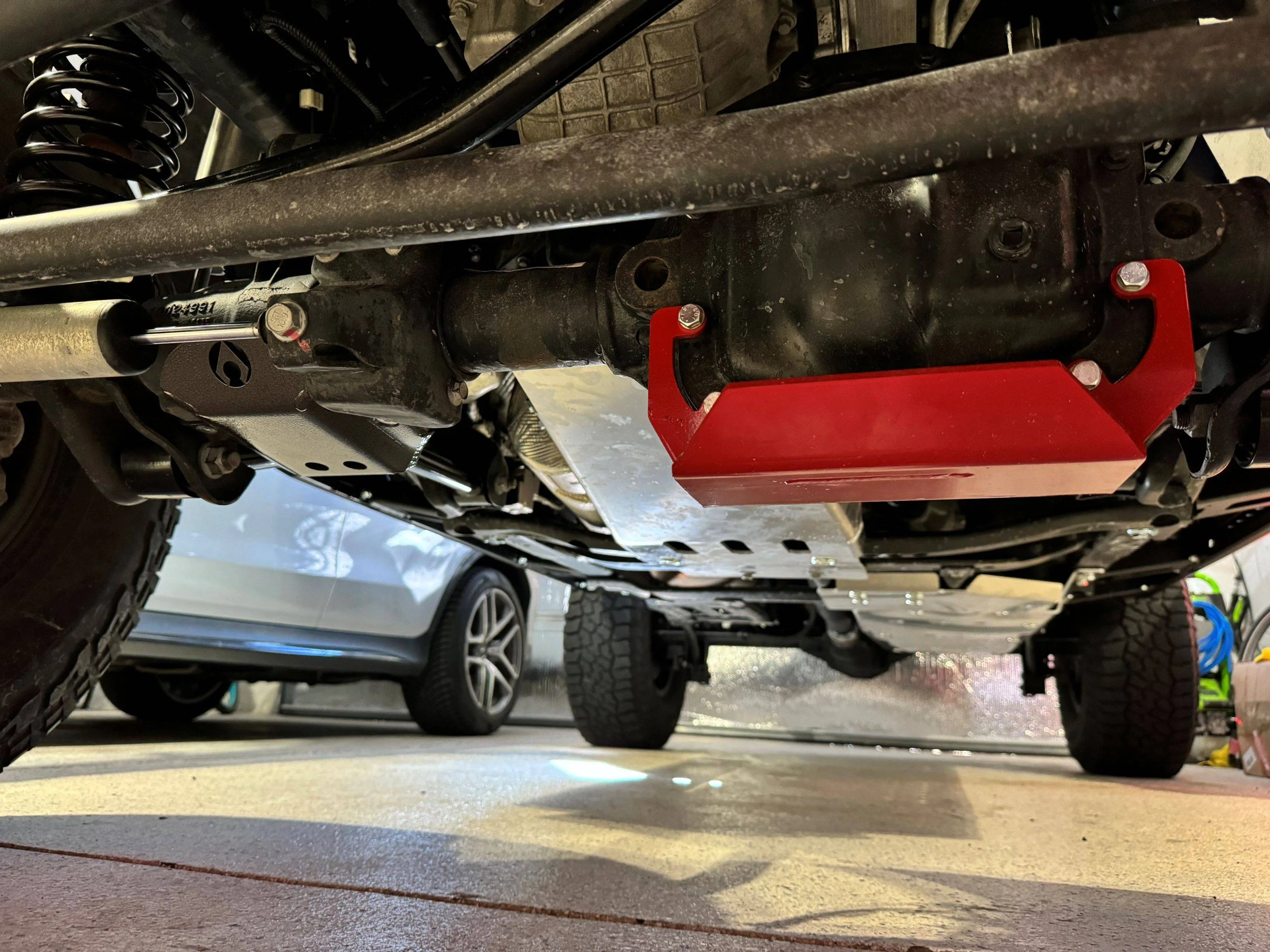

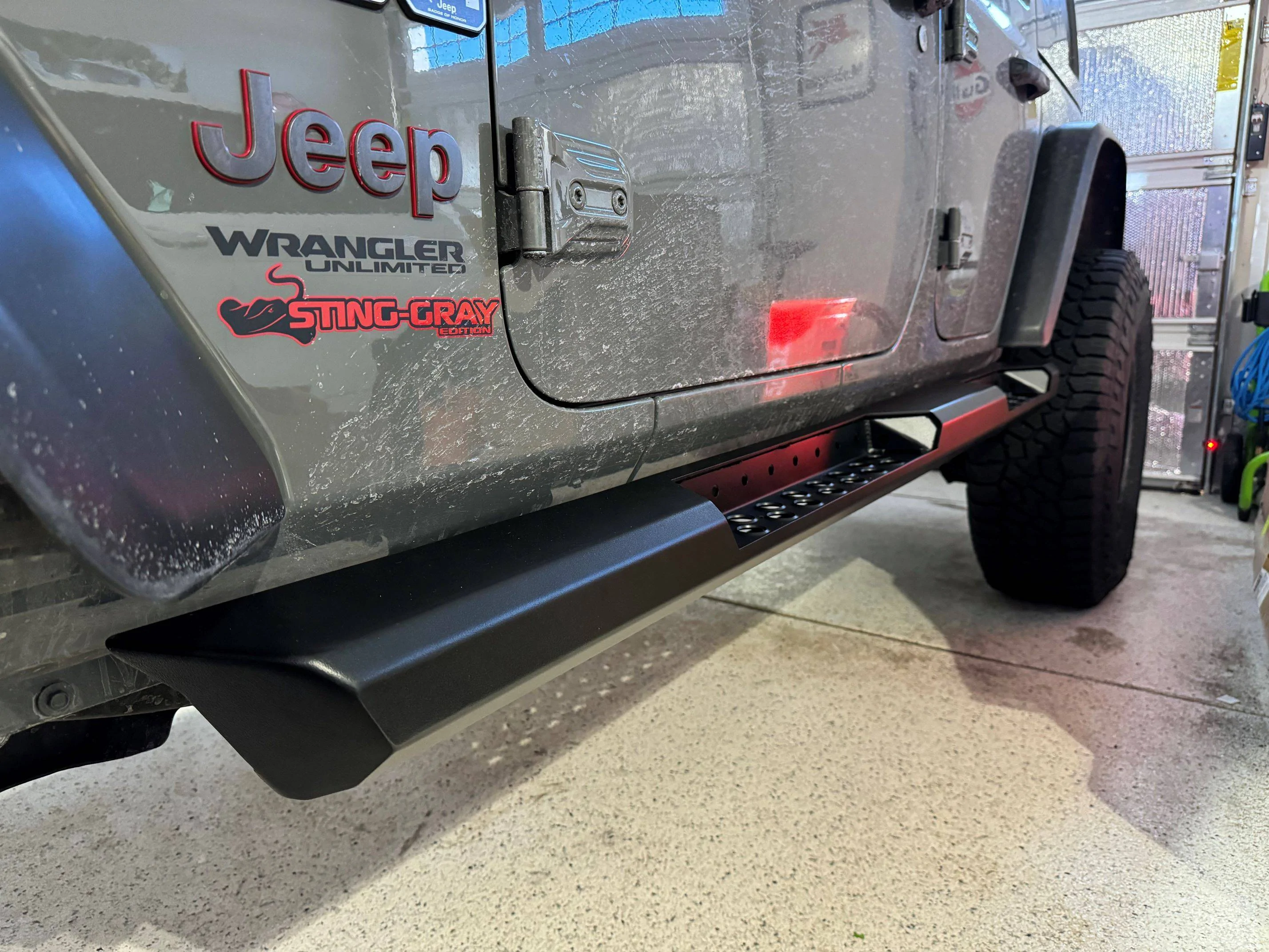

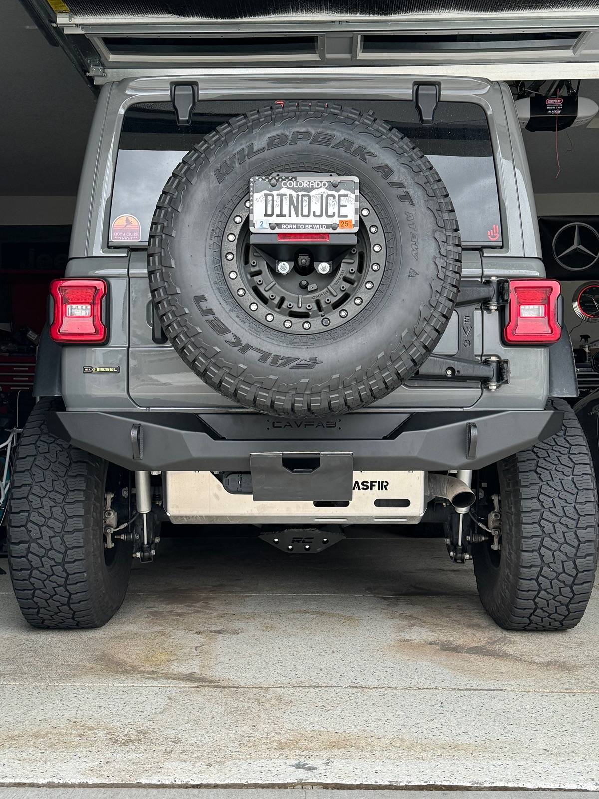

Armor: āœ…
Jeep Wrangler JL Destroyer: The '21 JLUR EcoDiesel IMG_4229
Jeep Wrangler JL Destroyer: The '21 JLUR EcoDiesel IMG_4228
Jeep Wrangler JL Destroyer: The '21 JLUR EcoDiesel IMG_4230
Jeep Wrangler JL Destroyer: The '21 JLUR EcoDiesel IMG_4231
Jeep Wrangler JL Destroyer: The '21 JLUR EcoDiesel IMG_4232

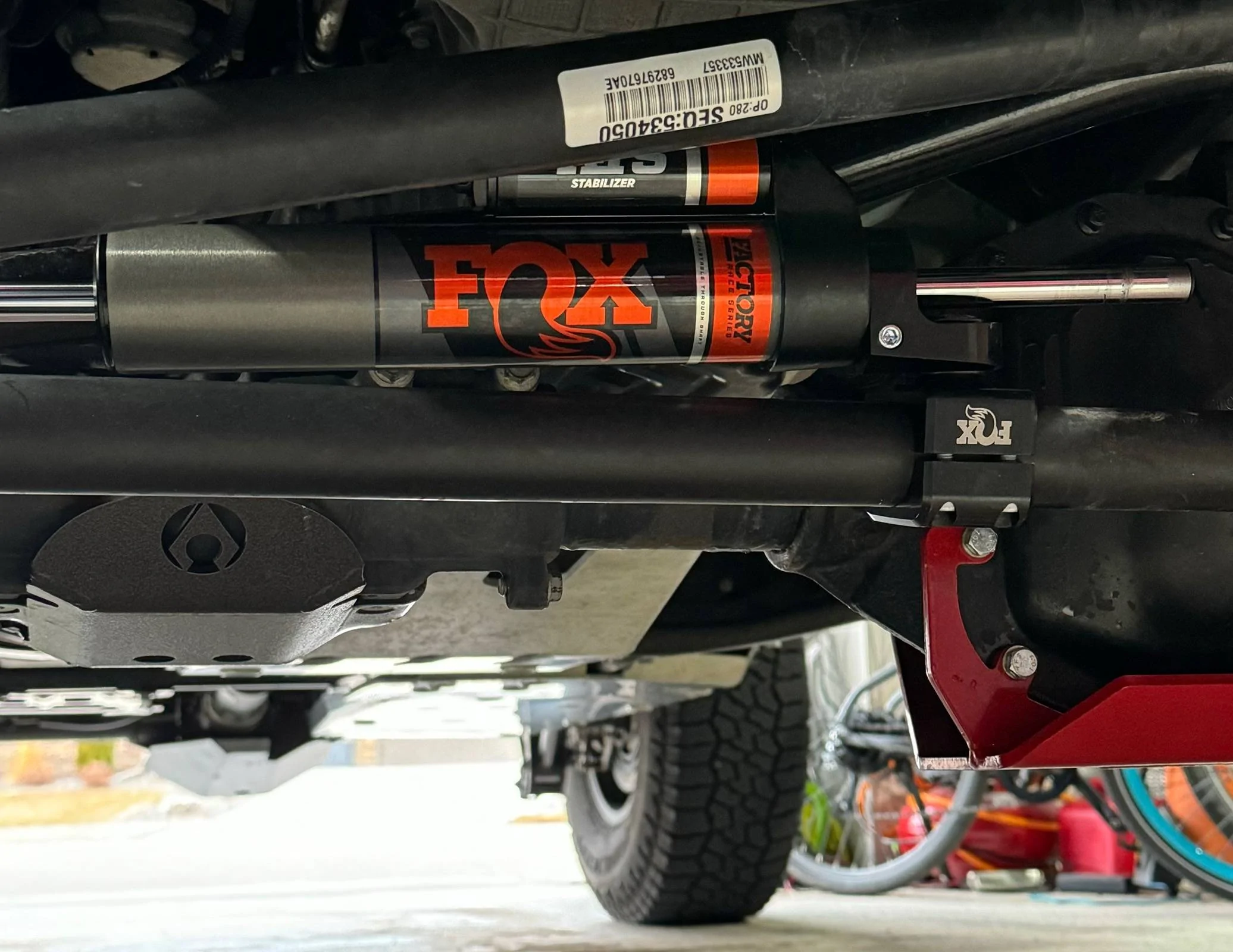

Stabilizer: āœ…
Armor: Complete
Jeep Wrangler JL Destroyer: The '21 JLUR EcoDiesel IMG_4332
Jeep Wrangler JL Destroyer: The '21 JLUR EcoDiesel IMG_4331

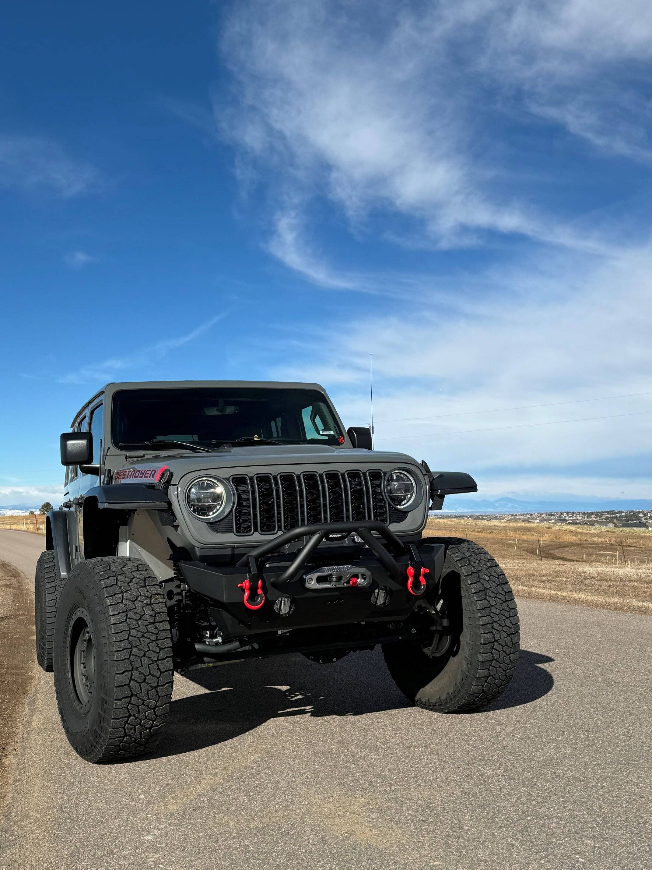

I have returned from EJS ā€˜24 and so has Destroyer…in ONE PIECE. Not a single fault or failure on its ā€˜maiden voyage’ / first shakedown off road trip.

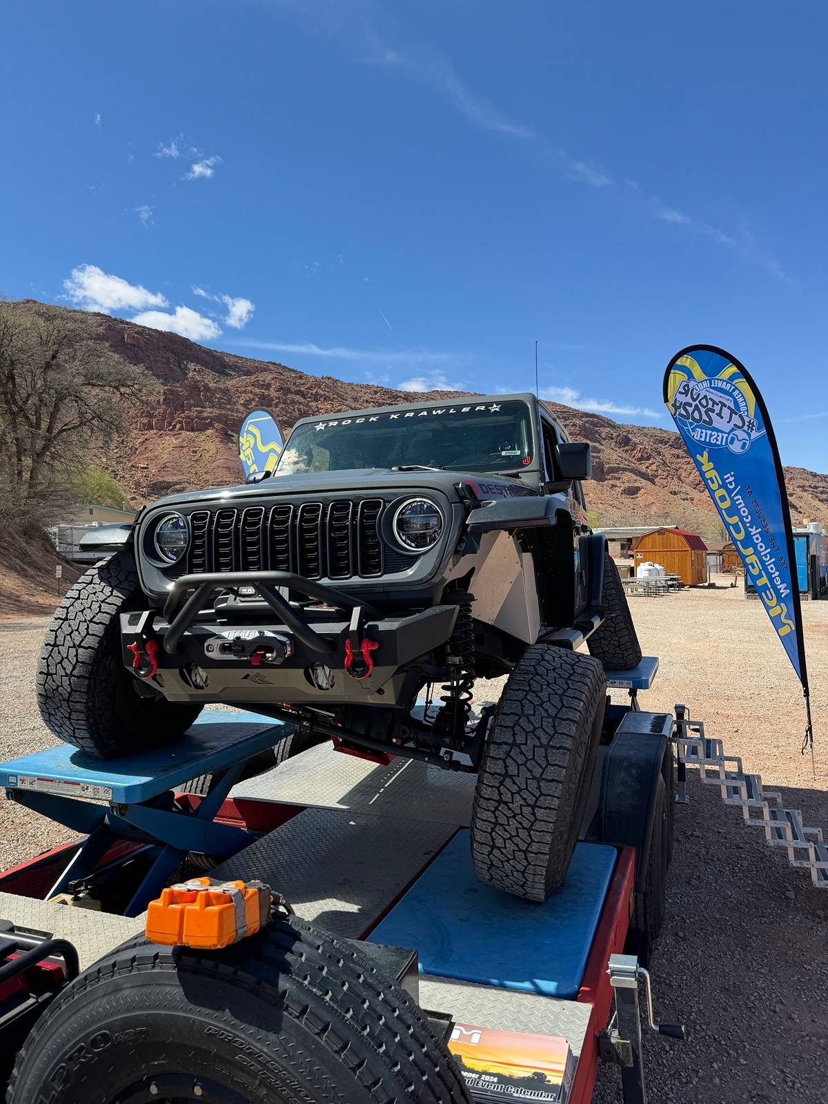

So, what exactly did I learn other than EJS is an absolute blast? Well for starters, my rig is definitely in need of some minor alterations to capitalize on available articulation space.
After taking on Metal Masher and Steel Bender (for my first time ever seeing these trails let alone in this rig) and coming out virtually unscathed (sans some scrapes in the armor, as expected), I decided to take a down day to not only recharge and explore the various EJS booths/vendors (including Jeep’s concept area). The bigger goal here though was to visit Metalcloak’s CTI trailer and see what fixes I need to make.
Jeep Wrangler JL Destroyer: The '21 JLUR EcoDiesel IMG_4481
Jeep Wrangler JL Destroyer: The '21 JLUR EcoDiesel IMG_4480

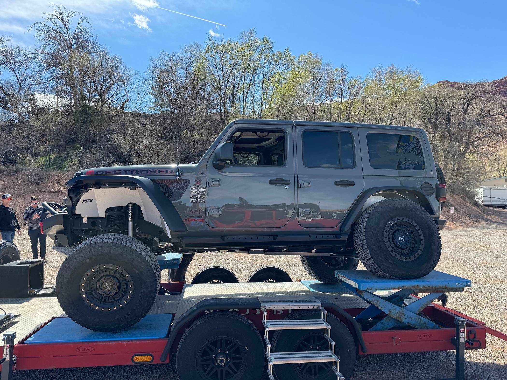

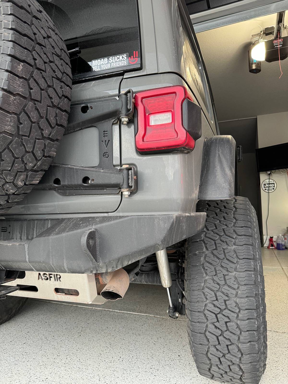

While it might not be so obvious from the front, it’s definitely obvious from the side that I’ve got a TON of space left to fill before I’m even close to stuffing into the fenders. This was area one that needed to be addressed front and rear. Removal of about 1ā€ of bump stop up front and nearly 2ā€ of bump stop in the rear (I’m gonna start at dropping them both by 1ā€ and incrementally reduce from there).
The other issue was glaringly obvious and something I should’ve known would be a problem based on what @Roky ran into a while back with his setup. The damn front shocks were contacting the frame and bowing the shaft at full droop. Clearly outboard brackets need to be installed to correct this (which I’ve already ordered Metalcloak’s NEW outboard bracket design to fix this).
One thing that wasn’t so obvious until the guy pointed it out to me was my rear diff cover making contact with my fuel tank skid at full flex limiting my uptravel on the left corner. Very easy fix, just need to use my cutting wheel and take some material off the diff skid to make some room or just ditch it entirely for a better designed skid. Finally the sway bar in the rear needs some light grinding of material to eliminate contact into other components. Again, another easy fix, not really a huge deal.
Beyond that he made the obvious recommendation to ditch the electronic sway bar up front since it’s also preventing about another 2ā€ of up travel that’s available without it. Until it inevitably fails, I’m not super concerned with it. Remember, I just made it through Metal Masher and Steel Bender without any issue, so in my mind I’m already exactly where I wanna be in terms of capability. Going beyond this for the sake of extra articulation just seems like a waste until I decide to take on more difficult terrain.
So, what was its score? Well…
Jeep Wrangler JL Destroyer: The '21 JLUR EcoDiesel IMG_4482
Not great, not terrible. There’s definitely room for improvement, but given my limited ability to really test my suspensions capability in my garage I’d say it’s pretty damn decent. Once I make the adjustments they advised and maybe some other alterations, I’ll have to get it back on their trailer when they’re out this way and see how much of an improvement was made.

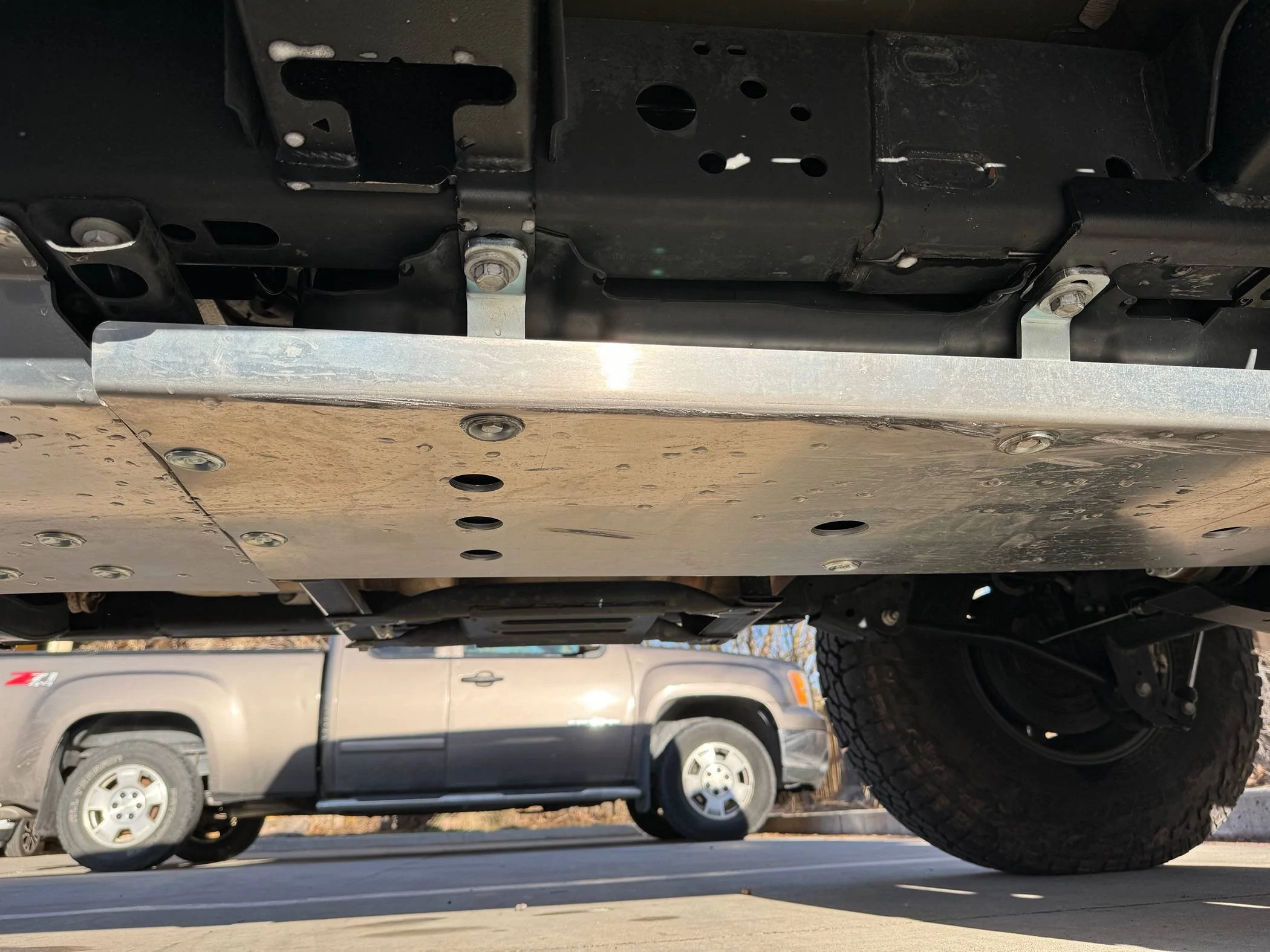

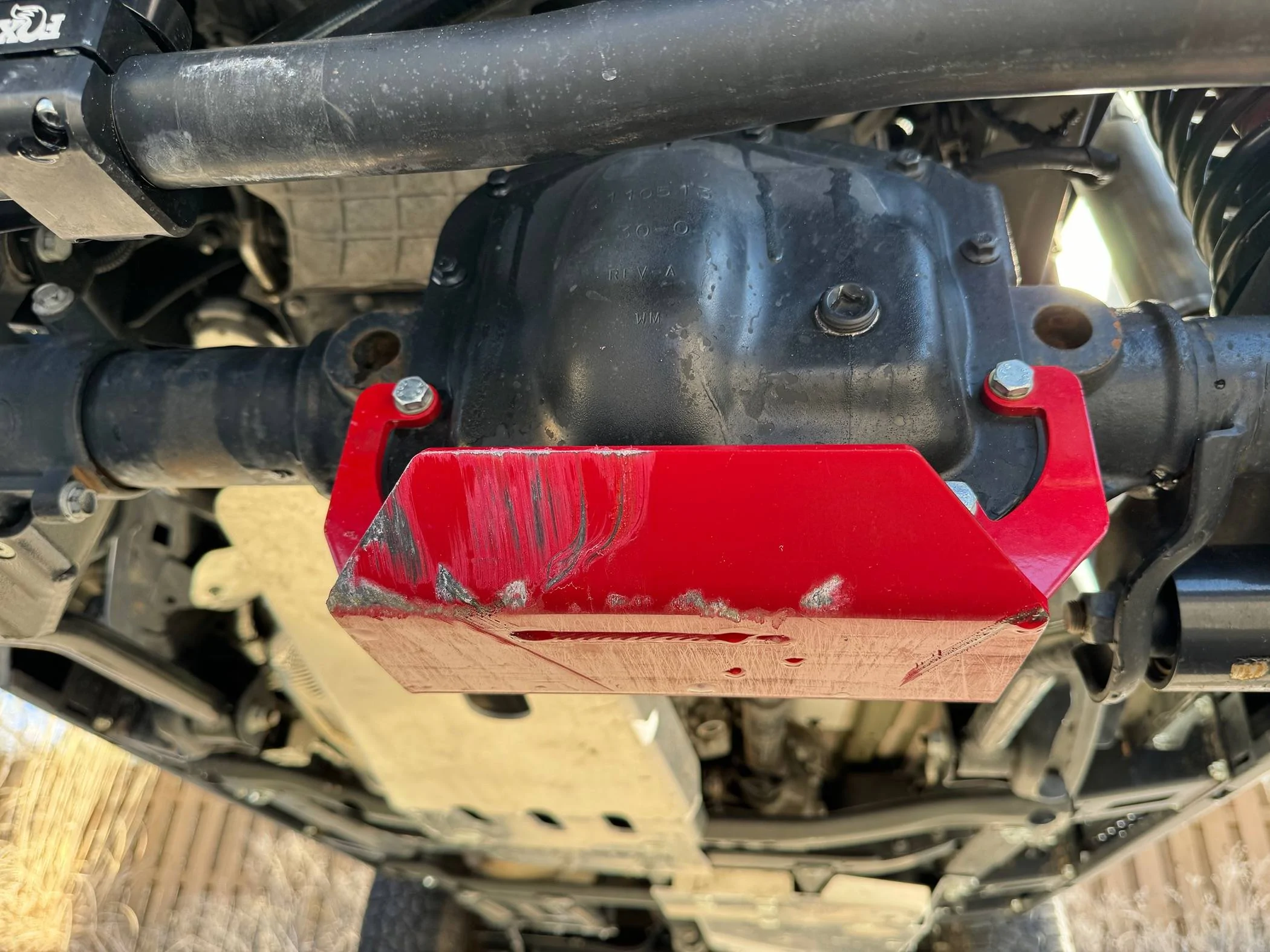

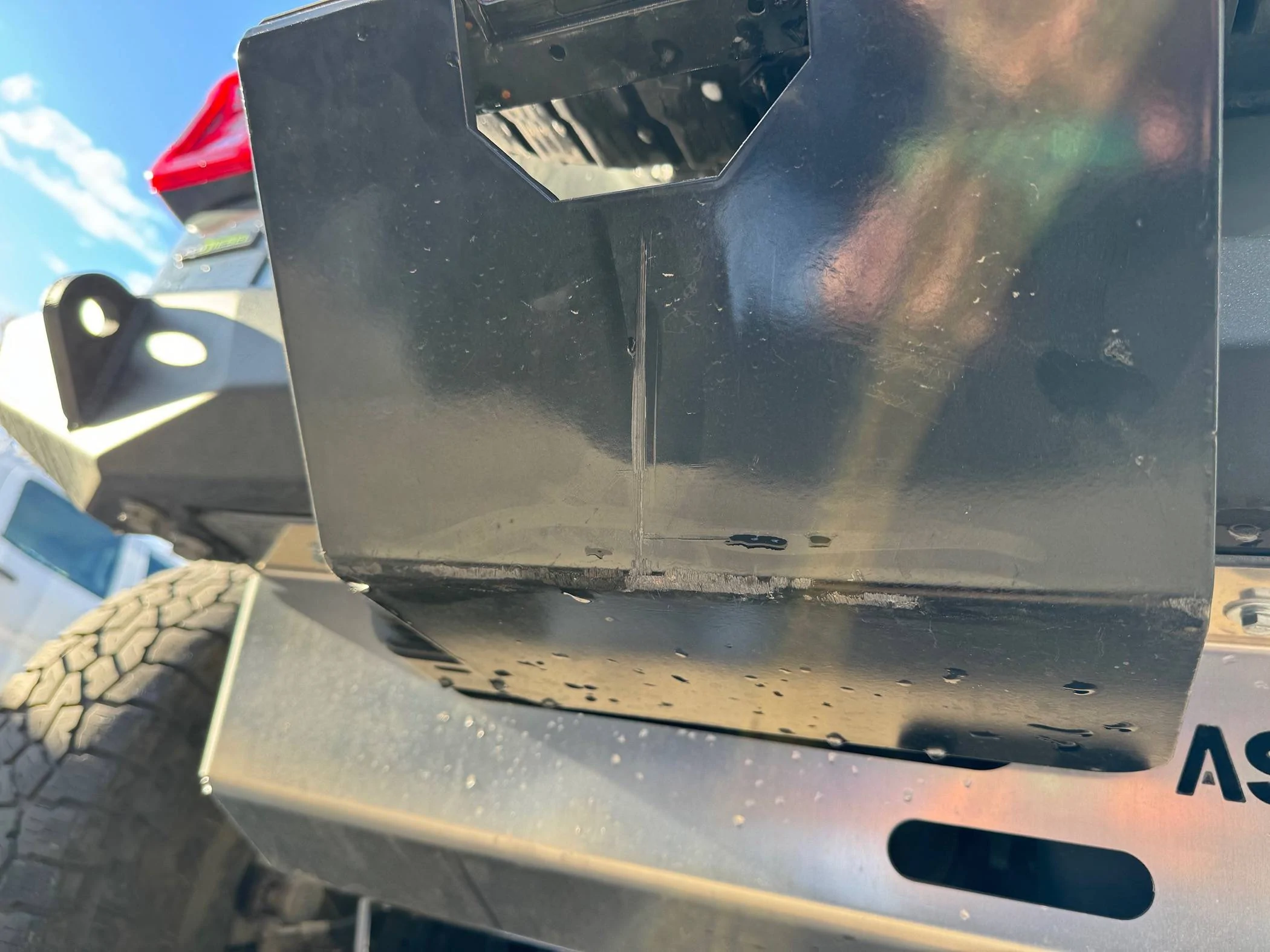

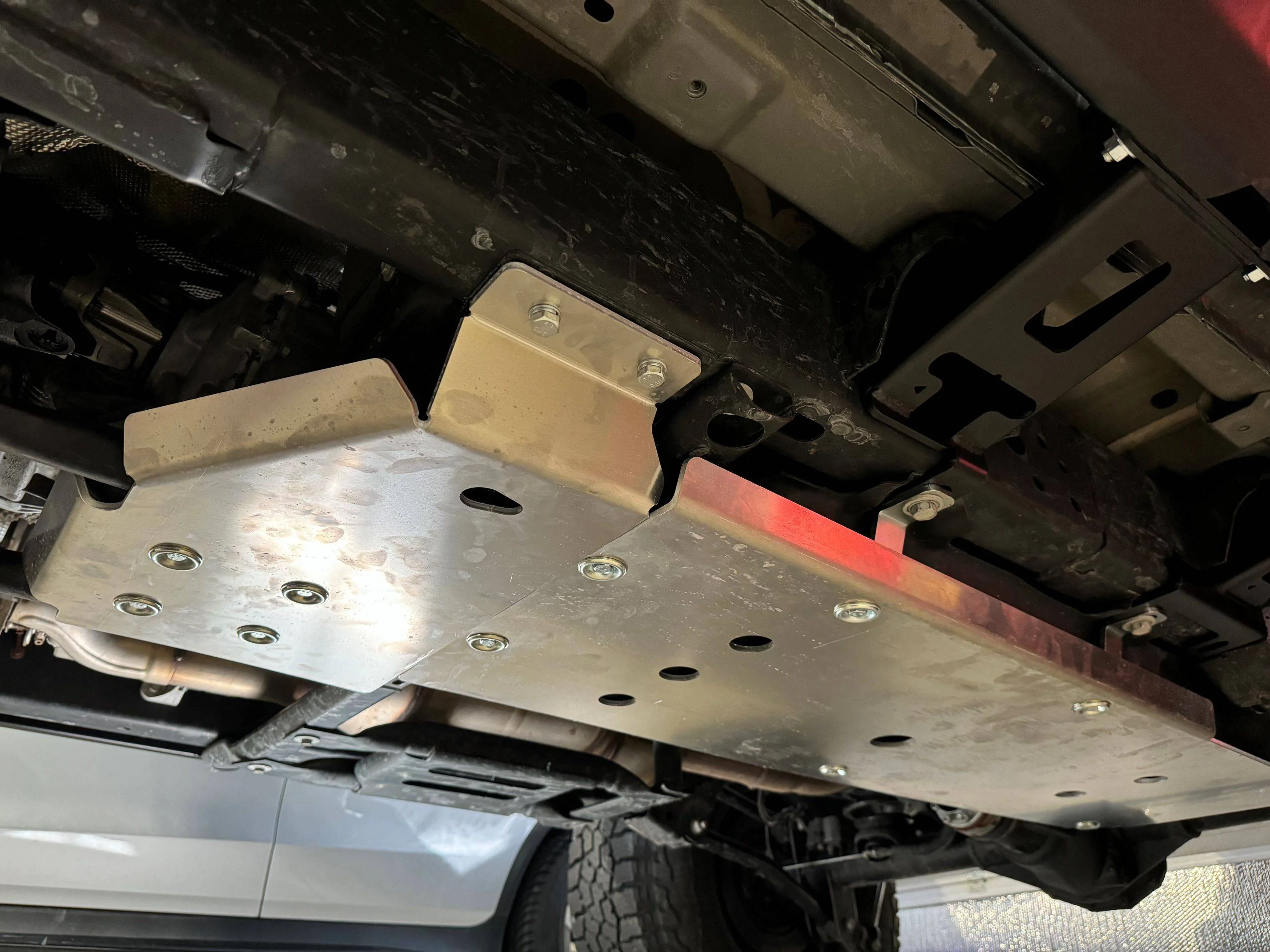

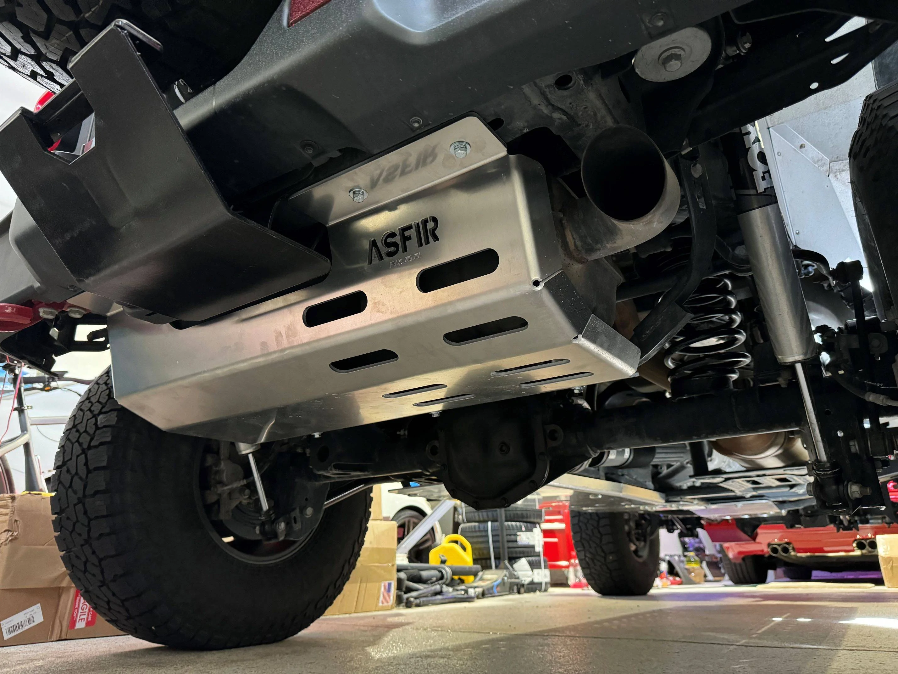

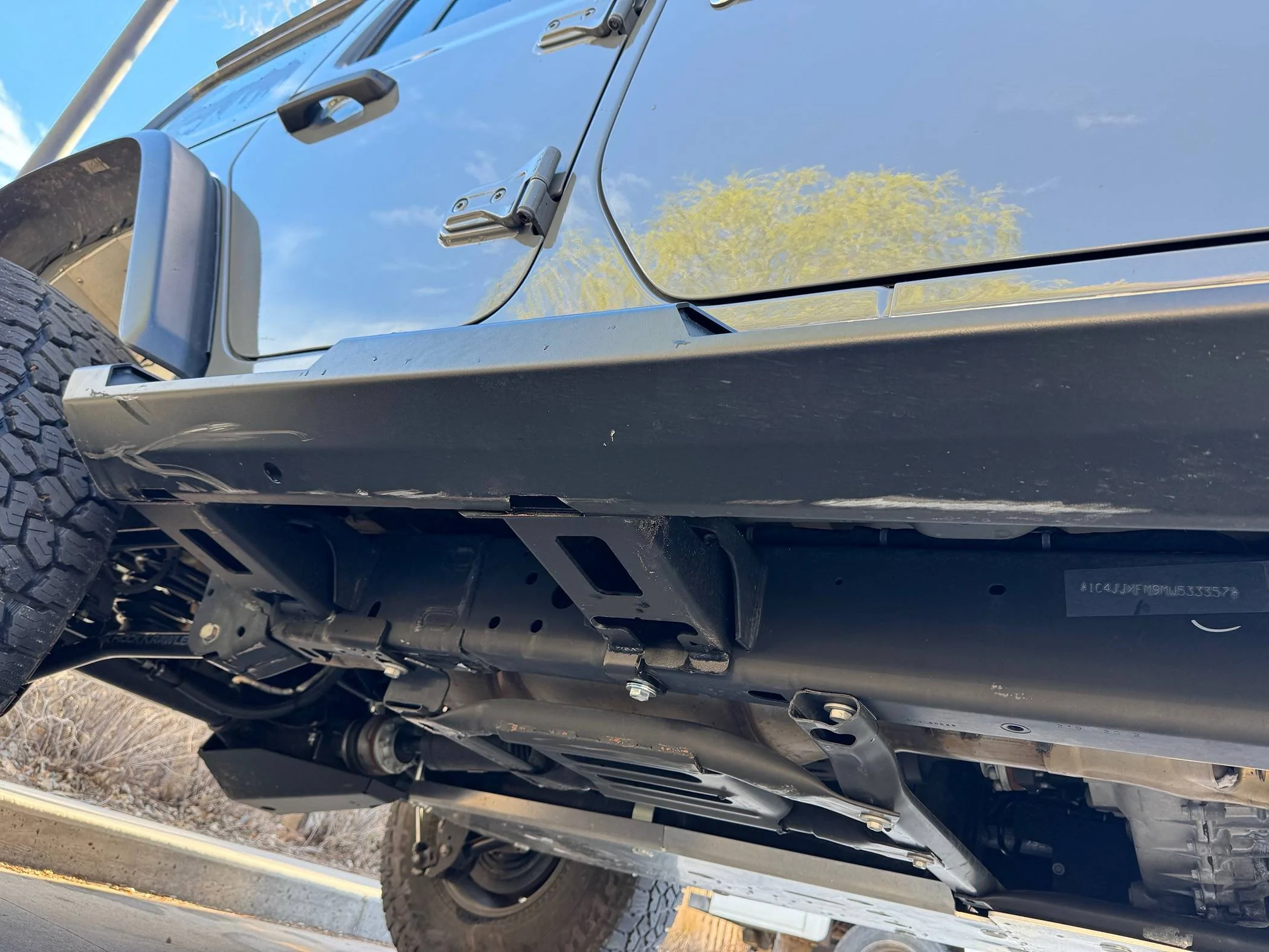

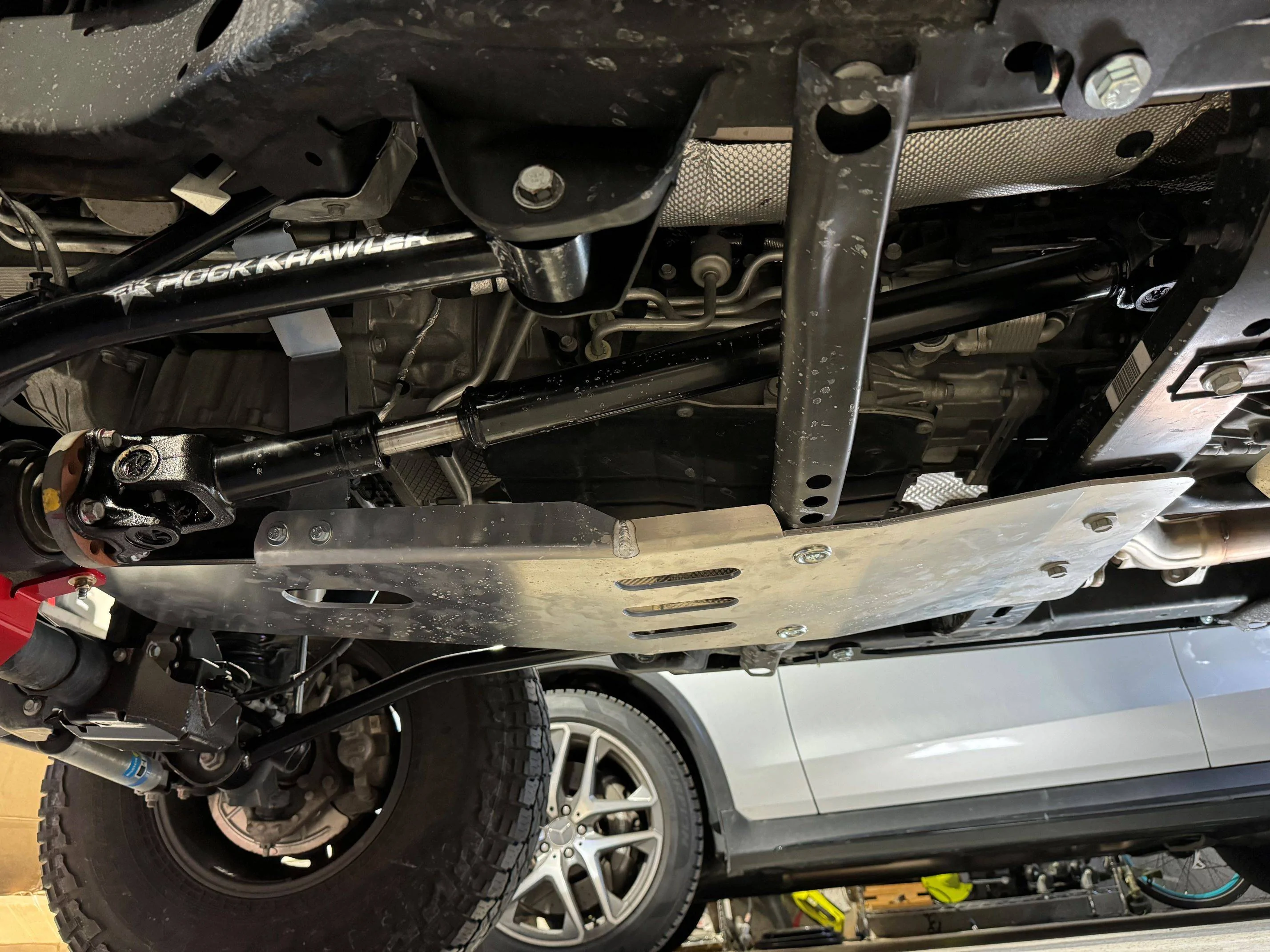

As far as how the armor did, here’s the battle damage assessment:
Jeep Wrangler JL Destroyer: The '21 JLUR EcoDiesel IMG_4426
Jeep Wrangler JL Destroyer: The '21 JLUR EcoDiesel IMG_4428
Jeep Wrangler JL Destroyer: The '21 JLUR EcoDiesel IMG_4429
Jeep Wrangler JL Destroyer: The '21 JLUR EcoDiesel IMG_4430
Jeep Wrangler JL Destroyer: The '21 JLUR EcoDiesel IMG_4432
Jeep Wrangler JL Destroyer: The '21 JLUR EcoDiesel IMG_4433
Jeep Wrangler JL Destroyer: The '21 JLUR EcoDiesel IMG_4528
Things to note:

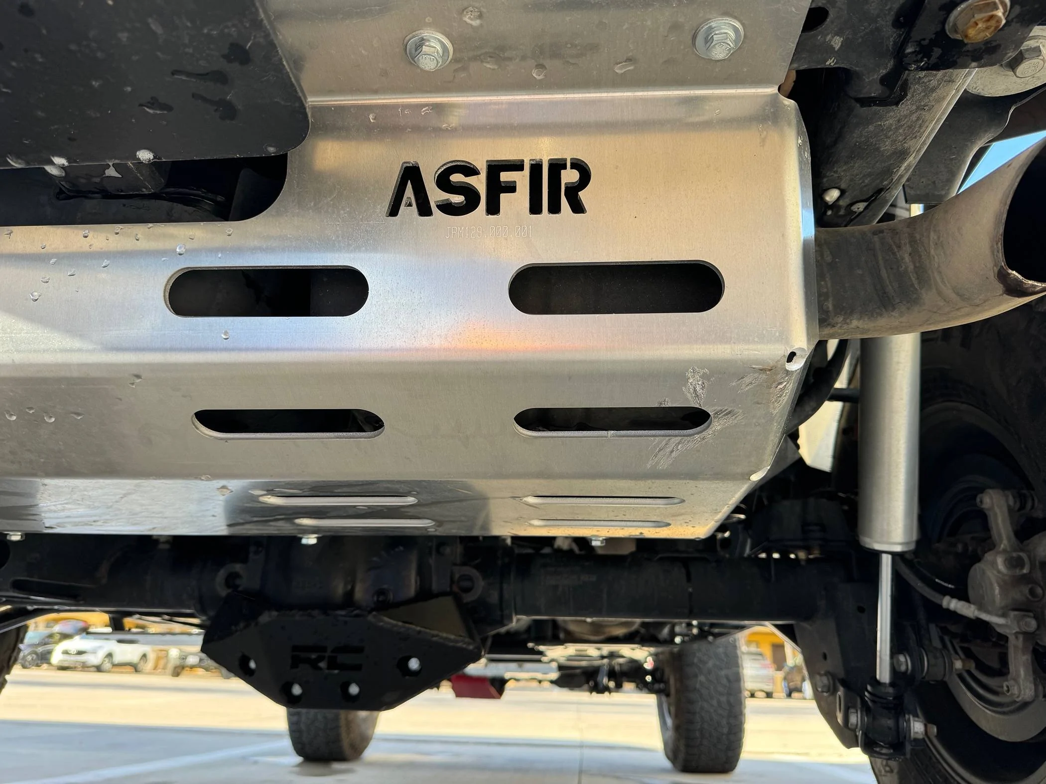

- Rancho’s front diff skid took an absolute beating this trip and didn’t crack, bend, or buckle at all. Just superficial paint scuffs. Top marks here to Rancho.
- Asfir gas tank skid and DEF tank skid held up extremely well. For as cheap as it is and being just basic 5052 aluminum, I was very impressed. Another diesel in my group on steel bender managed to bend one of his rear mounts of his Metalcloak def tank skid. Not sure how, but definitely made me think twice about Metalcloak’s armor.
- The cheap tow hitch skid I bought off amazon was a damn trooper on this trip. I smacked the ever loving hell out of it at least 3-4 times coming off of ledges and it held up strong the whole time keeping my tire safe from getting snagged. 100% recommend this to everyone. Such a great little addition that saved my ass literally.
- LOD Destroyer step rails took some pretty good bangs but didn’t bend or buckle into my body at all. Very stout construction here and absolutely worth the investment.
- I earned the signature bent up tail pipe on this trip (most likely descending the left side of Dragons Tail on Steel Bender). I consider this a mark of honor and will leave it as is until it becomes a problem. ?

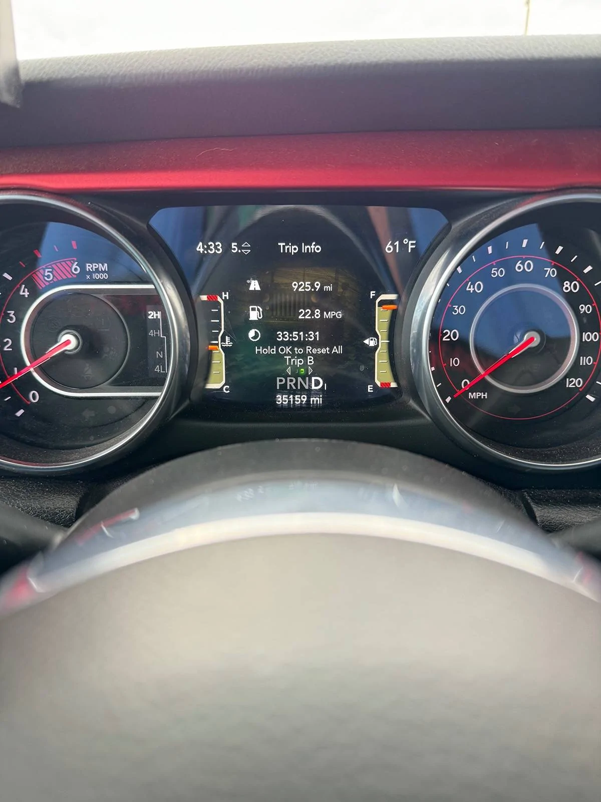

And finally, the mileage/fuel report. Keep in mind this is after being in 4L on 3 trails (Metal Masher, Steel Bender, and Seven Mile Rim) trucking over I-70 twice through Eisenhower tunnel and Vail Pass with 37’s and all of my tools, recovery gear and various other bags of stuff for the trip:
Jeep Wrangler JL Destroyer: The '21 JLUR EcoDiesel IMG_4538
If I hadn’t been stuck in stop and go traffic on the way back from Georgetown all the way down to basically Morrison, I imagine my average mpg would’ve been even better.

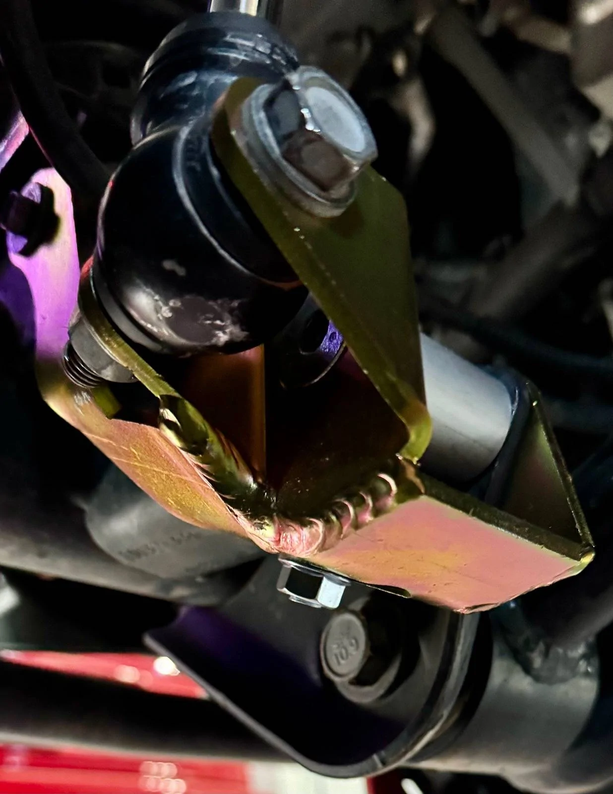

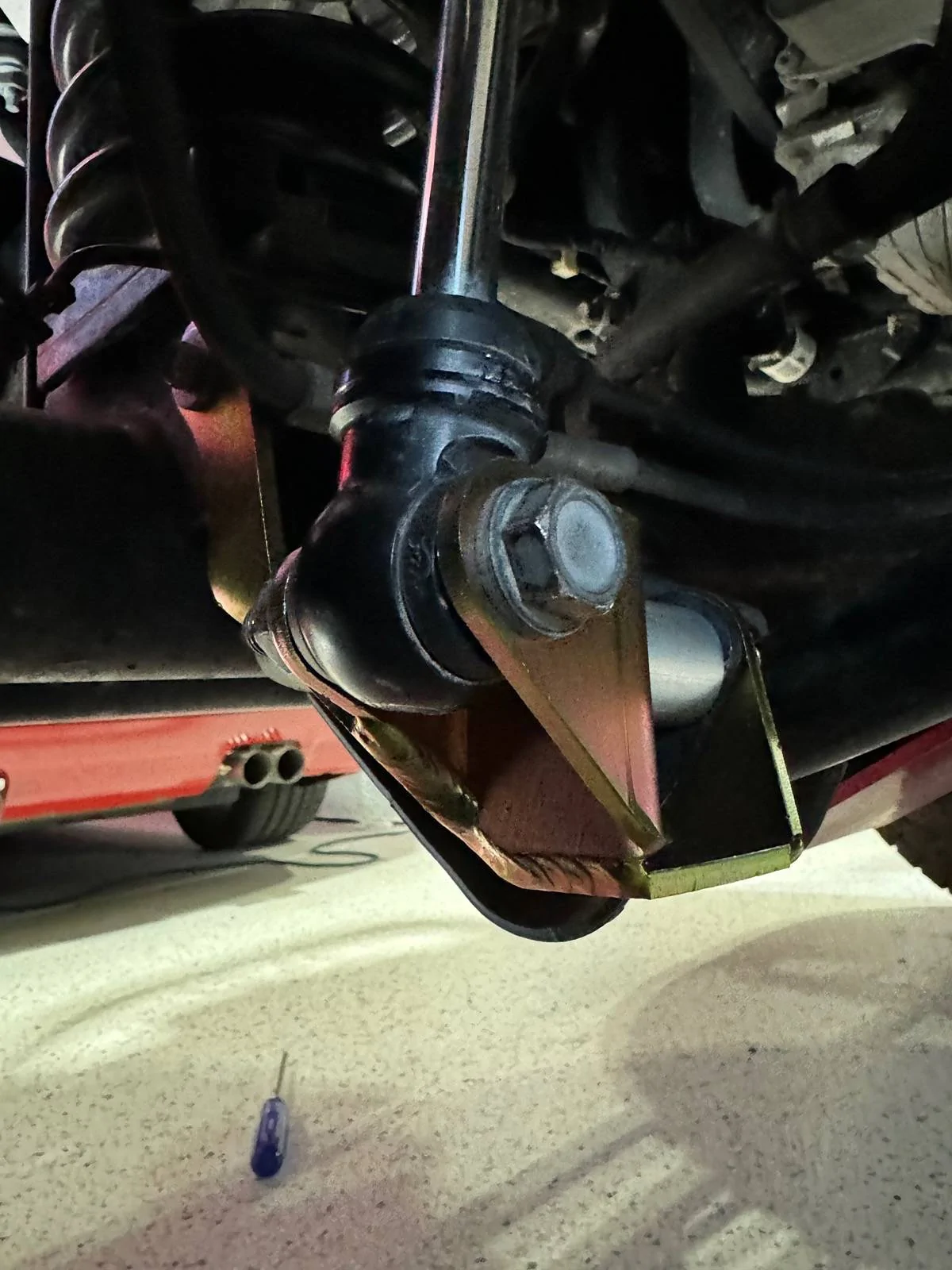

So I got the new Metalcloak relocation brackets installed. These damn things are so new the only place to find the correct install guide is through the rocksport black shocks. Apparently they’re designed specifically for them whereas the originals are meant for fox and rocksport red (as far as I can tell anyway).
Jeep Wrangler JL Destroyer: The '21 JLUR EcoDiesel IMG_4610
Jeep Wrangler JL Destroyer: The '21 JLUR EcoDiesel IMG_4611
Jeep Wrangler JL Destroyer: The '21 JLUR EcoDiesel IMG_4612
So a couple of notes on these:
- There’s no torque specs for install posted ANYWHERE. Use your best judgement and send it. I torqued the shock mount itself to factory spec and the rest of Metalcloak’s hardware to G’NT.
- The front post relies on your existing brake line bracket under the spring pad to still be there as it reuses the 10mm bolt for security. If your setup has moved on to something like the Teraflex mounts, you might wanna source your own hardware to ensure it doesn’t go anywhere.
- The primary bolt/sleeve that attaches the new bracket to the existing axle bracket uses a new hex head style bolt that tightens up to a countersunk hole. This is a much cleaner design that I remember the original relocation bracket being and ensures there’s no possibility of the shock eye hitting it.
- This might be a me problem but the included grade 8 bolt and nut that’s meant to secure the shock eye to the bracket is just too damn big for the Fox IFP’s I’m using. Save your stock hardware just in case you run into the same problem. It works just fine here.
The big advantage this bracket has over the existing design is that it simply rotates the mounting point 90 degrees and outboard. The original also dropped the mount location about 1ā€-1.5ā€ which made you do some extra math to figure out which shocks were right for your planned up/down travel in the front. Kind of a pain in the ass if you ask me.
As far as I can tell though, these work just fine for my IFP’s. I can’t imagine anyone having issues with them on other shock brands/models either.
If I have any issues with them going forward I’ll be sure to share, but so far my frame contact issues at full flex are no longer a problem. ?

All that being said, the brackets have been a noticeable improvement on their own. The freedom of movement vs the standard mounting point has made something as trivial as a curb entering my driveway feel like it barely exists whereas before the whole cabin would get upset. Amazing how something so simple can make such a big difference.
