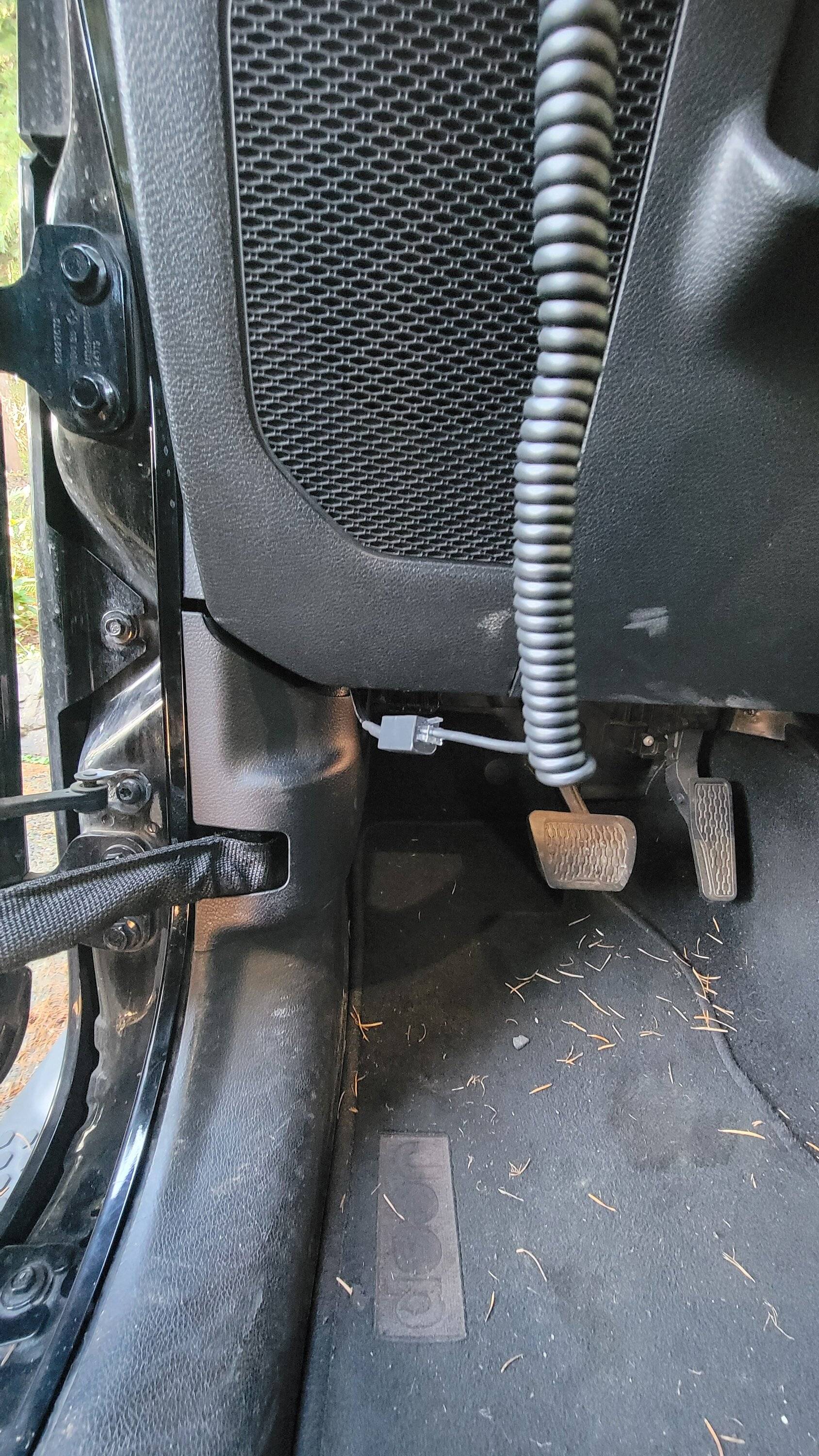

Microphone connection at the bottom of the steering covers, near the ODB2 port
Jeep Wrangler JL Install notes (and pictures!) for Yaesu FTM-500 dual-band ham radio 2023-12-26 11.41.56

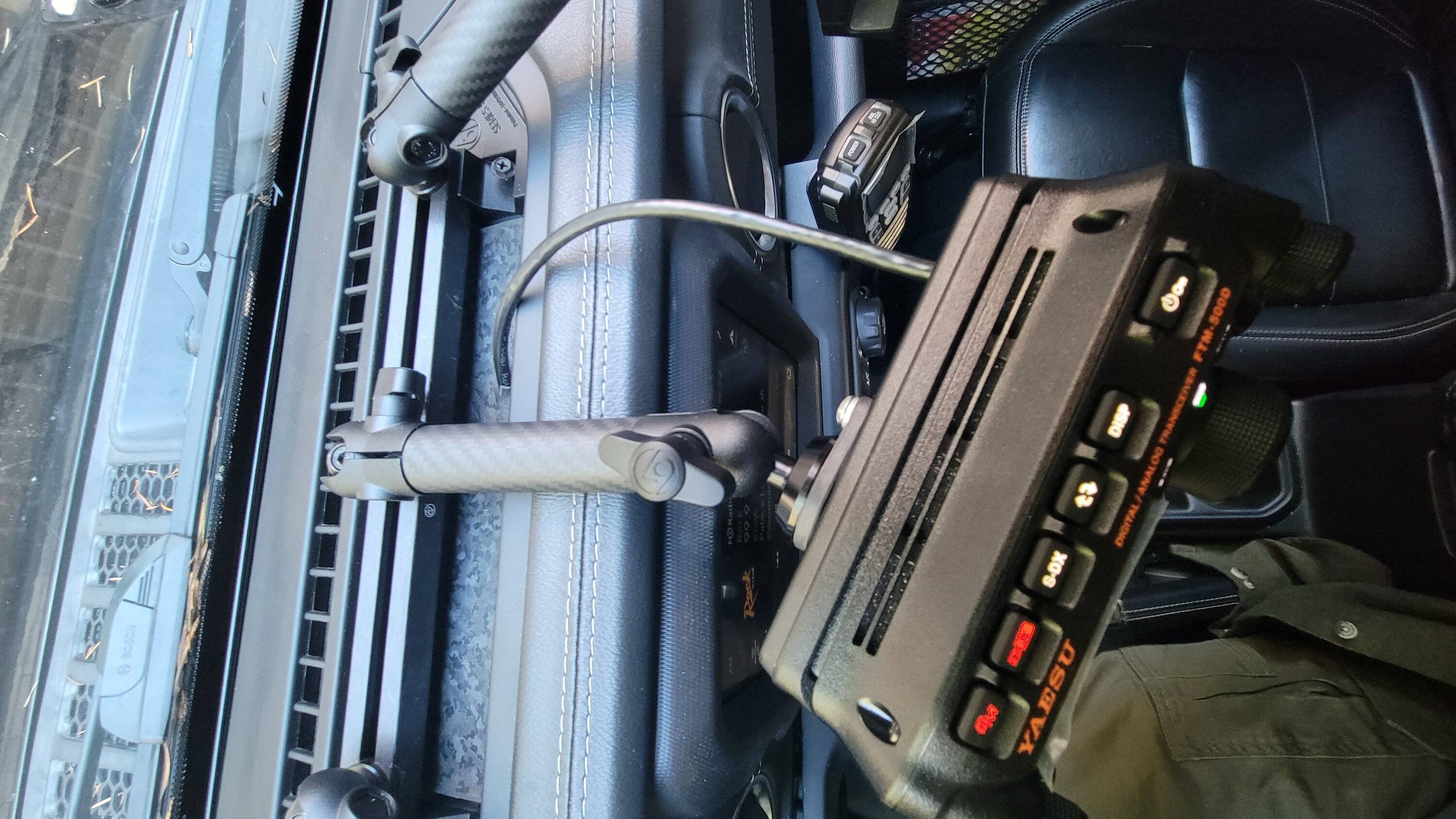

Looking at the duck pond down onto the radio.
Jeep Wrangler JL Install notes (and pictures!) for Yaesu FTM-500 dual-band ham radio 2023-12-26 11.43.47

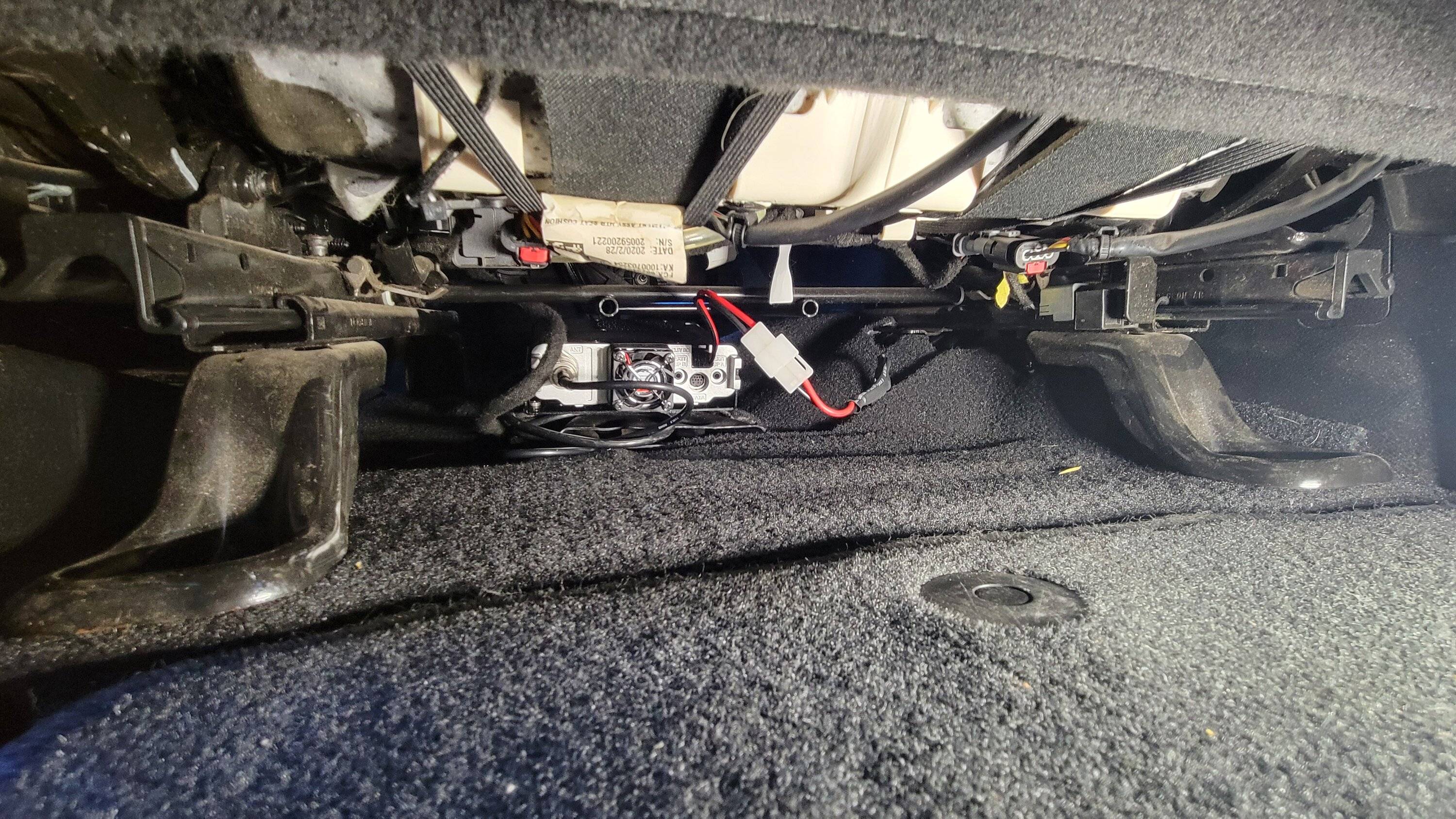

From the rear foot well looking forward under the driver's seat to see the radio
Jeep Wrangler JL Install notes (and pictures!) for Yaesu FTM-500 dual-band ham radio 2023-12-26 12.47.58

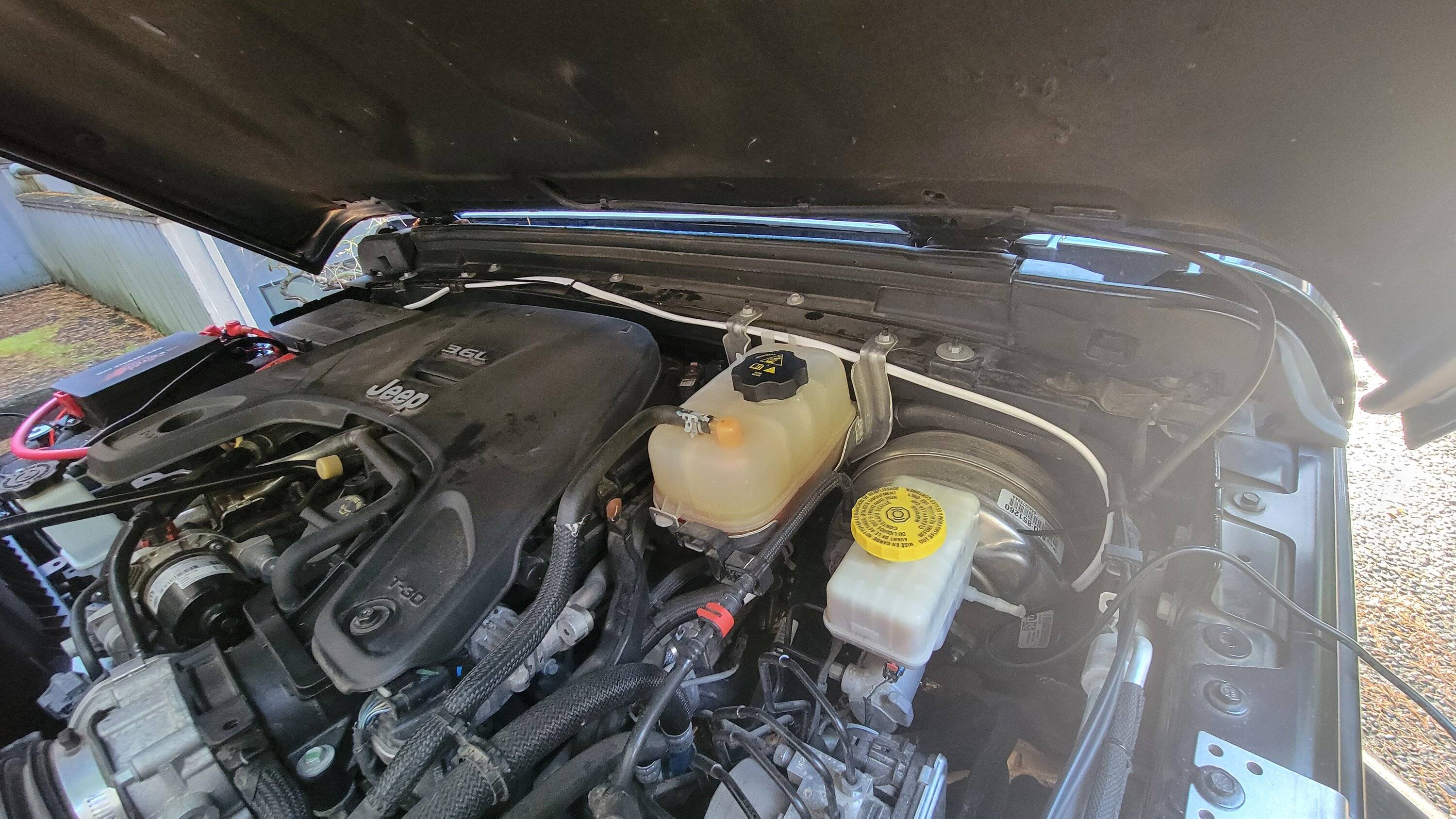

Marine-grade power cable along the top of the firewall.
Jeep Wrangler JL Install notes (and pictures!) for Yaesu FTM-500 dual-band ham radio 2023-12-26 11.46.15
