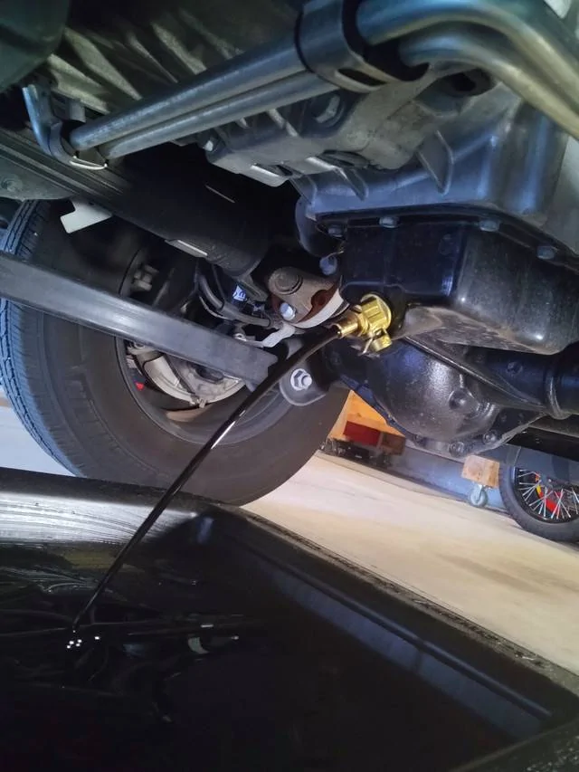

I’ve come to love the Fumoto Oil Drain valve and have used them on three vehicles now. It’s a bit slow to drain, but while it’s draining I get up and get my funnel ready, get my oil caps unscrewed, and change the filter and then it’s pretty much ready to close the valve and top if off.

I use and recommend the Fumoto oil drain valve. Note that your Wrangler's use case may compel the installation of a skid plate to protect the valve. This may in turn compel removing the skid plate at each oil change interval, unless it provides an accommodation to easily access the drain valve or drain plug.
