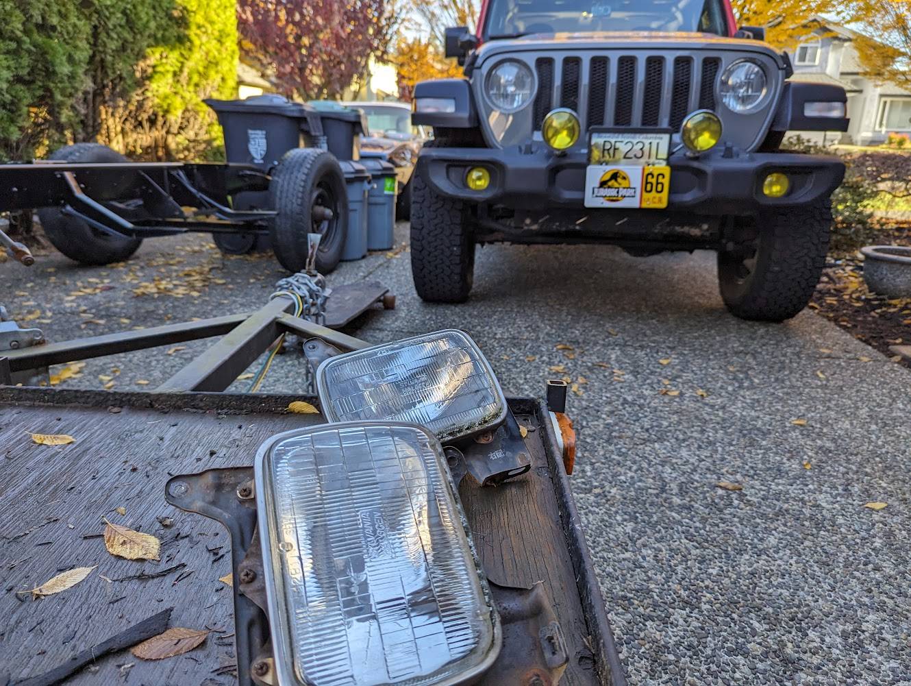

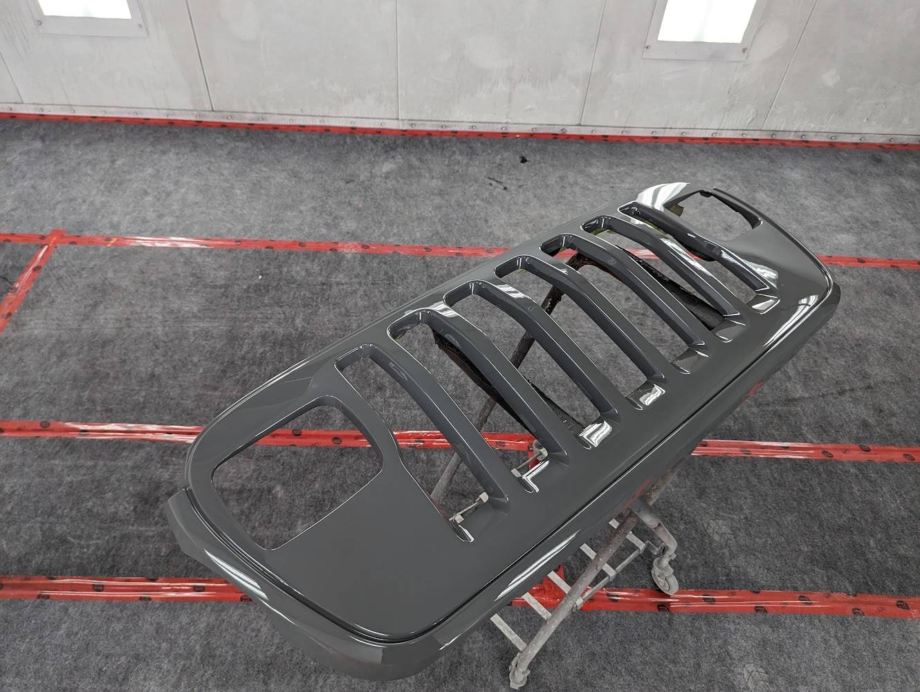

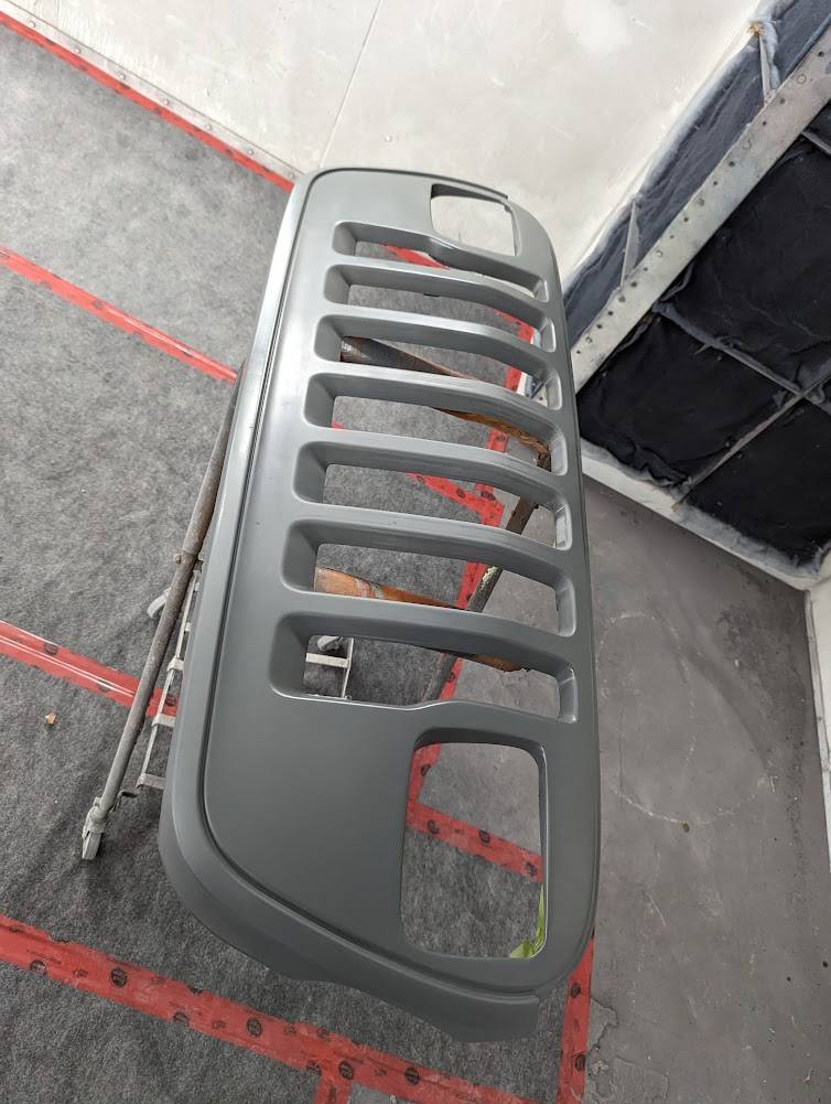

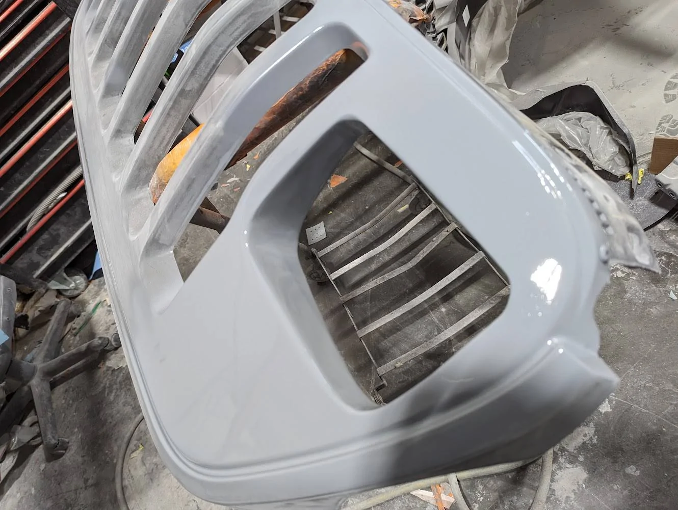

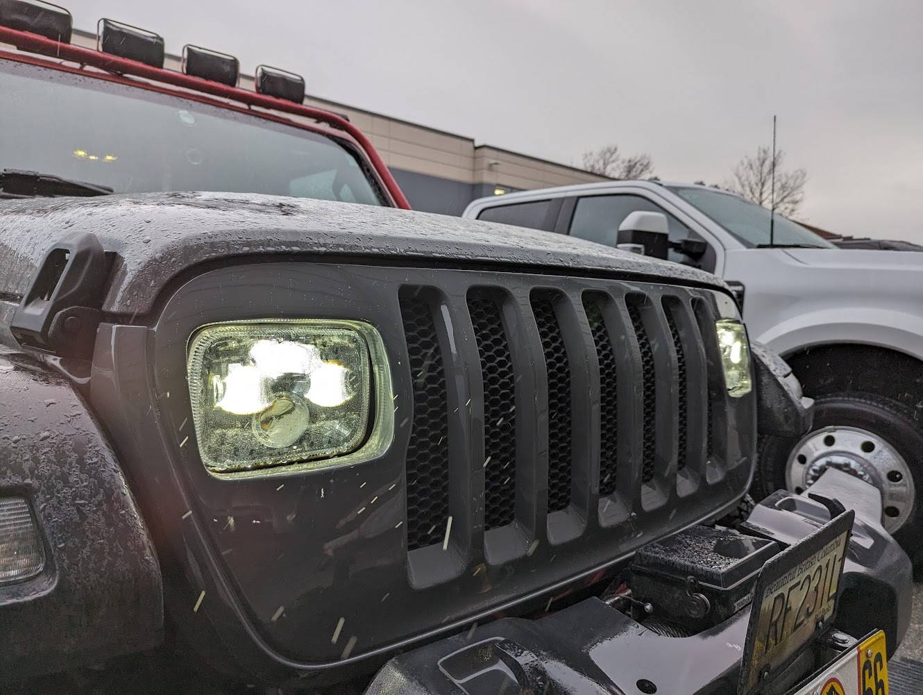

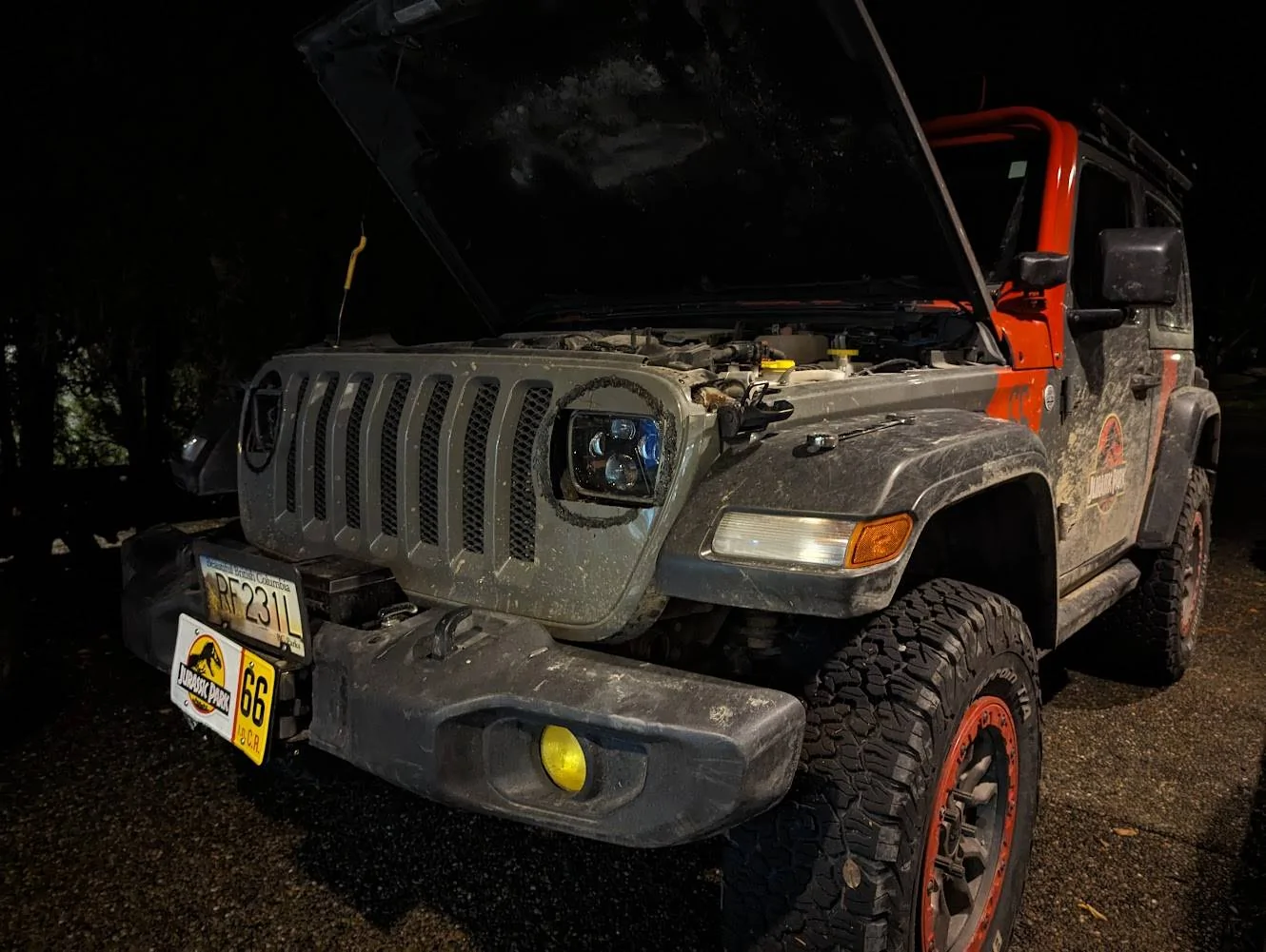

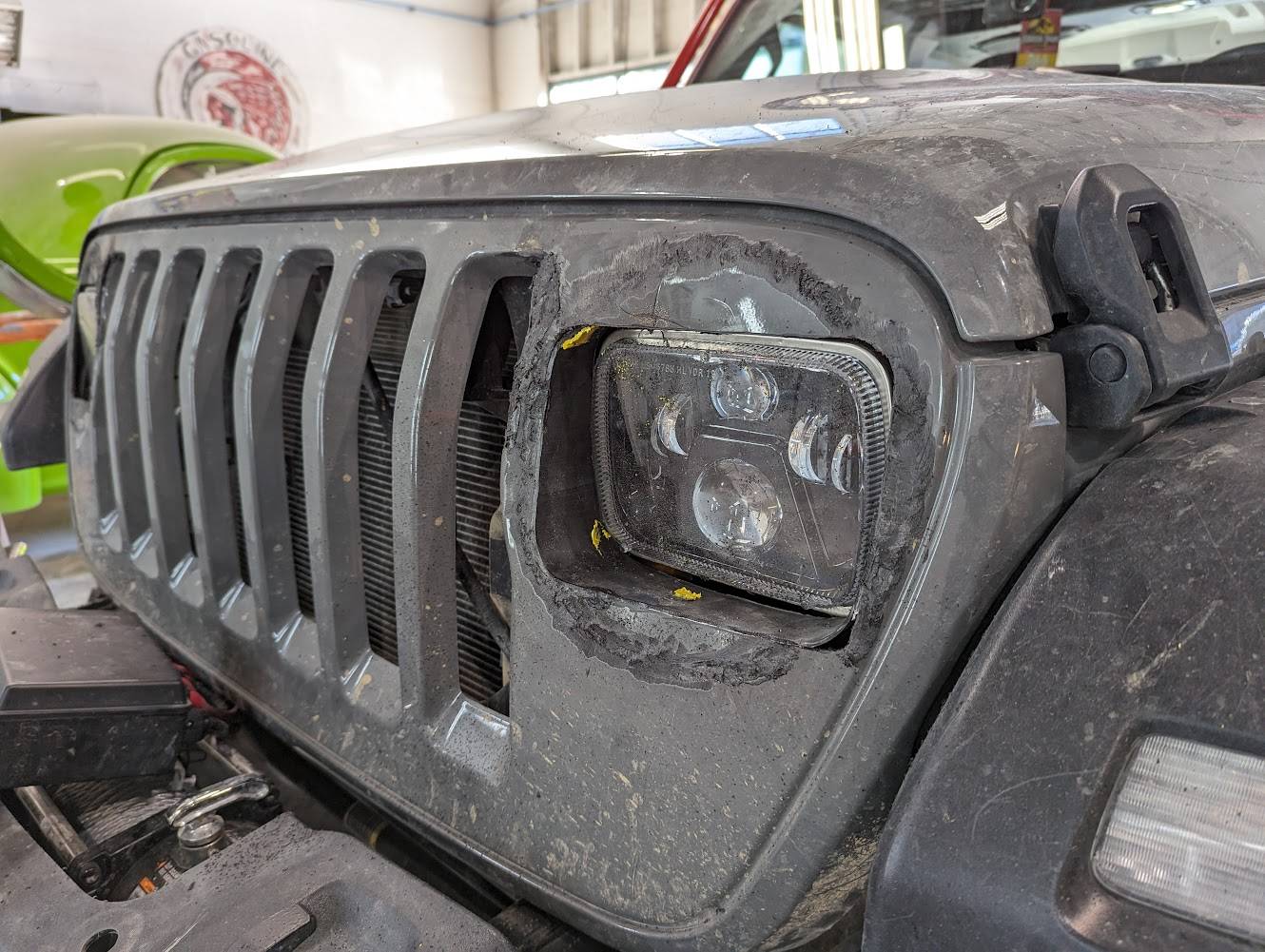

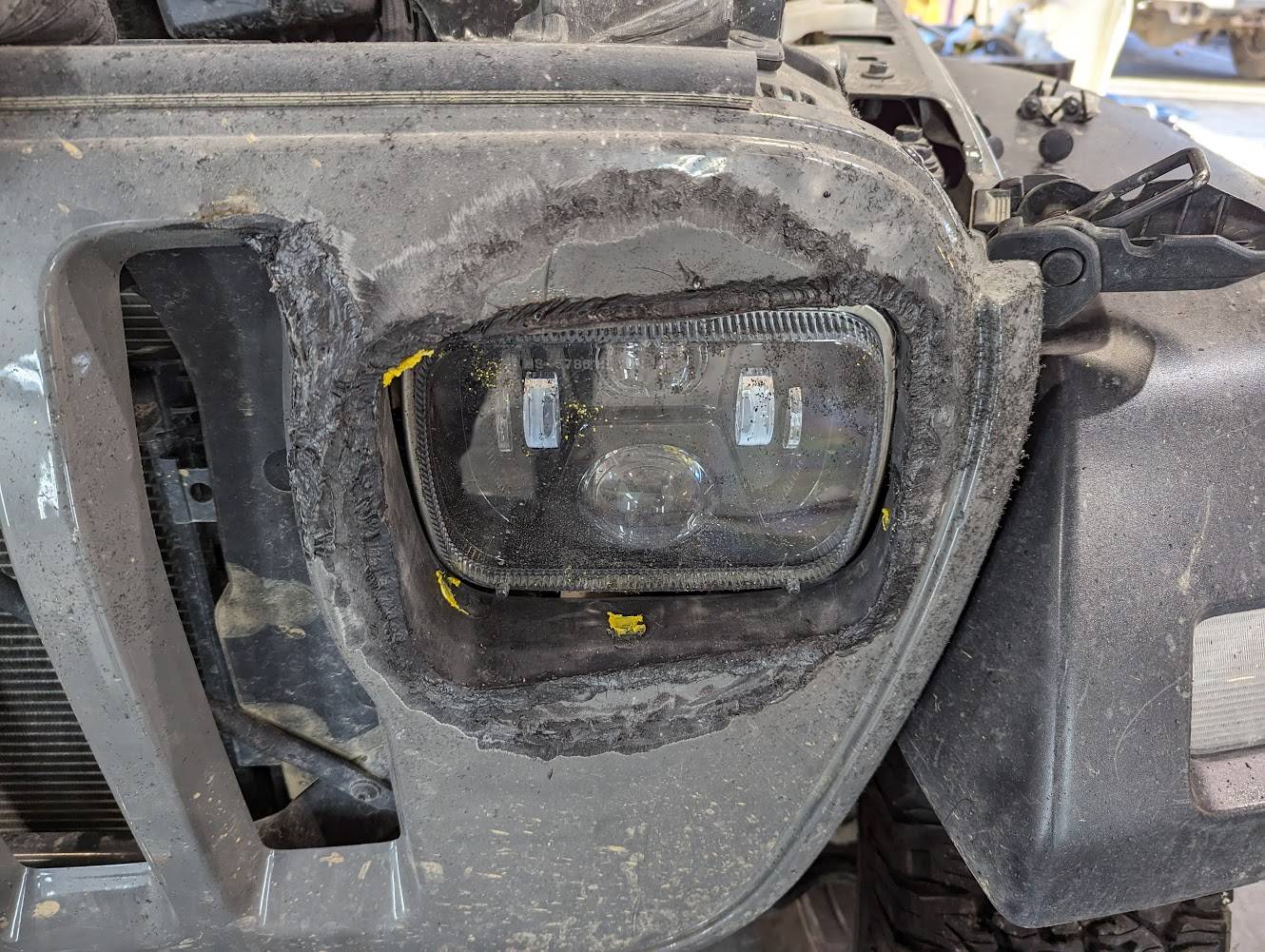

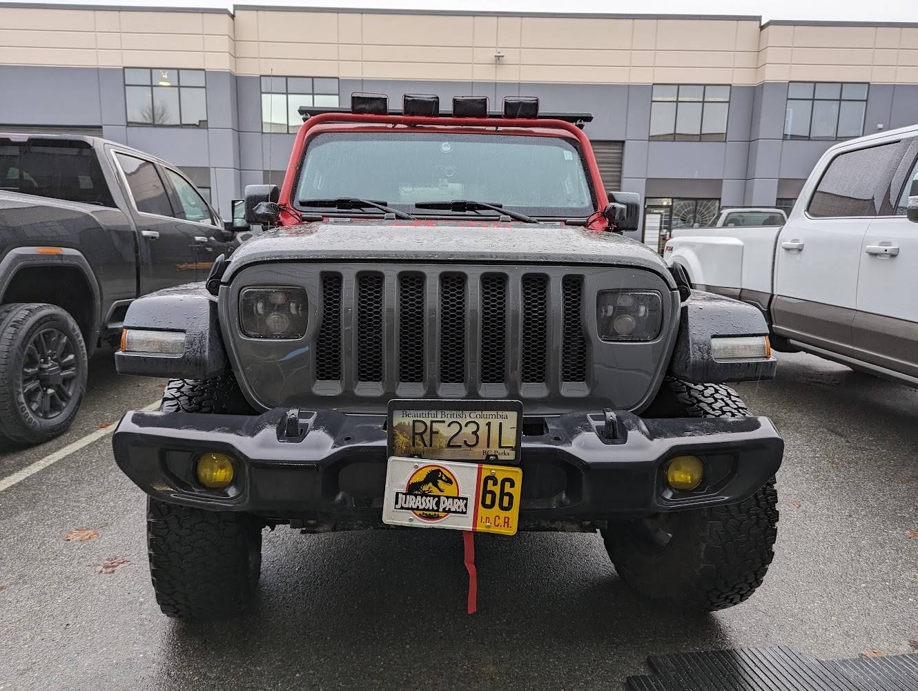

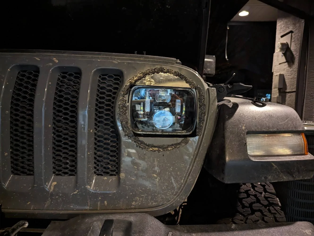

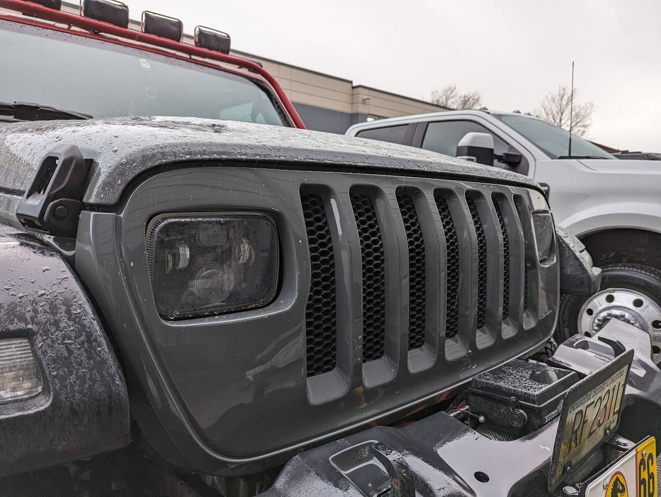

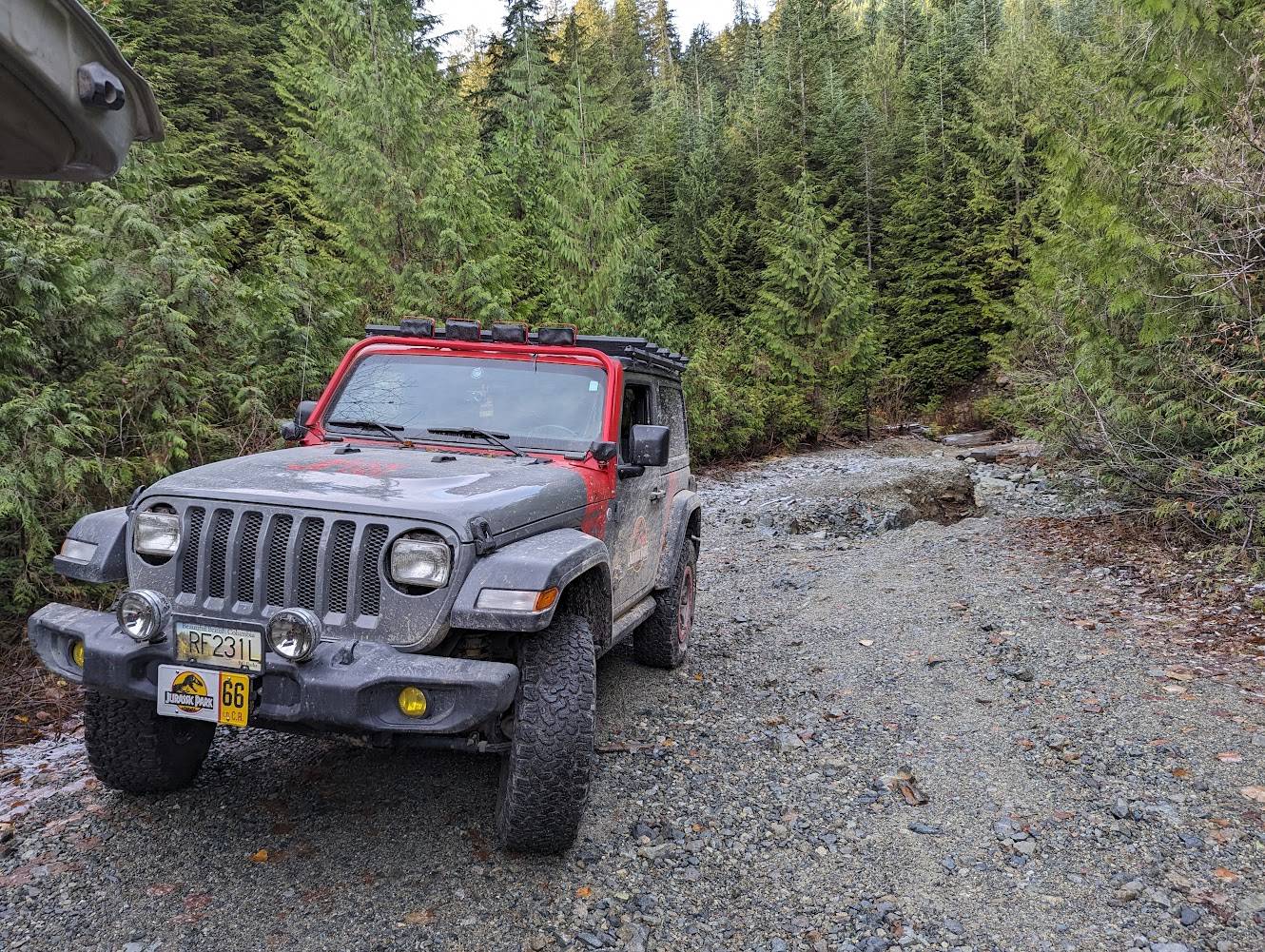

This was a longer project than i was expecting at just about 30 hours. Im never doing that again but im happy with the outcome. Total cost was about $160 including the auxbeam headlights, total material cost was just 50$ and lots of time, had to take a wheeling break midway through. lots of pictures to show the whole process.

I had my worries about the quality at the start, but dang! Well done with the finished product!
thanks> yea it looked rough, plastic welding never looks pretty especially when you have the wrong style welder and no actual filler rods, just scrap cutoffs, but I get shit done in the end

i ran into a rock wall thus the broken plate frame lol , it wont be on much longer, just waiting on my new bumpers and i have a cast hawse fairlead to swap onto it and ditch the rollers

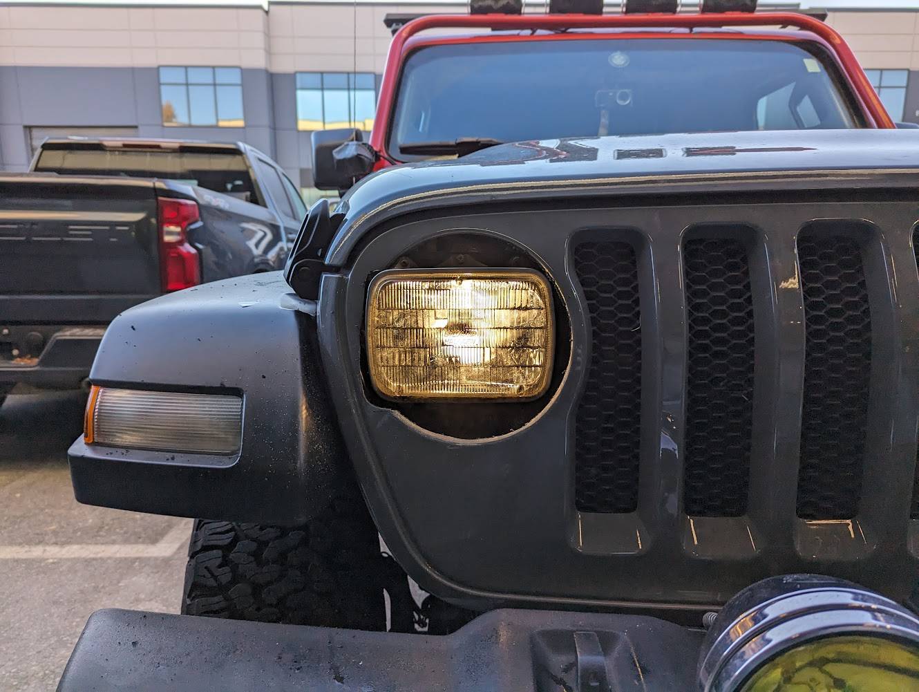

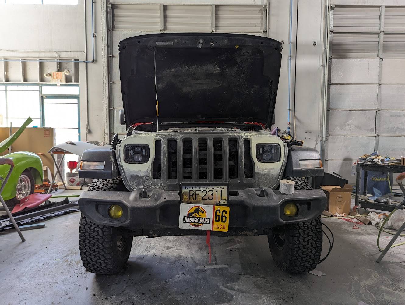

My only question is, how did you fit the square headlights and attach them to the round headlight fastener points?
For a time when I was thinking about doing it, I figured I would modify the aftermarket XJ headlights and the mounting points to fit and screw into the circular JL headlight mounting points. Is that what you did?

Interesting.
Shame I wasn't the first one to do it, but at the same time I'm kind of glad I didn't do it now. Not really a fan of the look. I guess the JLs just look better with round headlights.
The headlight brackets and buckets came from a Nissan d21 pickup. They where nice flat brackets what I would weld too. I just made a couple standoffs with some bends to bolt to the stock mounting holes. I temporarily tacked everything together so I could move them around, to get them perfectly lined up. I still need to finish welding them and cleaning them up
I know it's not everyones cup of tea but I love weird
