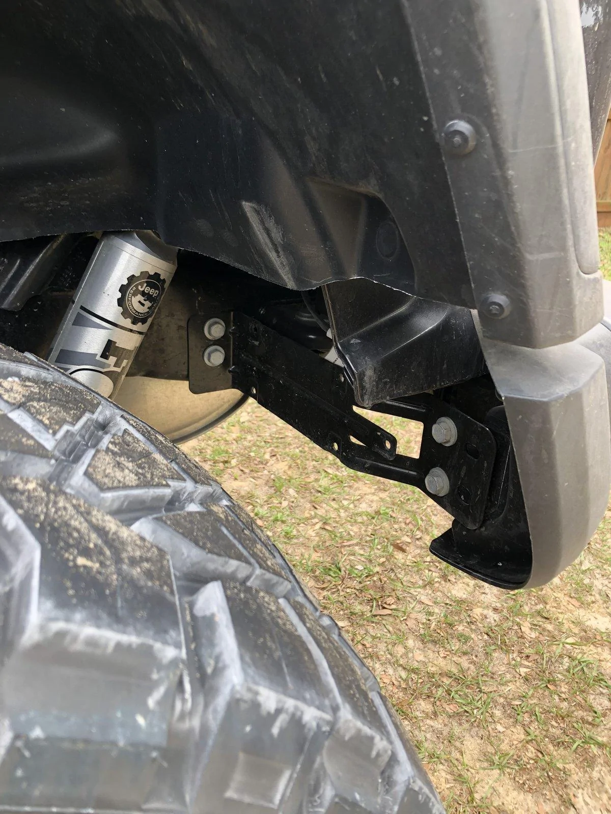

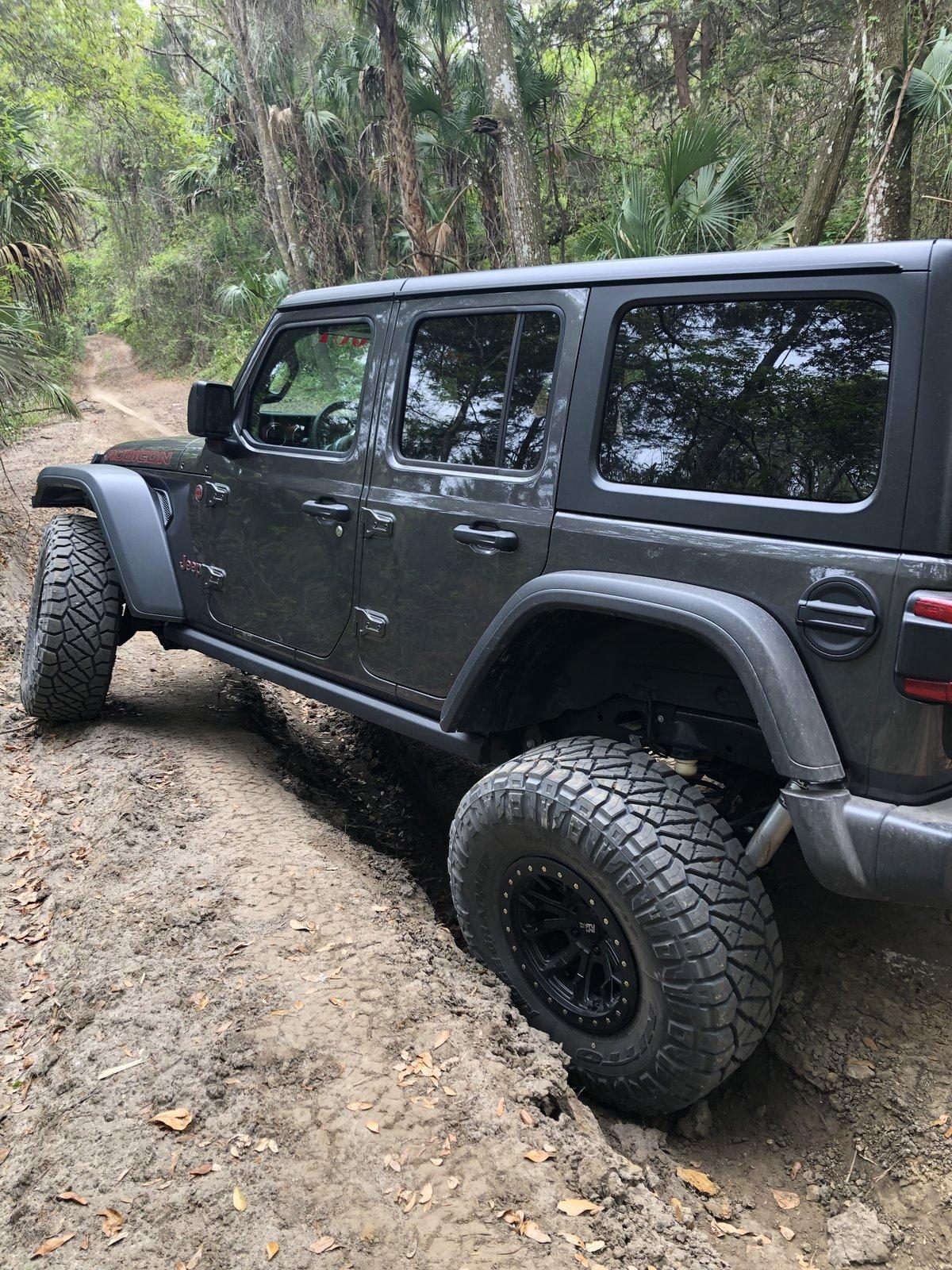

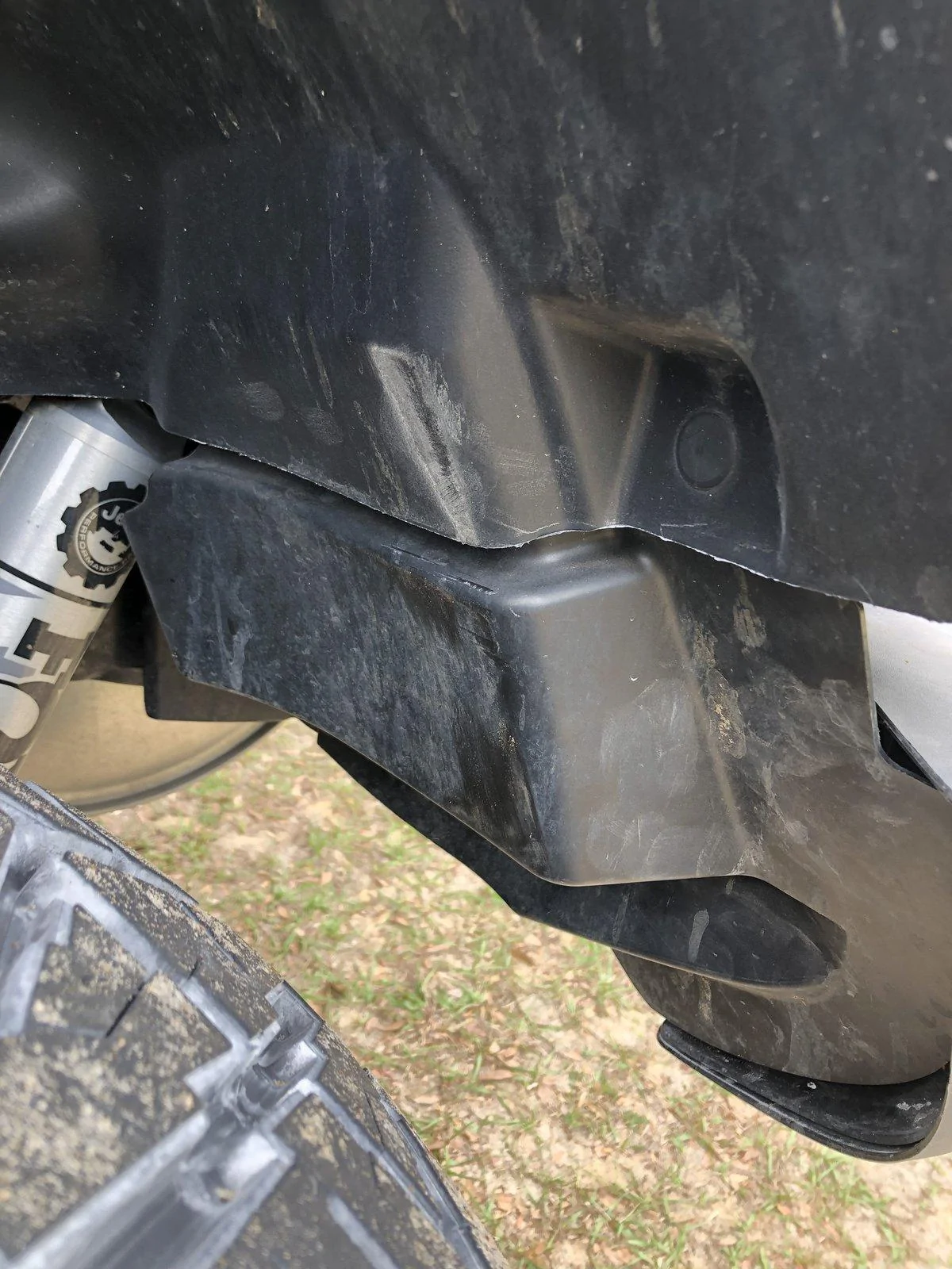

Ok.... just got back from the trail, trying to see where these 37s are going to riub. I’m on a Mopar lift and the only place I rubbed is the back of the rear wheels. The inner fender on the bottom section and about 2 ā€œā€˜ on section above it . Front wheels no problems. You can see in pics the part I’m talking about. So I’m gonna hit my 4x4 shop and have them make me a flat piece for the bottom and I’ll just heat the other section and flatten it out. So you’ll definitely need to do some modifications with no lift and 37s. So much for waiting and see if your going to rub, lol, you might move fenders to the front of your list. :)

I’ve seen where heat from a heat gun can soften up that area enough to push it in. May give you the clearance you need.

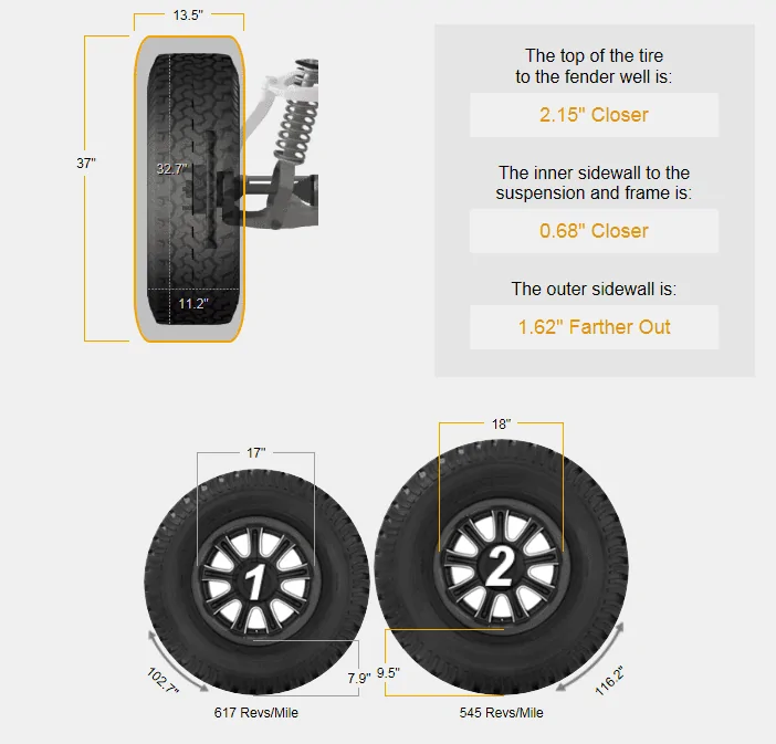

Found this tool that really helped give the visual. Looks like a lift is in order no matter what, but the inner fenders are probably going to help also. I know I can trim, but that leaves areas open to dirt and debris that I don't want.

Depending on your lift, you might get away with just back ones. That’s the only place I’m rubbing, and even that isn’t real bad, as you can see in pics, It just sounds like you’re tearing off whole side of your rig, lol! Sounds worse than it is, I’m going to reshape the one spot with heat gun, and fab something flat for piece I took off first, see how that works/looks and if don’t like it I’ll probably go with artec.
