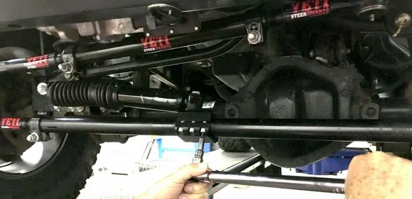

So I just finished changing out my, draglink, and tie rod with Yeti components (trackbar replaced earlier). Part of the process was to install a relo bracket on the trackbar mount area and a damper bracket on the tie rod. Everything went went well up until the last component. The stabilizer install. When I placed the stabilizer end into the relo bracket (wheels turned fully to the right) the opposite end sits pretty high above the tie rod. I don't have the measurement right now (quit last night and figured I would look it up today), but I would say it was about a 3 or 4 inch gap.
The quick question is: Is it normal and ok to pull the stabilizer end down to meet the bracket on the tie rod? This doesn't seem right to me, but I can't see any way around it and I'm pretty sure I have followed all instructions to the letter.
Of course, I decided to do this on a Friday so Steer Smarts is closed, and I can't ask them directly. In the instruction sheet, it appears as though they are bending the stabilizer down to meet the bracket. In hindsight, I think it would be beneficial to create a slotted secondary bolt hole so that the entire bracket can be rotated a bit and angle the direction of the stabilizer. I've seen other relo brackets that have that feature (for JK's though). But the instructions, and videos I've watched, state to align the bracket level with the trackbar mount. Here is a excerpt pic from the instructions. It sure looks like they are bending the stabilizer down to meet the bracket.

I left in OEM. Not sure how flipping draglink would change the position for the steering stabilizer. It is just utilizing the fixed trackbar mount. No way to change that as far as I can tell. But I'm no expert. Pretty much followed this video (along with included instructions):
(62) Jeep JL Steering Upgrades - Steer Smarts - YouTube
At 24:50 in you can see when he attaches stabilizer. His rests right on top of tie rod. Mine has a gap and you need to pull down to the tie rod.

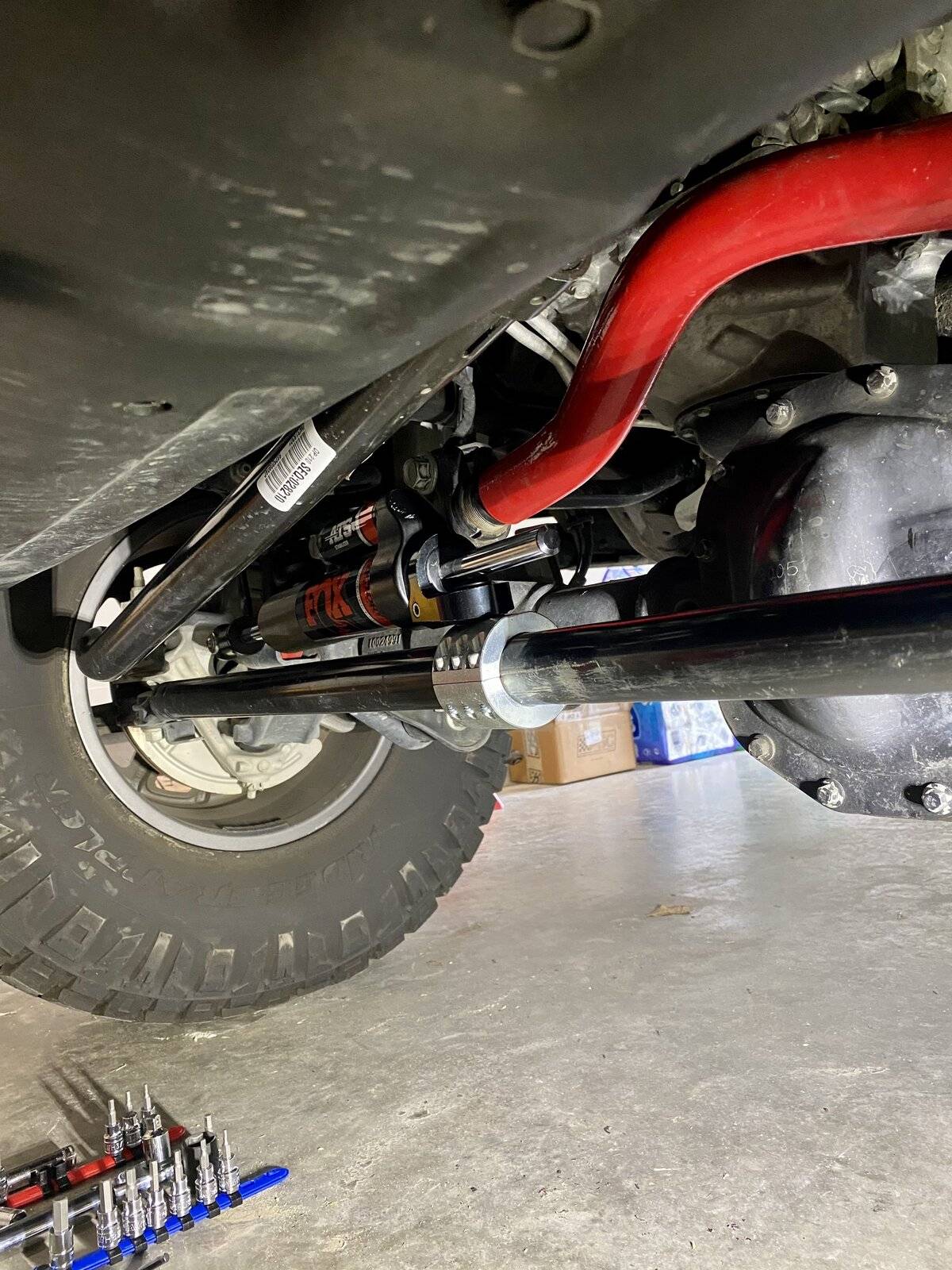

Reason I was asking is the pic you showed above appears to have high steer bracket installed. I would think normal relo bracket should line up.

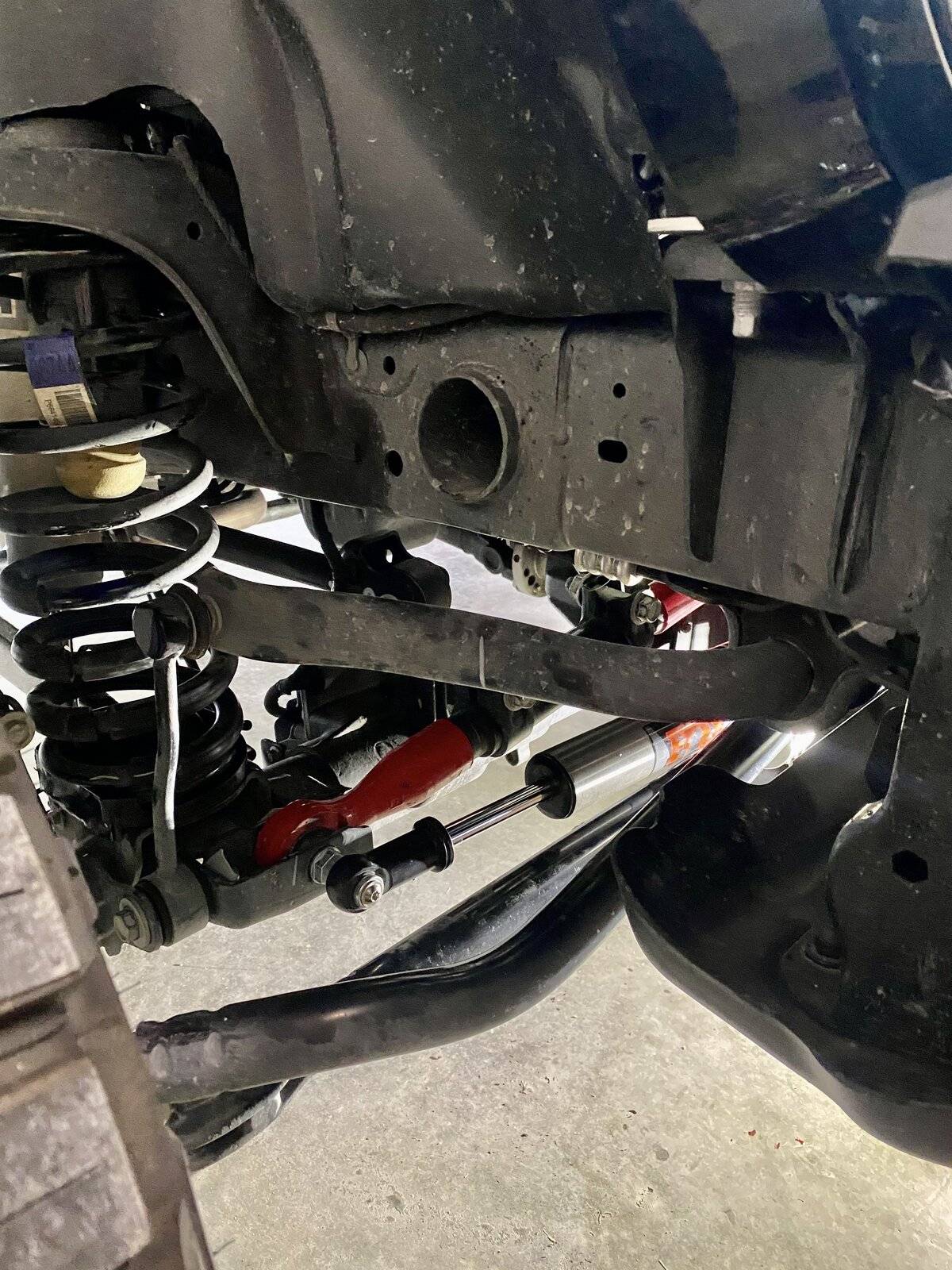

His bracket definitely looks a little pitched down but hey, video is hard to tell. Don’t think a little stress on SS bushing will be an issue. Good luck man. Maybe someone who actually did this weighs in lol. I was just spit balling :)
I relocated my SS but used the Synergy relo TB bolt and Tie Rod clamp.
