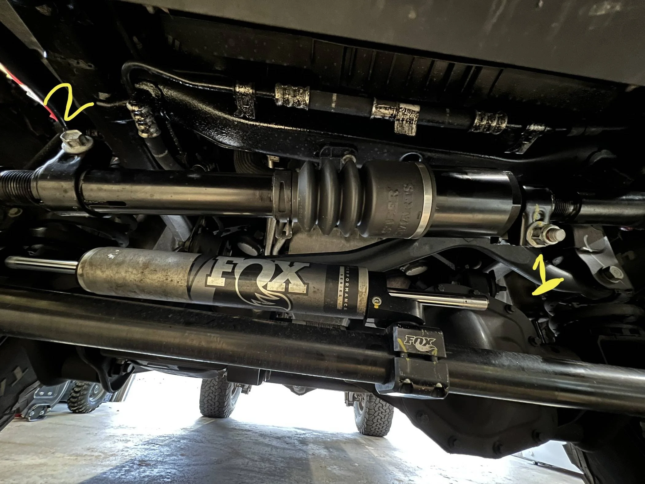

Need to ask a dumb question before I make a mistake. I just had the Yeti XD draglink installed and noticed my steering wheel is off a bit. On the factory drag link I loosened the bolt, twisted the collar and re-torqued the bolt. This one obviously is different.
Do I just loosen bolt #1 or do I also loosen bolt #2 in the below image? And since I dont see a collar like the stock one, which part do I twist to make adjustments?
Im sure if I went and loosened it, it would make sense but I'd rather ask first.

You should loosen both and twist the portion in the middle.
Double check that you have the right amount of thread engagement first. If you do, then adjusting the center portion will be enough to fix it.

Perfect, thank you
