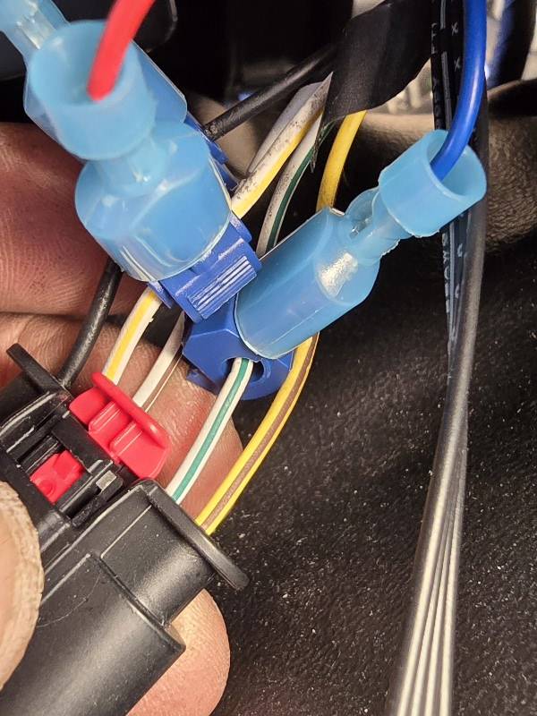

I've been reading and just wanted to show all the new JL owners on what wires to install these vent lights onto.. I'm retired with some electrical experience and thought to throw this out to help those who want to install the XK Vent Glow light..
With that being said, from what I found, the green and white are you're turn signals lights and the brown and white are your headlights.. As you can see, I used the yellow and white, that works well if you want the lights on your DRL but I wanted mine to go on with the headlights at night. The turn signals work all the time day or night. It a very easy install, but for the life of me I couldn't find a 2024 JL lighting schematic, but I'm not very good at surfing the web
.. So I just had to figure it out on my own.
