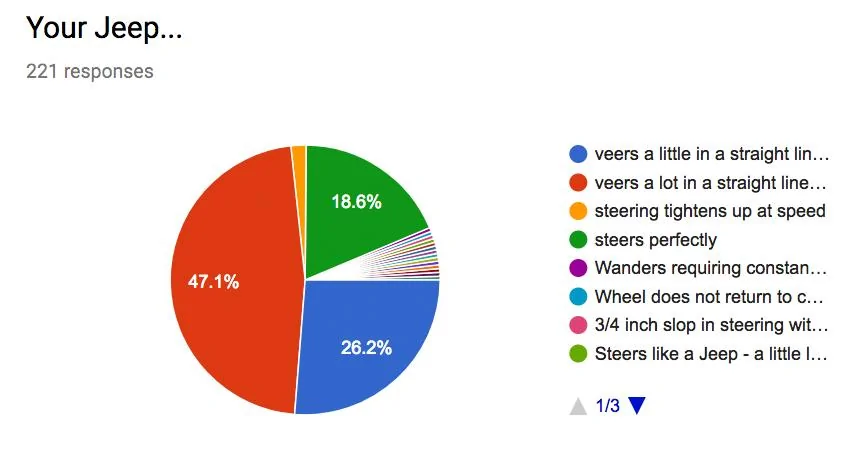

Took the survey. Mine steers pretty well - feels like I kind of expected for a Jeep, i.e., looser than standard suv and a tad busy on the highway.
Could be a bit tighter. But no concerns driving it, even at 80mph.

Remarkable, of the 179 responses only 35 "steers perfectly."
Not to mention the build dates are all over the place. So you really can't say oh so and so dates are problem free.

Mine is good at all speeds but I feel a little touchy at highway speed, driven to 85 mph and you have to keep the wheel very still or you look drunk.

After speaking and consulting with multiple members on this forum about the constant steering issues that many have experienced, we thought a survey would be beneficial. If you have current steering issues (or if you had them and they were fixed by the dealer) please complete this survey:

Thanks for doing this. My problem doesn't seem as bad as many, but we all want a fix and this will document how prevalent the problem is!
