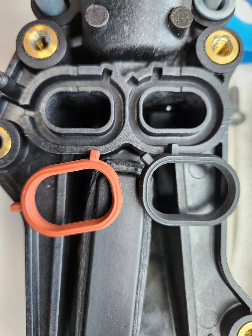

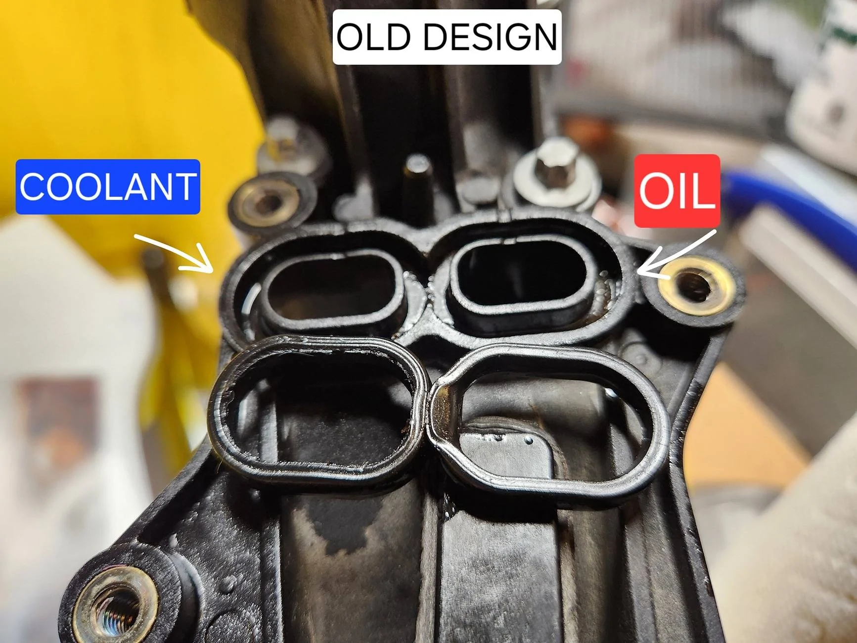

No matter which model you choose, be CERTAIN it has the redesigned gasket system between the oil cooler and the main housing. Mopar redesigned it recently and improved the sealing by adding a web between the coolant and oil ports:
Old Design:
Jeep Wrangler JL Wrangler JLU 3.6 20240305_035357 (1)
New Design:
Jeep Wrangler JL Wrangler JLU 3.6 20240301_162257
