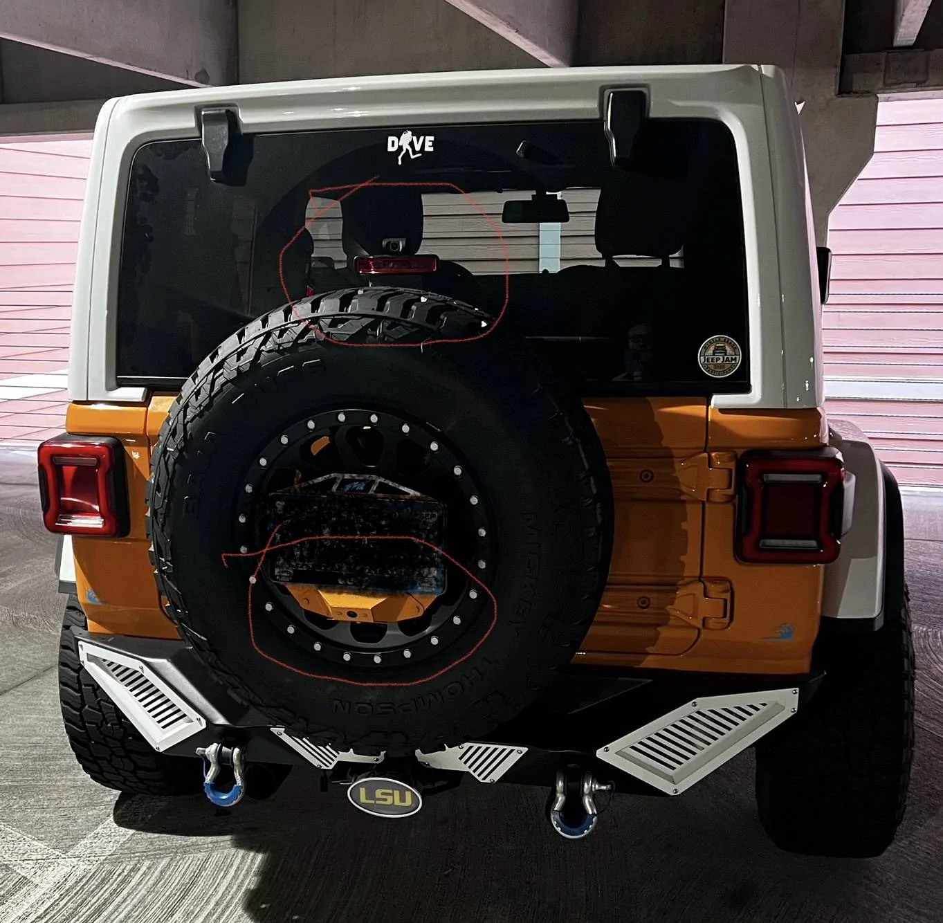

I have two rear facing cameras. One is my backup camera mounted in my spare tire license plate bracket and the second one is an Auto Vox V5 Pro (rear view video mirror) with the camera mounted on top of the 3rd brake light using 3M double-sided tape. I’ve had it mounted there for almost a year now.
Here’s a picture of my setup.

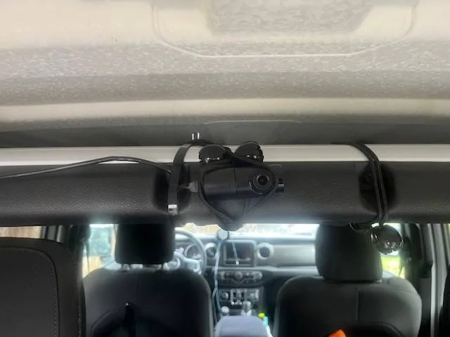

Curious: are your intentions with this camera for visibility, recording motorist and/or momentous driving, both or something else?
To answer your question, here's where I installed the rear portion of my dash camera on the Sports Bar. Good old bungee balls and zip ties allow me to not make marks and allow for ease of removal/repositioning:
Jeep Wrangler JL Wolfbox (or really any) rear camera installation IMG_2398
But if visibility is your reason for buying this product, not recording, maybe you should return the Wolfbox for (if you don't already own one) a JL Tazer Mini, which can display the factory rear camera's image beyond the 5 second or so factory built in time limit, in addition of course to providing you with some other pretty cool functionality.

Nice! How are you liking the set up? My third brake light isn't there anymore, it's just above the factory camera as I have a new teraflex spare tire mounting system installed now.
I love it so far. Only is I have the backup camera at bottom mounted upside down in the housing. So I’ll need to take it apart and flip it. Other than that everything thing is working fine. I love the wide-angle view and night visibility of the Auto Vox. It really cover most of the blind spot areas.
