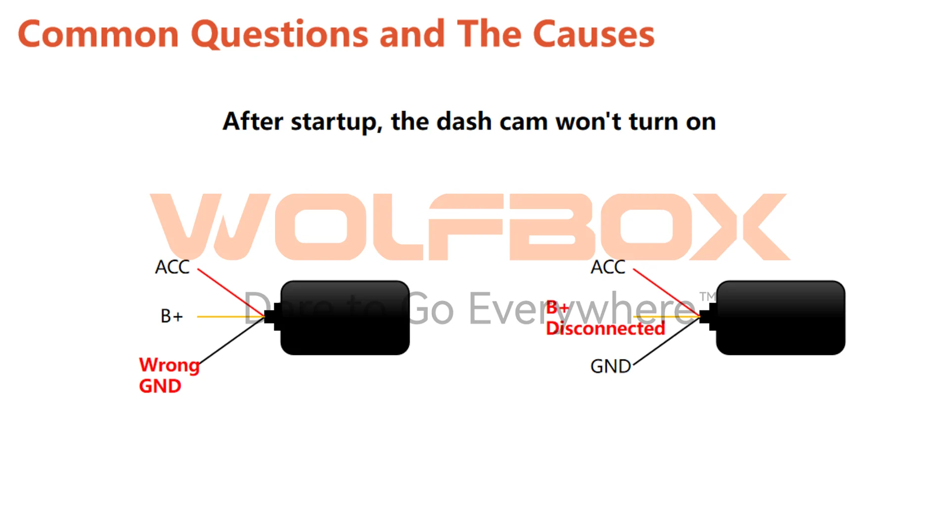

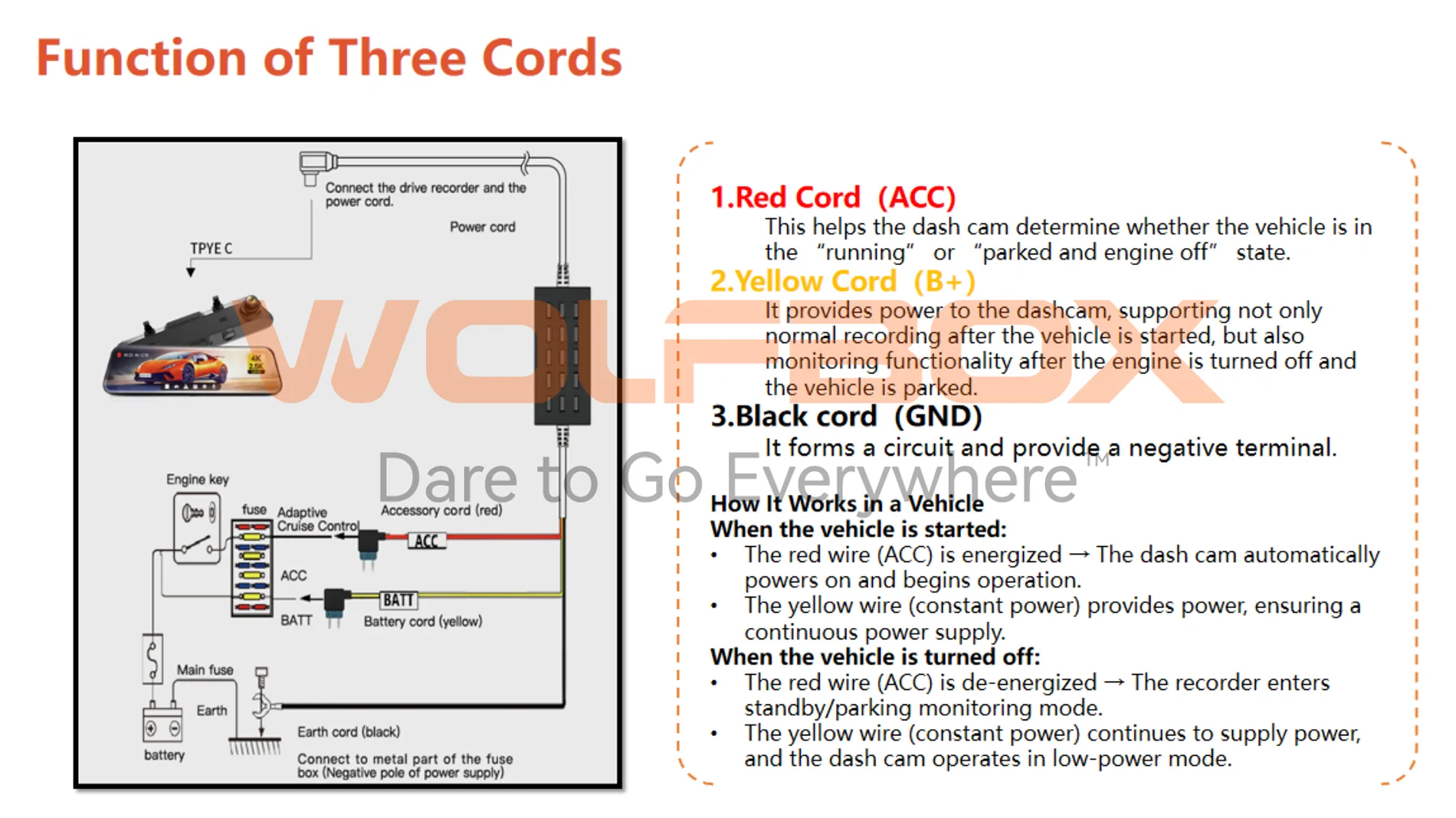

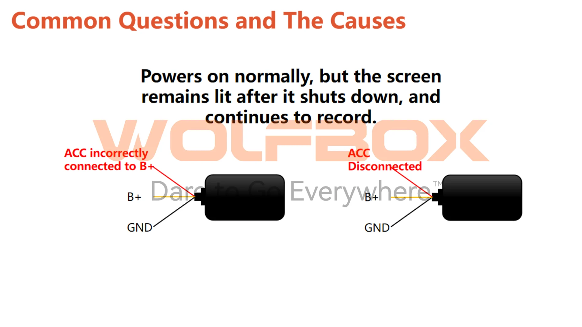

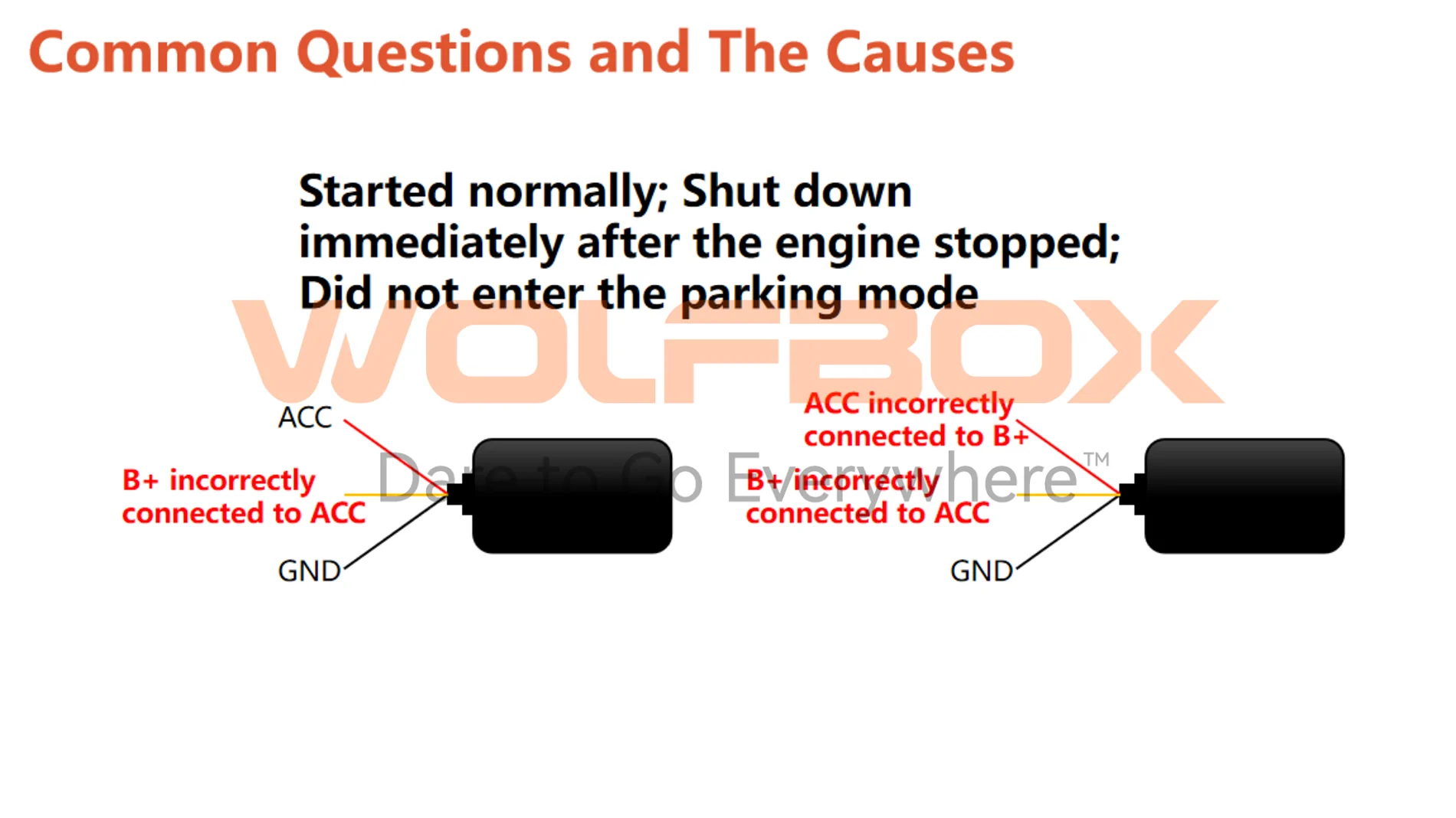

In today’s article, we’ll dive into common issues that may arise when a hardwire kit isn’t working properly and explore their possible causes. This guide can help you troubleshoot and ensure your dashcam setup is running smoothly. Let’s get started!
