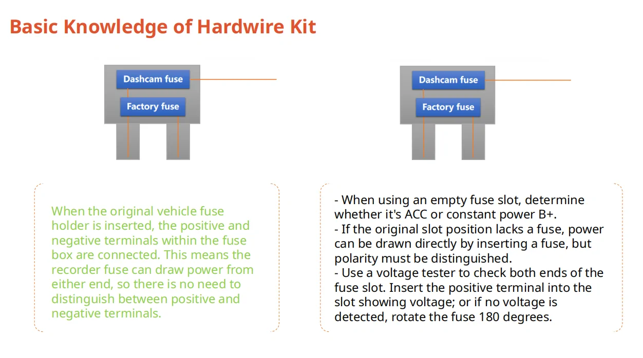

- Locate Your Fuse Box: Check your vehicle’s manual to identify its location. Common spots include under the dashboard or hood.
- Choose the Right Fuse Slot: Select a fuse slot that provides power only when the car is on (ACC) and another that’s always powered (BAT).
