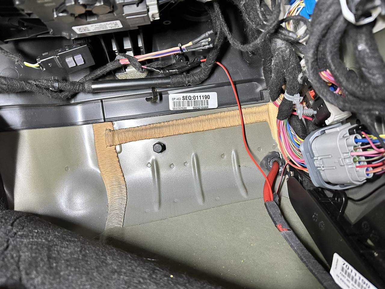

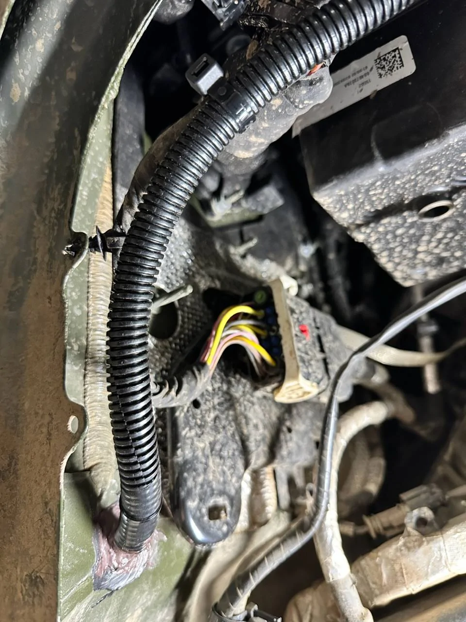

Or if you’re not afraid to drill a new hole…
I drilled one right at the point where the floorboard meets the firewall which is basically right under the battery…
This is inside the passenger side inner fender liner (I’d go an inch to the driver side as there is a wall where that seam is) …
Jeep Wrangler JL Wiring from firewall to passenger side F770D6B3-639E-45EE-86F6-B5A69BD0EEED
This is a great place as it’s super easy to access and the wire can then go under that black piece (I have it out so you can see it). Or the wire can route upwards. It’s then all protected by the kickpanel.
