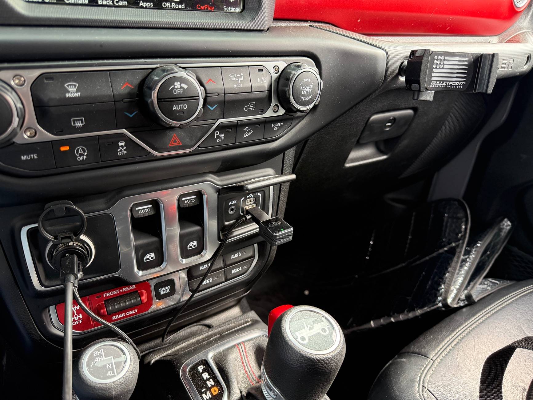

Hey folks! I recently switched from Android to Apple because wife switched and it is a PITA to have separate OS in one house. I was running the Motorola dongle for AA with my OnePlus, and regardless of how the connection to AA was after shutting off car/walking away I just felt better having an inline switch to shut off the power to the dongle…but it was one more thing to remember while entering and leaving the car. With the IPhone, I went with another dongle specifically for CarPlay, and it cut out occasionally…probably because on my 2019 the data/charge usb A port is not that many watts. I decided to swap to another type of dongle, and no more drops…and after a lot of searching I also found a splitter cable from Amazon that takes power from the cigarette lighter socket (I am running a flush mount charger with both usb A and C) and then the other end goes to the data port (usb A in the dash) and then the other end of that is a female usb A socket (for dongle). Now, I get the wireless CarPlay I was seeking AND as soon as the car is shut off so to is power to the dongle. MUCH better….and now I don’t care how long after I shut the car off the usb ports are still powered. Other folks may have had different experiences, but before I was able to shut down the dongle for my AA my phone would search until the dongle shut off (my office is close to the parking lot) and with the CarPlay the dongle just got hot. The splitter took care of it.
Link to the splitter cable please?
