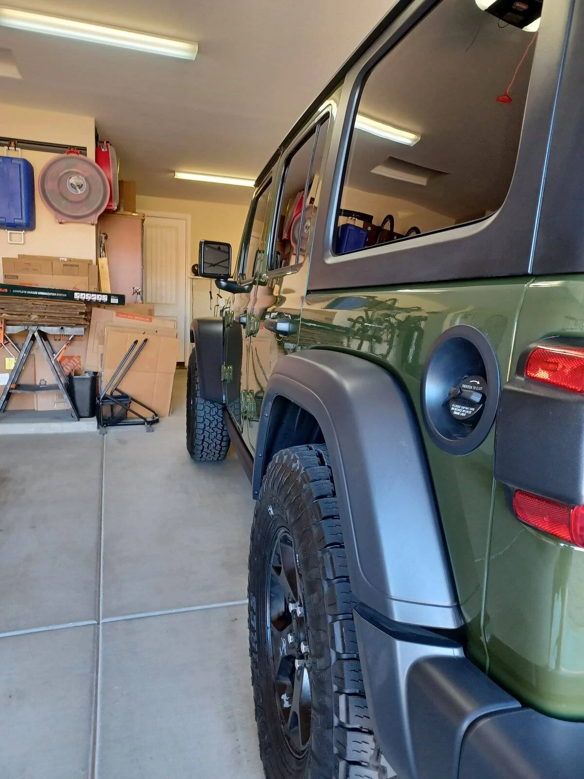

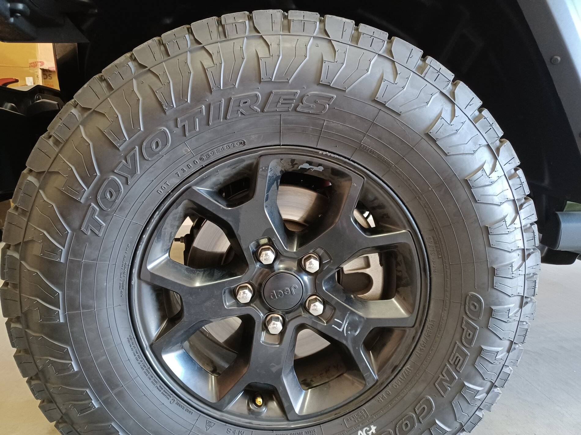

285/75R17 Toyo ATIIIs on my 2021 Willys Edition, stock Moab wheels, stock height:
No issue with rubbing on easy to moderate trails. I've since lifted the Willys to be able to tackle some more technical trails and I am having no problem on those either.
MAD, did you have to do any wheel spacer for the lift? I've read the rear sway bar connections may contact the oem 7.5 wheel due the factory offset.
Yes, I have a set of 1" aluminum spacers from Bora.

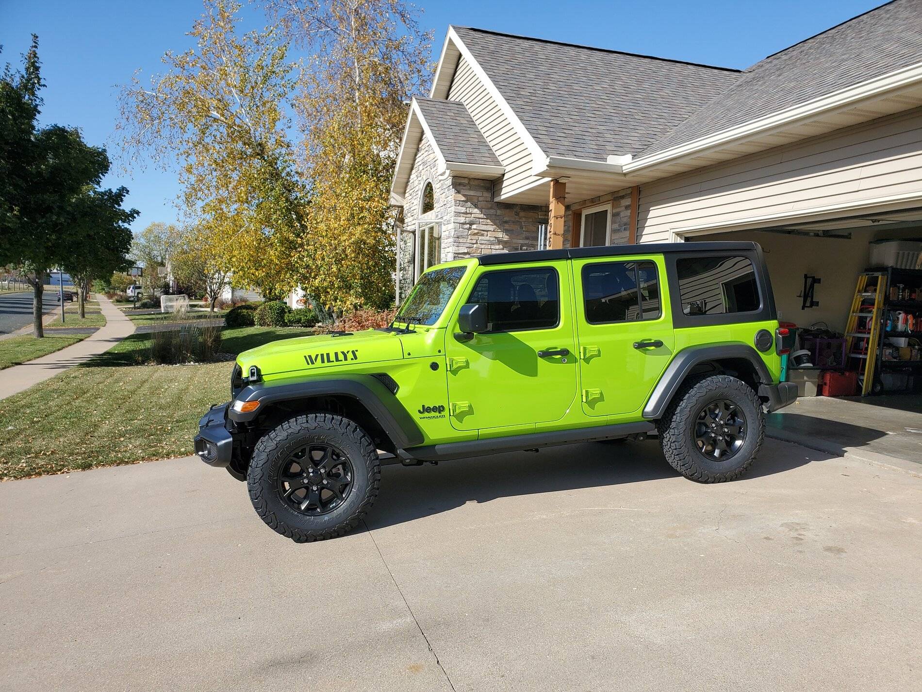

Just had these 285/75/17 put on stock wheels. This is with a 2.5 RC lift.
Looks good! Hey, how much wheel well clearance do you got between the top of tire and bottom of the fender flare, about 6"? FYI, I got the same tires in a 35" with no regrets so far.
