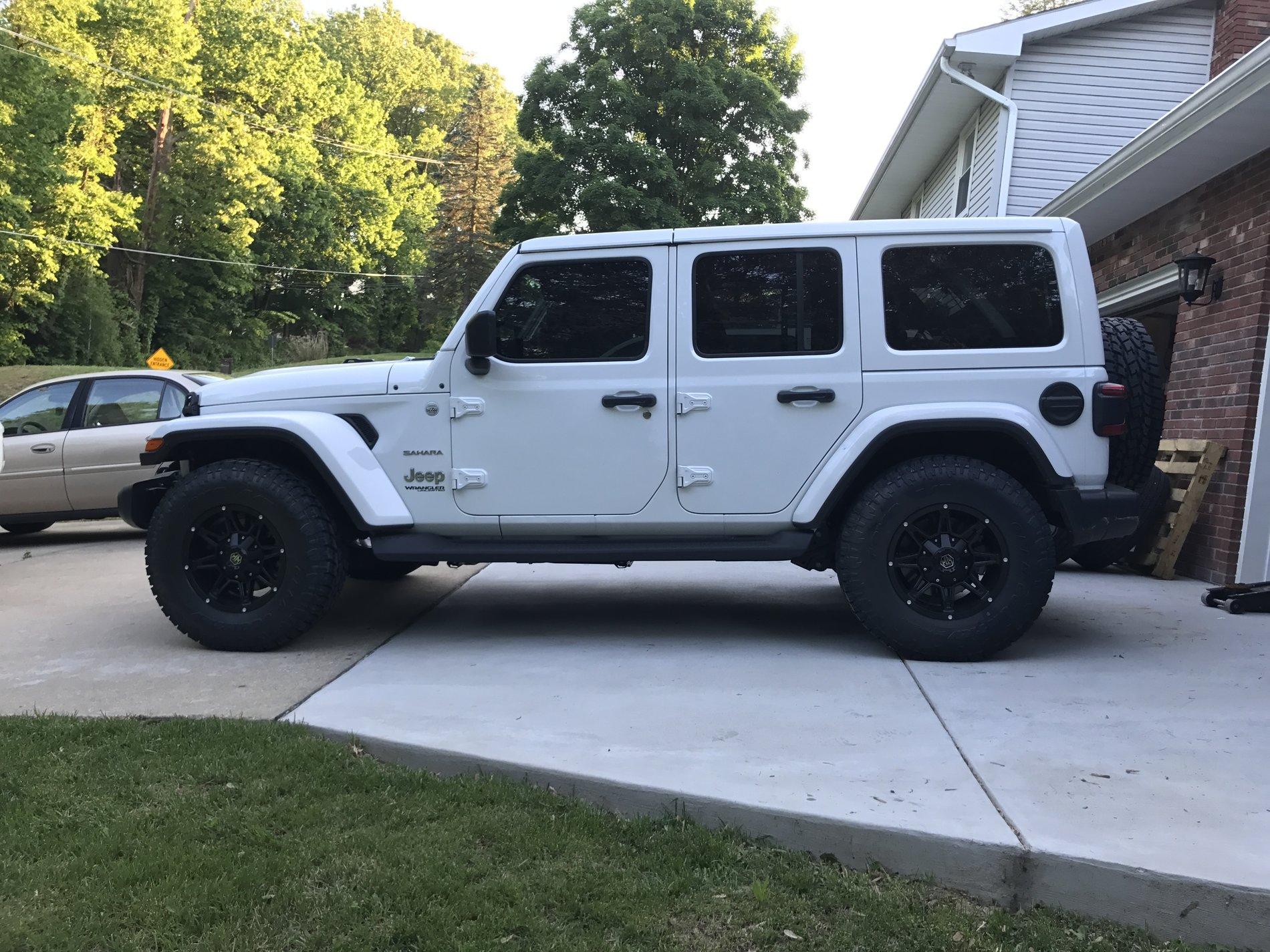

Looks great, do you have any front and rear pictures.Just mounted the toyos 285/75/17's on Mayhem Rampage wheels 17x9 +18 offset. They fit perfect with no lift and the spare tire just clears with no relocation bracket!
Plan to do a 2" lift soon to give them some breathing room!
