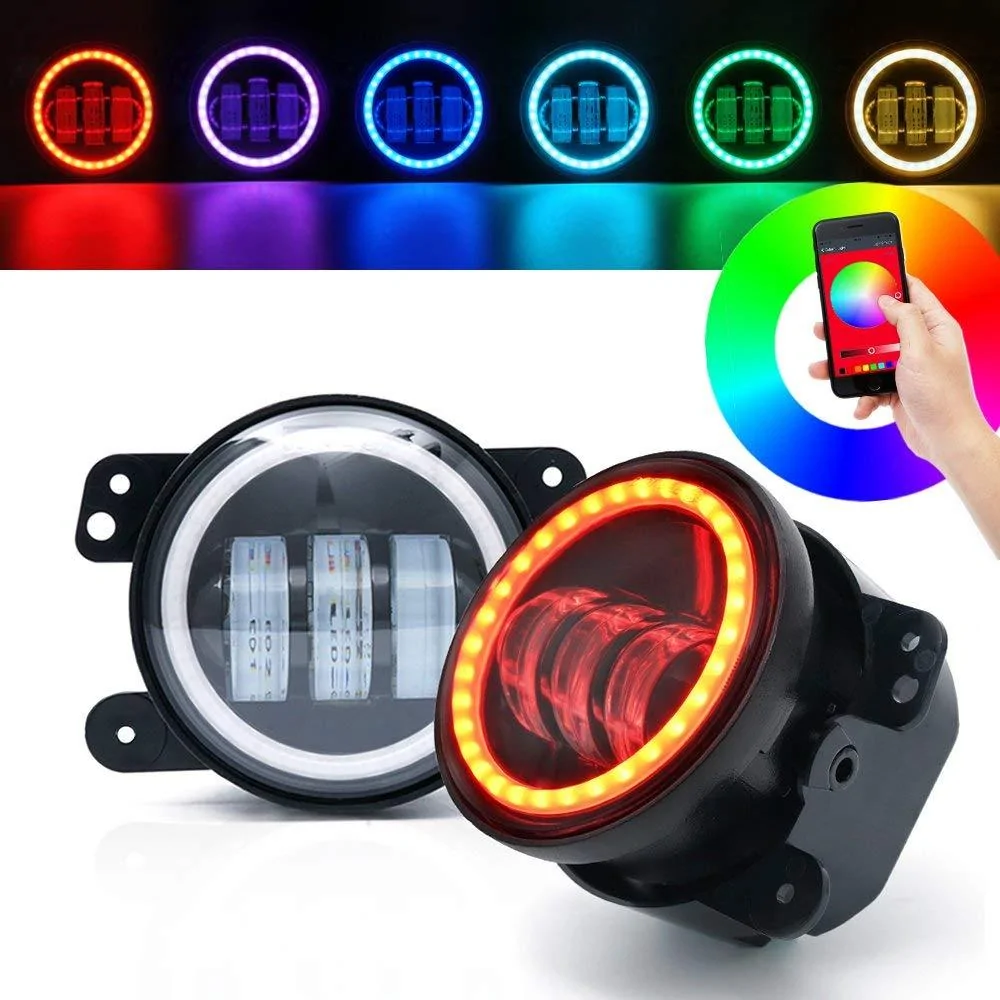

Has anybody purchased these fog lights, or something similar, to confirm if they work with the JL?
I'm mostly concerned about the wiring harness, and if it's plug and play. I assume it should be since JK fog lights work on the JL right?
My other thought is for the halo. It looks like it has a separate wire and I was thinking about hooking them up to one of the 4 aux buttons to turn on/off independently from the lights themselves.

I ordered directly from Xprite thinking they would fit. I called to ask before my husband installed and they said no, due to the bracket.

Do you know if the harness was plug and play? I figured they wouldn't fit in the stock Sport bumper due to the halogens having a different bracket, but I'm getting a different bumper anyway and wasn't worried about that.

As far as I can tell there are 3 JL bumper designs, sport, Rubicon/Sahara Plasic, and Steel.
Sport use a fog light with 3 mounting holes pattern and will not work
Rubicon/ Sahara Plastic use a 4 mounting hole pattern and is a direct swap for 11+ JK plastic bumper fog light like those posted above
Steel bumpers use a 2 mounting hole design similar to the JK steel bumper design but i have not seen a confirmation that they are direct swaps

Any updates? Did you end up ordering these? I’m thinking of getting a new bumper but the stock halogen fog lights aren’t supposed to fit in the new bumper. It’s supposed to work on non rubicon led bulbs. Why so specific I have no idea
