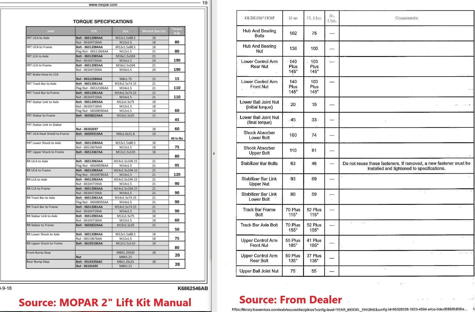

Hello all,
Subject title. The attached picture. So, my '19 JLUR has the 2" Mopar lift installed by dealer. My front suspension developed some 'popping', so first thing I wanted to check was the control arms. I ask dealer who put the kit on for torque chart and they sent me the chart in the right, of the attached picture.
So I then compared to the Mopar lift kit manual and it provides the chart on the left, in my attached picture.
Which is correct?
