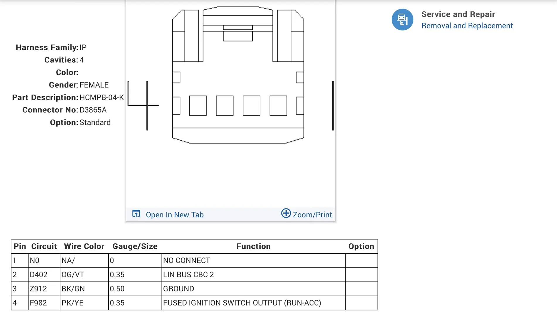

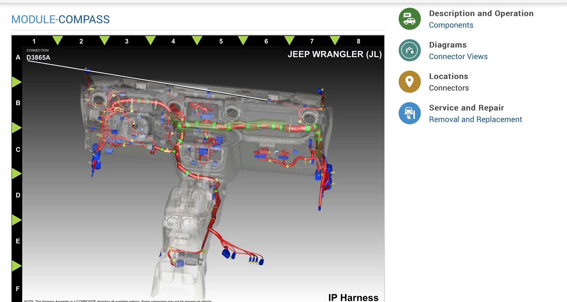

How many wires in that connector and what colors are on each wire?
Jeep Wrangler JL Where does this plug goes??!! IMG_4644
Jeep Wrangler JL Where does this plug goes??!! IMG_4645
david91
David
Dec 22, 2025
Arkansas
2019 Wrangler Unlimited Sport
It is definitely this one.
mine doesn’t have a module and honestly I took everything out and back in two weeks so although I don’t remember removing the module, it might be that there was one that I can’t find now. But is definitely not mounted in place so I guess the plug goes plugged to a hole in the dash just to hold it in place like one of the posts I saw about adding a compass module.
thank you
