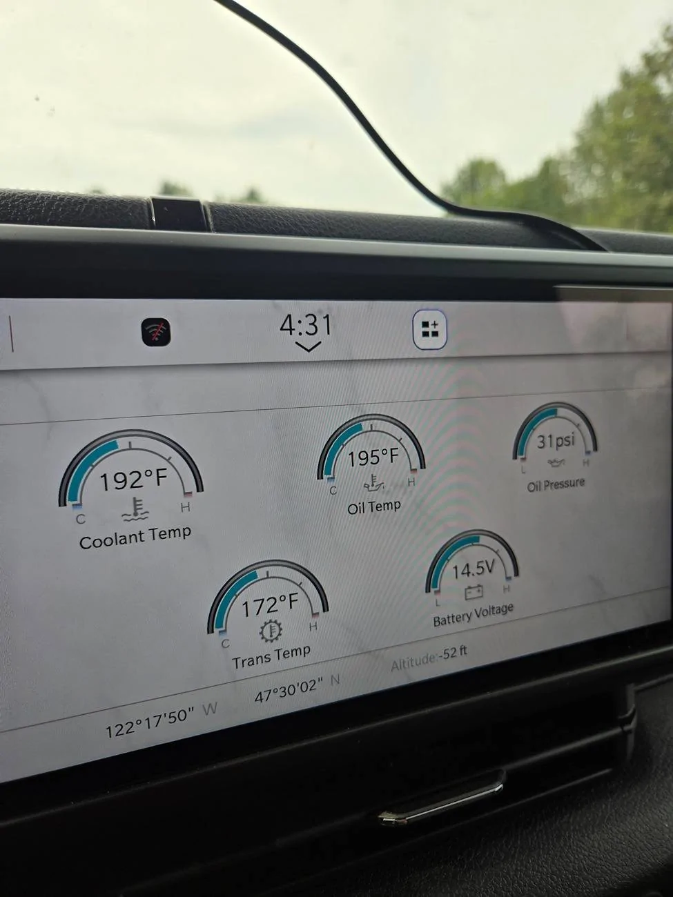

It is 14.5, how come it's not in the middle or lower like the rest of the normal stuff?

Id say normal - my 21 will read anywhere for 12.6-14.5 as well. I've had both batteries and alternator replaced under warranty. I have added a separate usb / usb c charging port with a volt reader and it lines up within .1 volt of my dash.
Only time to really worry about it is when it's below 12 - 12.5v while running. It's digitally controlled and not just solid state like older regulators. It'll fluctuate based on many different load factors. Nothing to worry about.

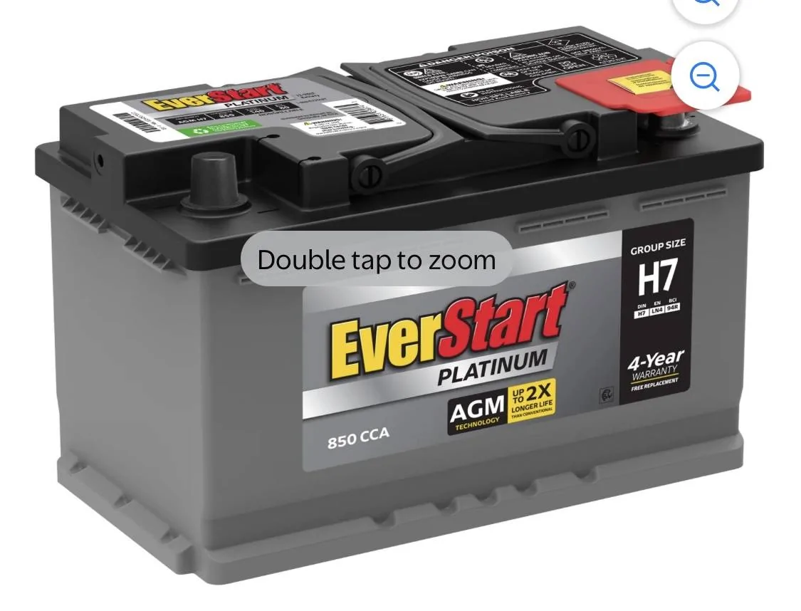

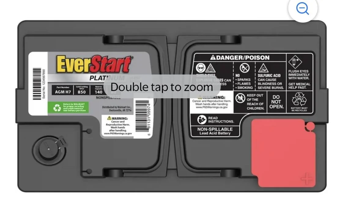

Just replaced my main battery with 4-yr AGM battery from Walmart. Easy install.
The mopar battery didn’t last 2 years. Didn’t waste my time with warranty to get another crappy battery from the dealer.

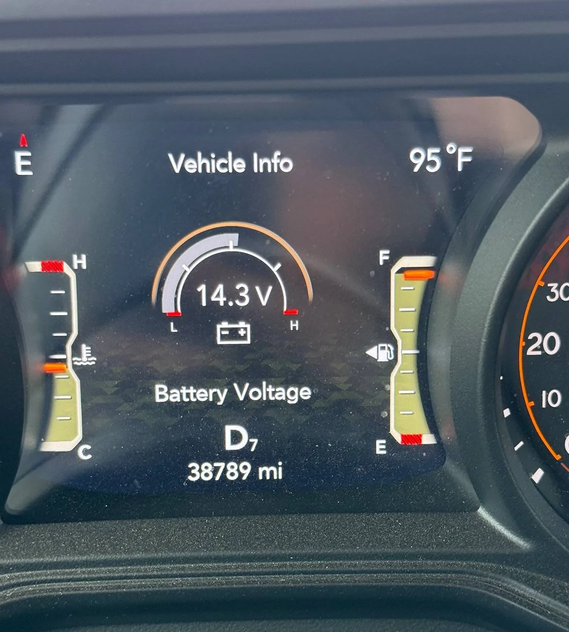

With new battery 14.3 V. Note that I only run on the main battery. The ESS has been disabled, and the aux battery has been disconnected.

Guys, what if it is a little over 14.5? Today mine showed 14.6 🫣

Mine shows 14.6 often ever since I put it in almost a year ago. Don’t worry about it.
