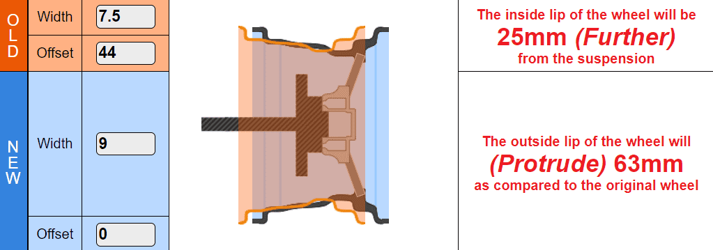

I looked up the specs for the Motiv 427 and the 17x9 - 5" backspace (this equals 0 offset) does use a dual drill bolt pattern (5-114.3/127) which means it has 10 lug holes. The wheel will just need to be rotated to the correct bolt pattern during installation.
The center cap for this wheel covers all 10 lug holes once tightened down. The center bore is larger than the Jl hub pilot, which as mentioned is 71.5mm, though there are hub centric rings to convert it to hub centric (78-71.5).
For reference, here's how far out the 17x9 0 offset Motive sits in comparison to the factory wheel. If you take a tape measure and measure from the front lip of the factory wheel outwards 2-1/2 inches, this will be the point of where the front lip of the 427 sits
