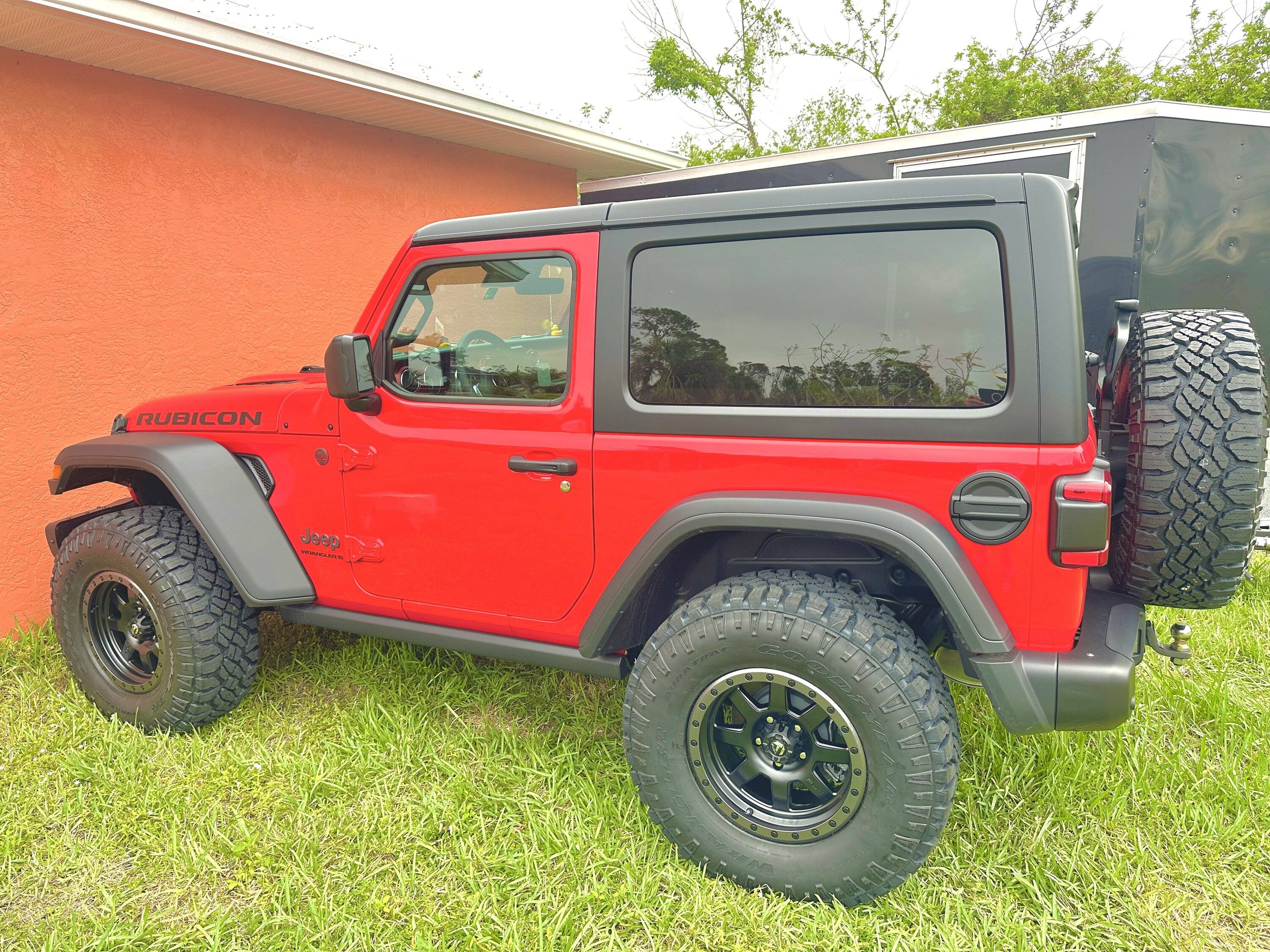

My JLR rolled in a couple of weeks ago and one of my options made the cut...4:88. Wishing Jeep had thrown in the bigger meats but no, got the little boy shorts aka 33s.
4:88s and 33s is NOT a good combo unless being the Red Light Bandit is your game. Having run just about every ratio there is from 3.07s all the way up the ladder to 5:36s I waxed and waned on what tire to shoe my JLR with 4:88s. When I hit the 4:88s and beyond I have always ran 37s or more. As my JLR is not an off roader rig as I don't like the Mud and Sand of Florida I got to thinking...set of Goodyear Duralrac 35x1250x17. [ https://www.4wheelparts.com/p/goody...rangler-duratrac-312054142/_/R-DVFB-312054142 ]
As much as I love my BFG KMs the GY Duratrac is one helluva great around tire, better than the KOs IMO, not much but better nonetheless. I played with a lot of charts and numbers and decided the 35x 12:50 was the way to go.. My first time running a 35s, but its middle ground 'tween 33s and 37s.
How is it working out? WOW, really impressed. Its a super combo giving me a bit more MPG (about + 1-1.5 mpg), a GREAT ride better than the OEM 33 KOs. the 12:50 makes far a very good handling Jeep, it really takes the curves and rough roads very well. Stopping is improved and over what I had which was noted on my window sticker "Heavy Duty Brakes". (never knew Jeep had them), My JKR Recon I replaced the front brakes with EBC Green Pads and Slotted/Drilled disks. Vast improvement in stopping power. My 2023 JLR has the best brakes I have ever had on a Jeep, stopping is better than my 21 GladR even.
My recommendation: 4:88s and 35s is a GREAT and even better combo on my JLR vs 33s or 37s for a street rig; if you are off roading then the 37s may be a better choice.
OEM Wheels and 33 KO tires

Fuel Wheels, 17 x8.5 35x12:50 GY Duratrac.

I bet that gearing choice w/ the 6 spd and those 35s is really the sweet spot, especially in 4Lo!

I assume the Duratracs are a true 35, would be interested in their no-load height, I know the stock BFGs are more like a 32.5. A true 35 would be a good lift upgrade just w/ the tires for sure. Probably just get by w/ 3/4" lift pucks if you needed just a bit more room.
I can certainly tell the diff when I go to get out of the Jeep and I am 6' 2". Big move up from 33s that I know. I have rubbing anywhere, but just town driving, maybe on trail I could possibly see some rubbing ???
I may end up with a puck lift, I want is a take-off suspension from a JLR XR, its set up for 35 tires...
