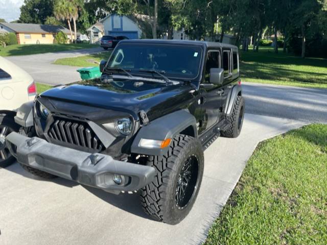

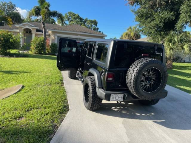

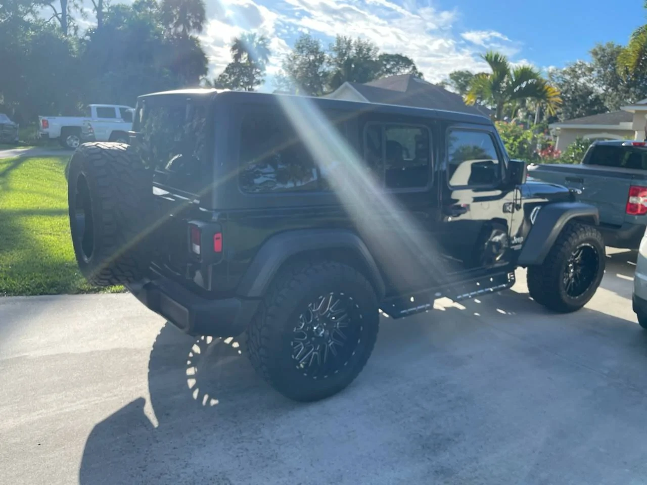

This is my wife’s 2018 JLU on 35-12.50-20’s. No lift at all. No rubbing unless she hits a big hole or bump. I have a 2 1/2” lift kit to put on it, which should help.
I don’t know what gear it has, as she bought it used. It’s very peppy though. The speedometer is about 10% fast at 55 mph. It’s got the gas V-6 with the automatic.

Hey 2018JLUsed - nice looking rig. Can you post a photo from the side? I’m at 33”s (285/70r17) and thinking going a little bigger but not sure clearance. I have stock suspension on a 20 Sahara JLU.
Jeep Wrangler JL wheels and tries FA128D04-E80C-4894-9266-1170DA13B7A2
It’s the wife’s Jeep. I have a black standard grill and the lift kit to go on soon.
I’ll check the gears when I put the lift on it.
