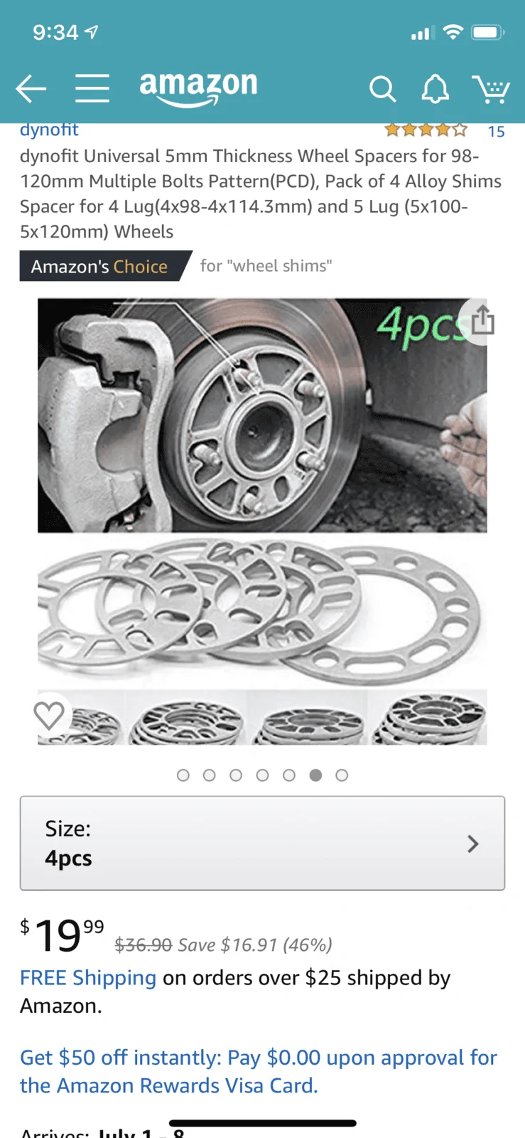

So you’re saying not to use these? I only need a little push out.
Yes these are what I am speaking off. They are basically a thin plate that gives you a little extra room. These use your stock bolts and lug nuts. This reduces the amount of the bolt that goes into the lug nut. Could lead to a failed bolt or nut.

They are fine, and used in drag racing to fit wider tires. So, they hold up fine. I would not go any wider than 5mm though. You need a minimum amount of thread contact between the stud and nut.
