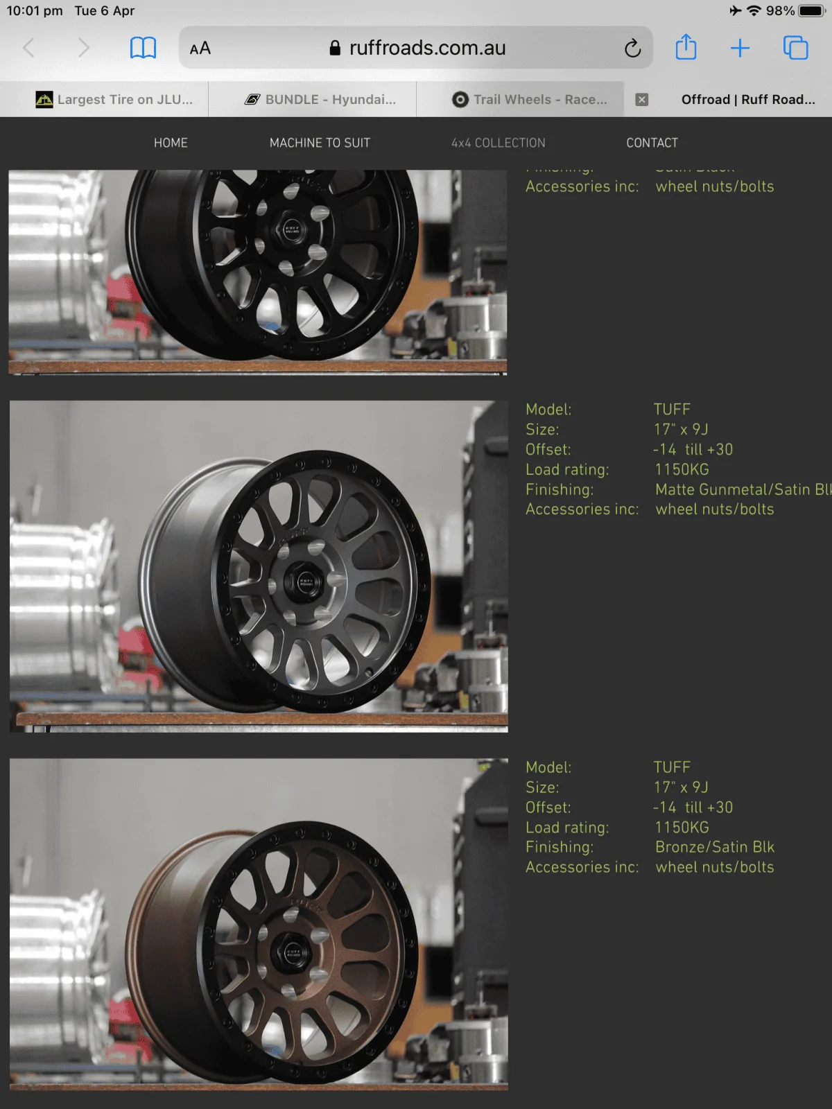

looking into the possibility of a different set of wheels and tires for my BRAND NEW '20 rubi & here ae where my frustrations lie:
1) not a fan of "poke": I"d rather keep the wheels INSIDE the flares
2) Rubi is ocean blue with body color hard top (fenders are still the basic black plastic), so I'd like to avoid all black: what I really really like is the Method double standard with the machined lip
3) there seems to be literally hundreds of different styles of wheels, but from what I"ve been seeing, there's nothing that is fairly close to factory offset/backspacing...most are all negative offset which is just going to push any tire I get further outside the fenders
what I need to find is some black wheels with a machined lip with an offset/backspacing that approximates the factory wheel...good luck with that garbage.....
Ruff roads make a similar wheel to the Method 703 but in +30 with a simulated bead lock.
I think they are made in Australia though. I am tempted to get them or a Method 703 in +25, but to be legal I need to keep them under the guards. Not sure if any of the tread will poke out.
