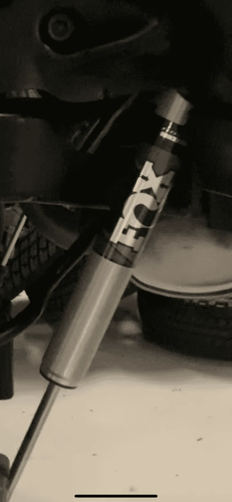

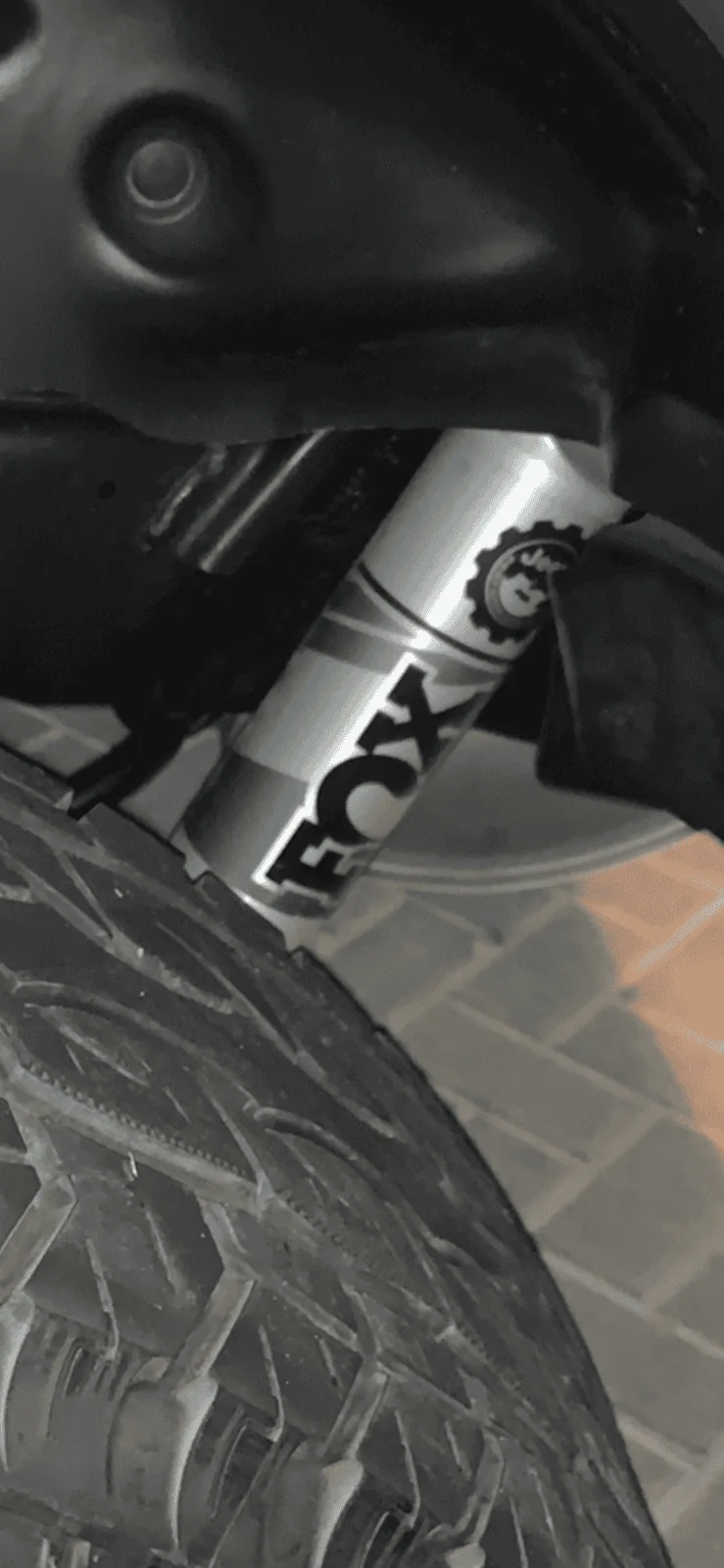

Ones from mopar which is why it says jeep and the ither is just from fox. Mopar ones are 2.5” tooHello,
Can anyone tell whats the difference between those 2 fox shocks? Because they have different stickers on?? Why?
Both are 2.0
Could it be 1 is performance and the other is racings?
Thanks
And the mopar ones are only available with the mopar lift.Ones from mopar which is why it says jeep and the ither is just from fox. Mopar ones are 2.5” too
The ones from the mopar are valved differently than the regular fox ones. If its generic fox 2.0 it will be standard valving. Mopar one are valved for the mopar lift springsBut are they different? Online it says both are 2.0
Mopar lift kit fox shocks = 2.5" diameter and come in one size. These arent commercially available without purchase of the lift kit.But are they different? Online it says both are 2.0
