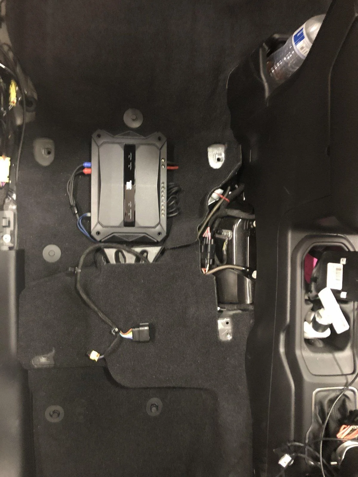

Amp under the passenger seat. Ran power, ground, RCA, Speaker wire under the carpet, cut a hole, and tied it all in. Extra wires tied up under the passenger's seat. Ran RCA from Pac Amp to rear sub, down the entire passenger side, under the carpet, and popped it out near the distribution block.

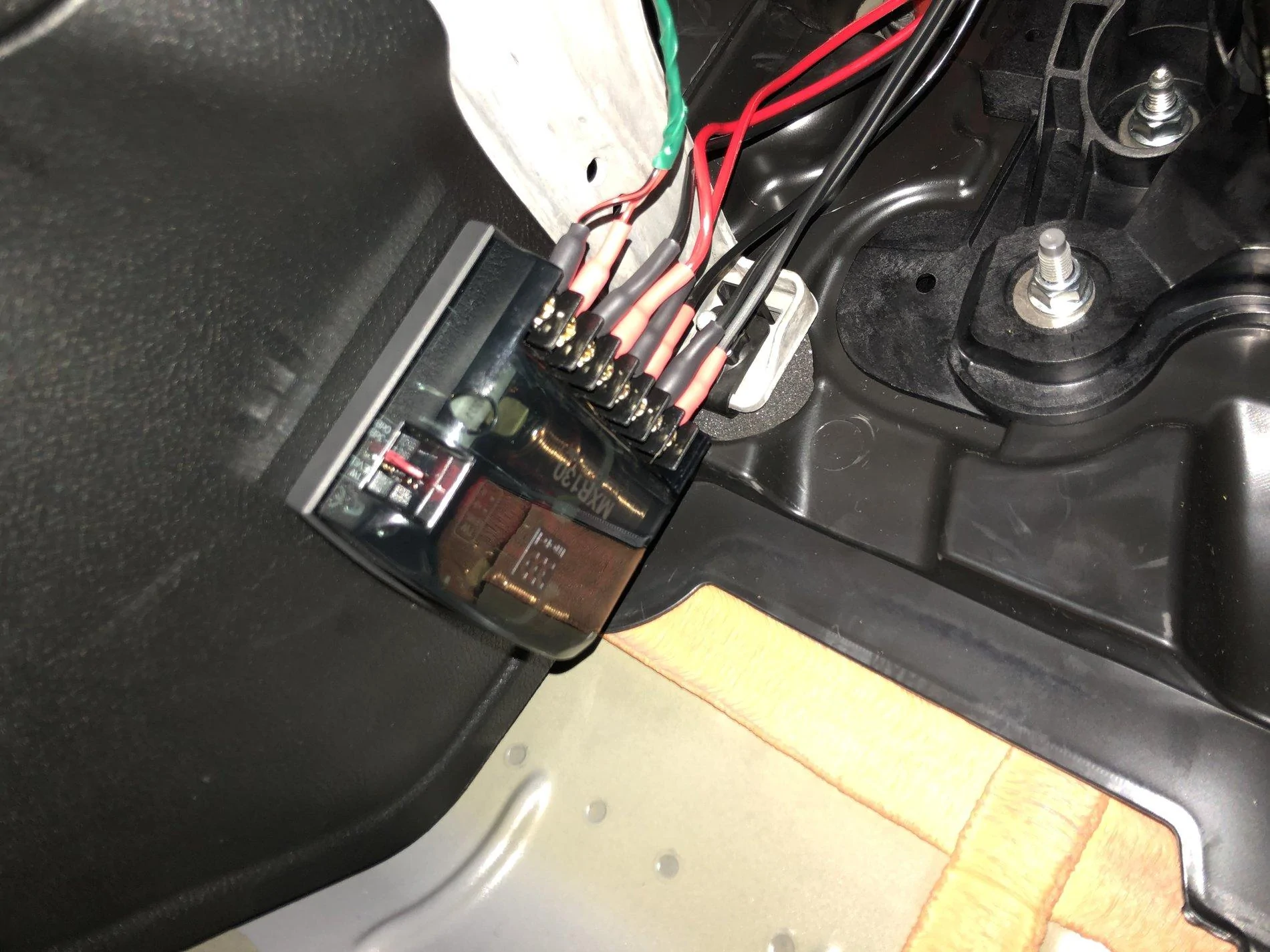

I mounted the 3-Way crossovers on the kick panel as far up the footwell as possible, zip-tied wires to the Metra pod on the driver's side. Zip-tied all speaker wire coming down from the passenger side to the amp. There is a significant gap in the side panel that allows you to pull your wires the amp without the worry of crimping or being cut.
