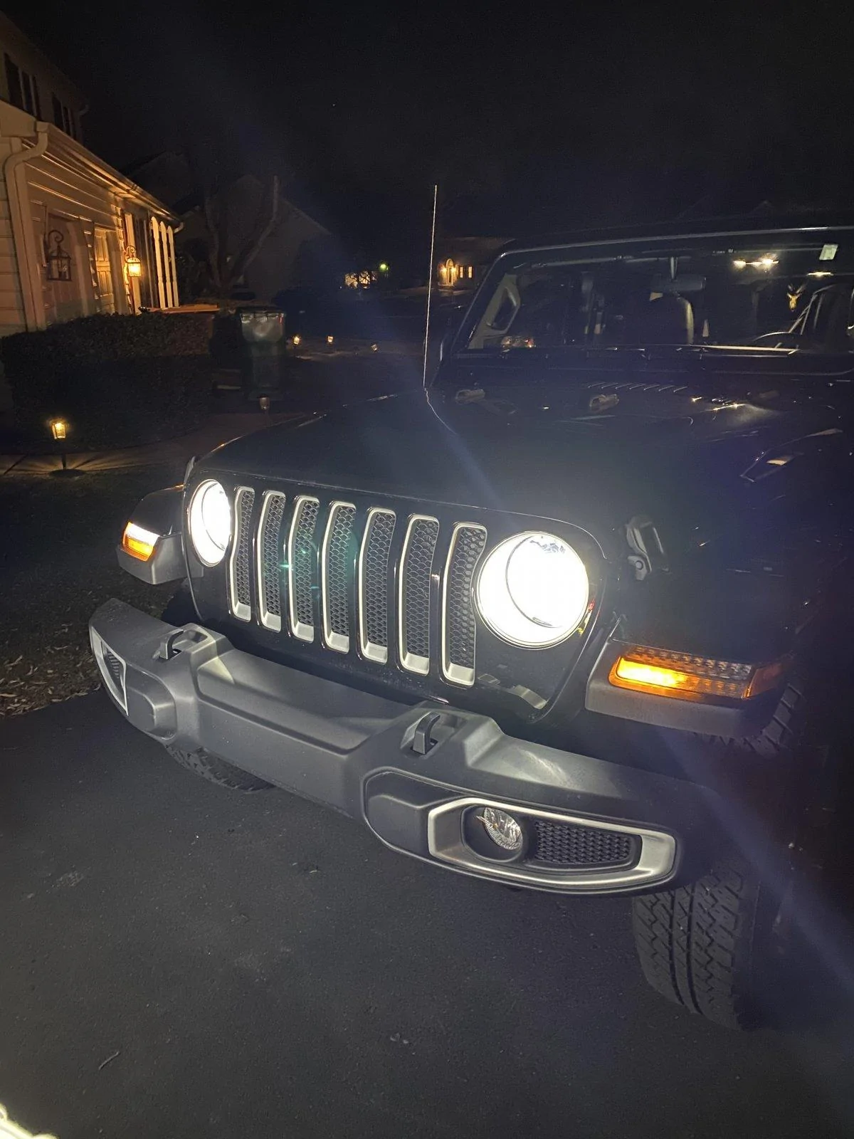

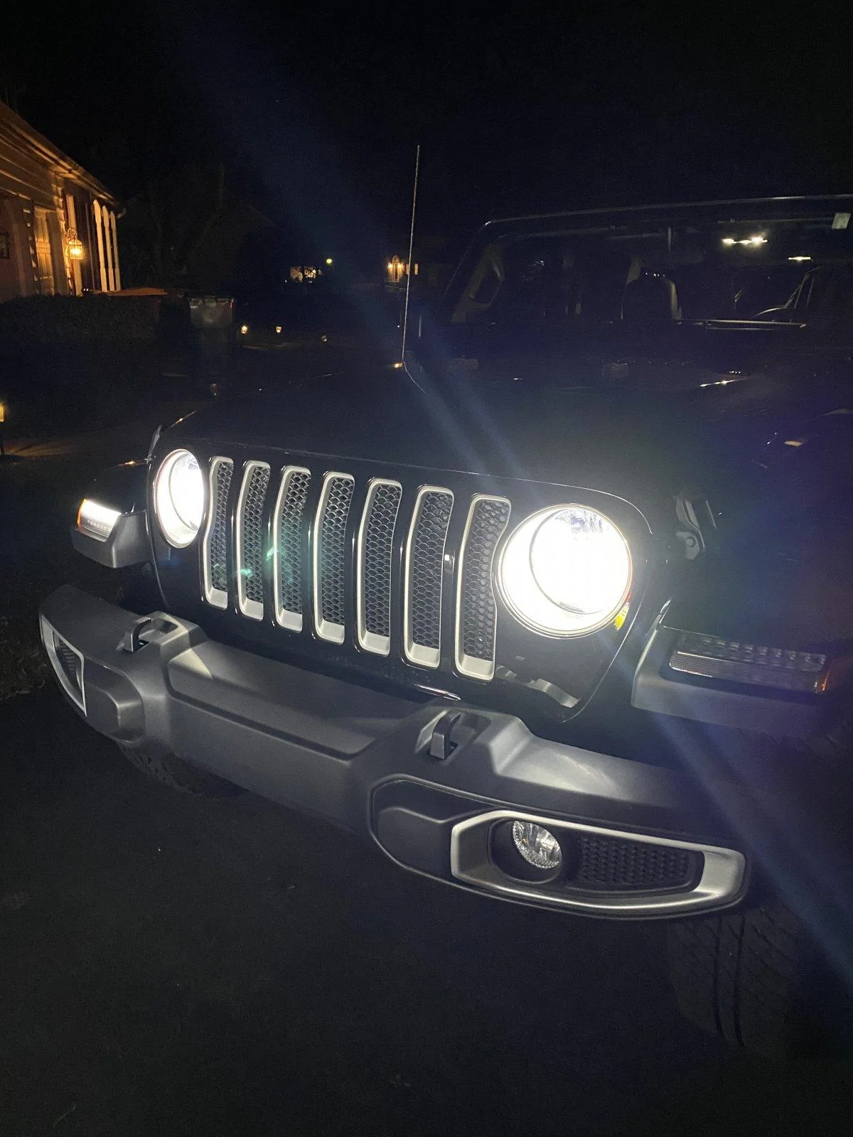

Hello All,
I installed the Quake Fender DRL LEDs on my 2021 JLU Sahara non-LED.
I’m getting some weird behavior where the driver’s side DRL illuminates only with the lights in the Parking Lights position.
Each setting on the headlights:
Lights Off, in Drive with e-brake off - drIver side DRL doesn’t work
Parking Lights - Driver side DRL works
On - Driver side DRL doesn’t work
Auto - Driver side DRL doesn’t work
The amber side marker on the driver side matches above (only works with parking lights on). But the turn signal and hazard light on drivers side work.
All passenger side functions of the DRL work as expected.
Also, this is the second quake DRL on the driver side. I exchanged the first one but the replacement has the same issue).
Lastly there are no error messages and these are marketed to not require any flashing.
Could water ingress at the connector cause something like this (the harness connection is directly under the seam where fender meets the body)? Are there different fuses for each light setting? Could I have connected the harness backwards, is that even possible?!
