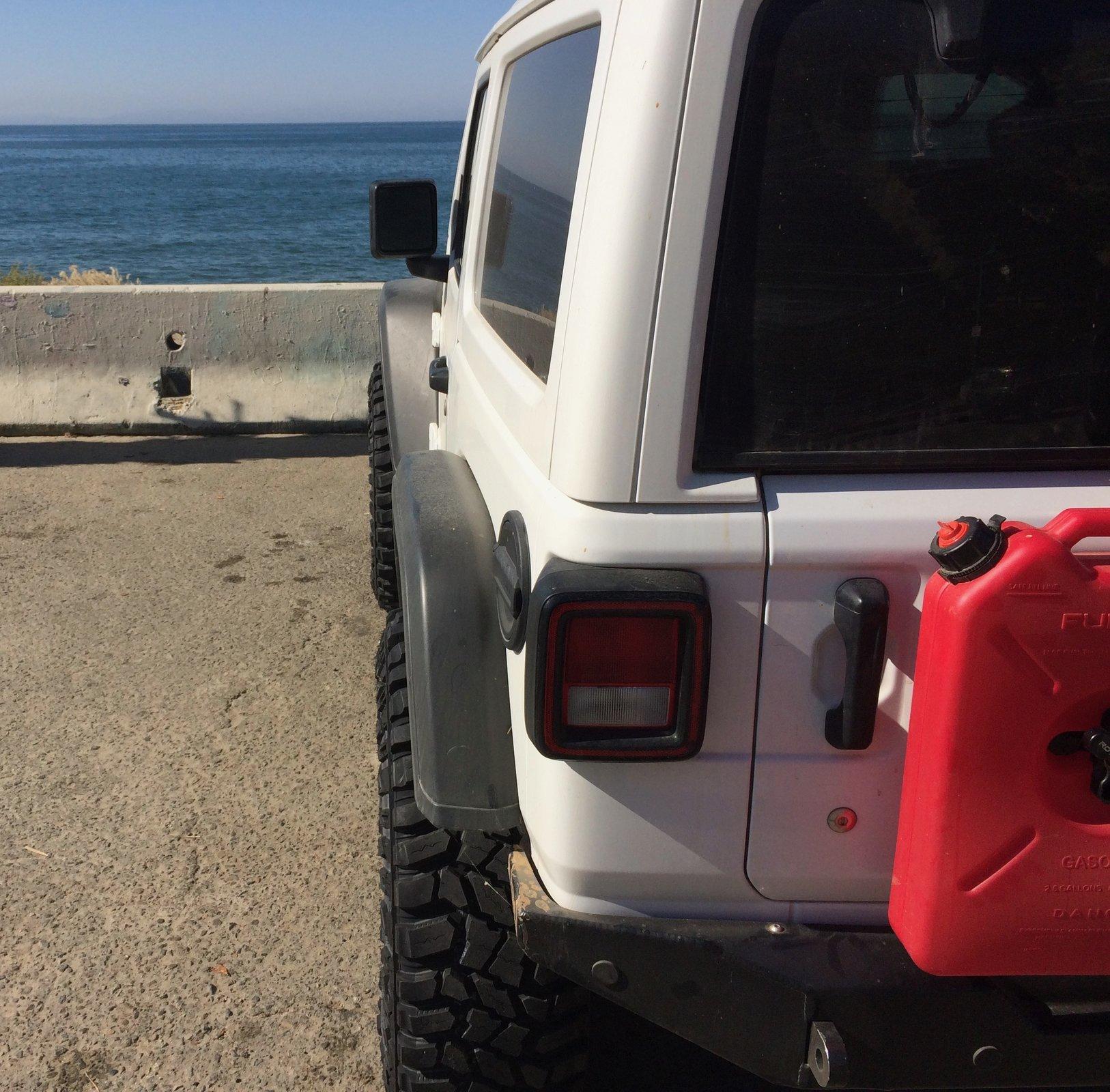

here is the tire stick out with a 12.5 width Cooper Pro, AEV JL Pintler 8.5 wide wheel. If I remember correctly this wheel is 5.77 BS +25 offset. Calculator below says this combo sticks out 1.5" more than stock.
I believe the stock JL wheel has a +44.5 offset. Calculator below should give you an idea as to how the wheel/tire combo you choose will change.
https://tiresize.com/wheel-offset-calculator/
Should be a good plan w/ stock suspension, as you go up in lift you have to go less positive on the offset. That 8.5 +25 is a nice fit on the Stock Rubicon running 315/70s, might have to go to offsets in the +10 range if you go up 1.5" lift, and a zero offset if you go to a 2.5".

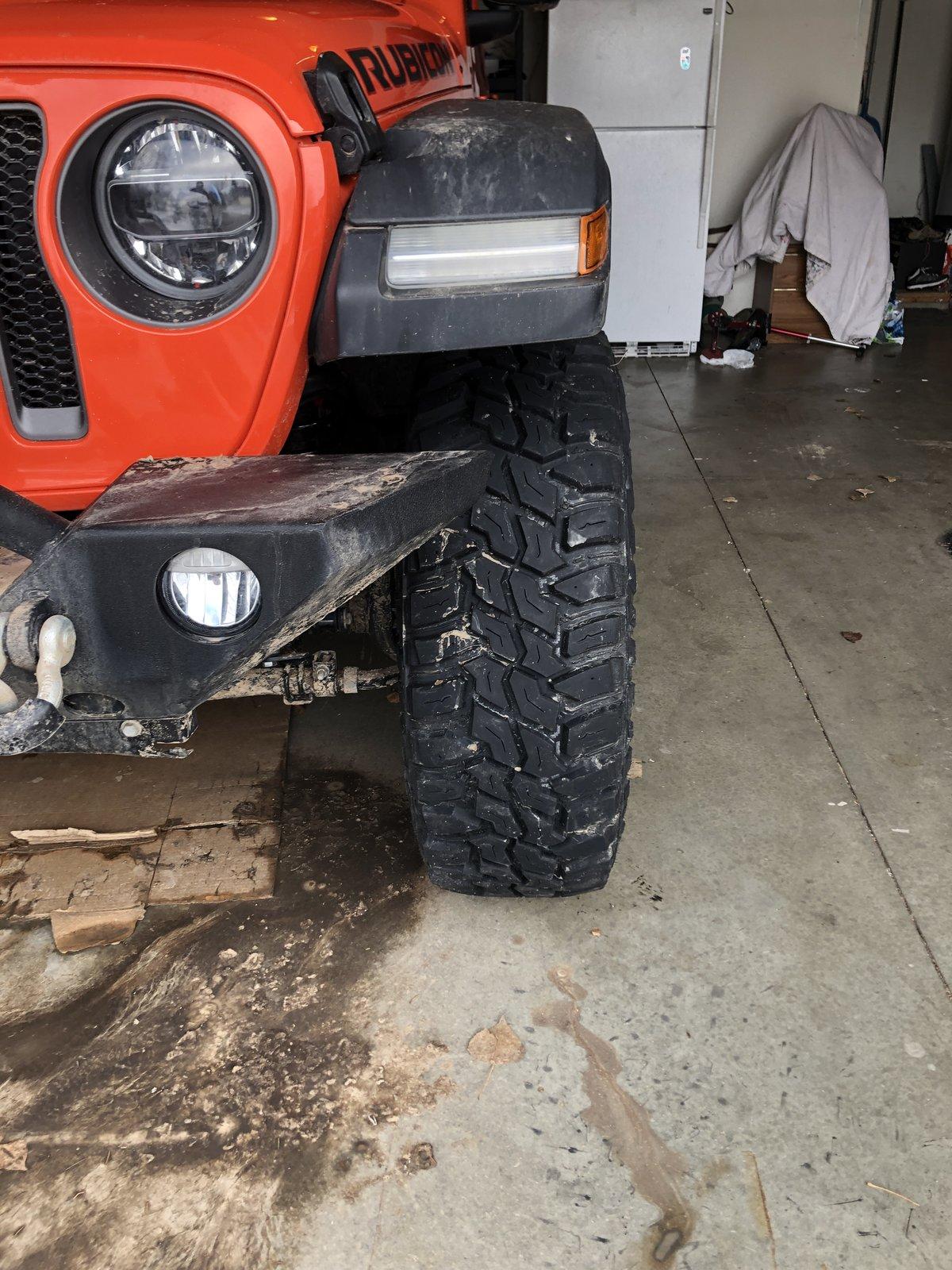

17x9 +12 offset with 12.5 wide tires
Don’t mind the messy garage.

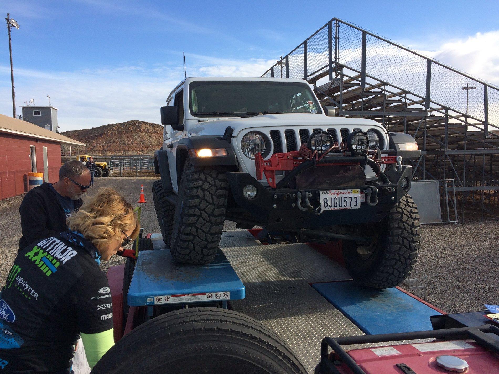

AEV spec’d their JL wheels with +25 offset. Give them a call and ask one of their wheel techs about fitment.
Jeep Wrangler JL Way too confused on backspacing! MC flex trailer 1
Jeep Wrangler JL Way too confused on backspacing! Mopar lift flex
+25 works on my JLR with a Mopar lift and 37’s. AEV can tell you about your tire choice.
