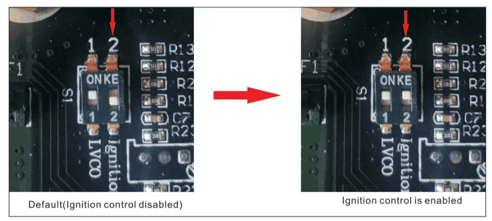

Just installed a voswitch jl400.
Power and ground are plugged in, but won't turn on in acc/on/engine running.
Why isn't it powering on? What did I miss?

Did you confirm the trigger mode dip switch is off?

Jesus that worked! Thanks!
That switch is super tiny haha! My eyes aren't what they uses to be.
