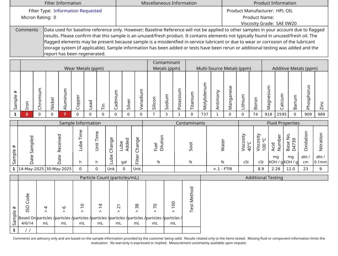

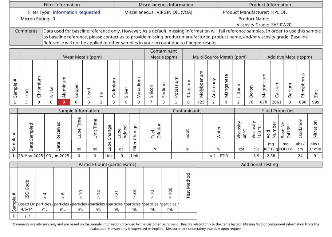

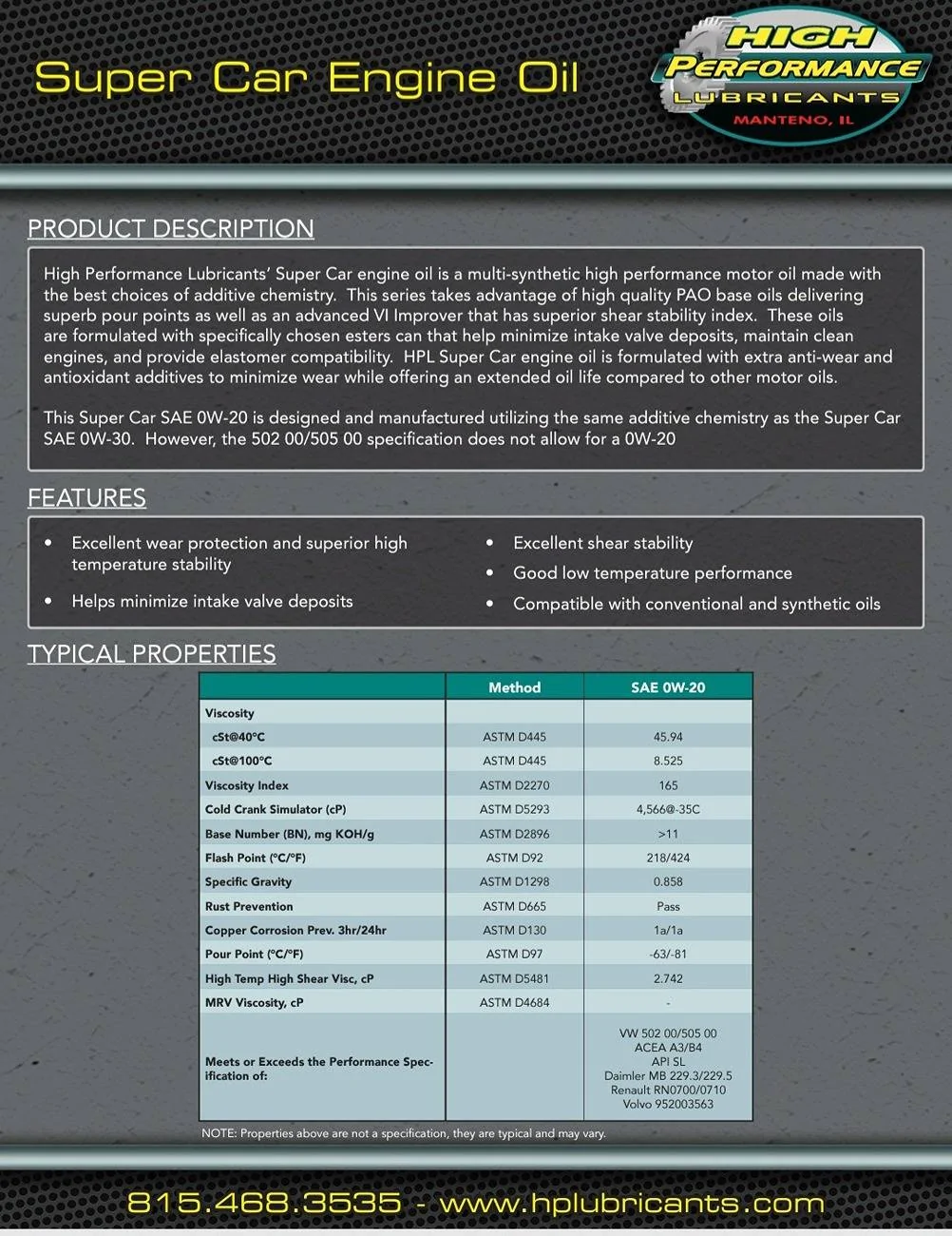

Guys, just remember one thing. This HPL oil has fancy and crazy Viscosity Improvers that don't shear. So what happens is that instead of the viscosity of 8.9 going down, it goes up. It is the opposite of other oils. By the time you hit 5000 miles, viscosity will be 9.3, and by the time you hit 10,000, this oil will become a 10.5 cSt 0W-30. The thing doesn't shear whatsoever.
I did this VOA a week ago.
I thought UPS lost my package so I received a replacement kit that I sent another sample with, so they did VOA on two seperate samples. So this is a super accurate VOA.
If I tell you the pour point of this oil, it will blow your mind. -63 degrees C or -81 degrees F
It is a 100% PAO/Ester based true synthetic oil.
