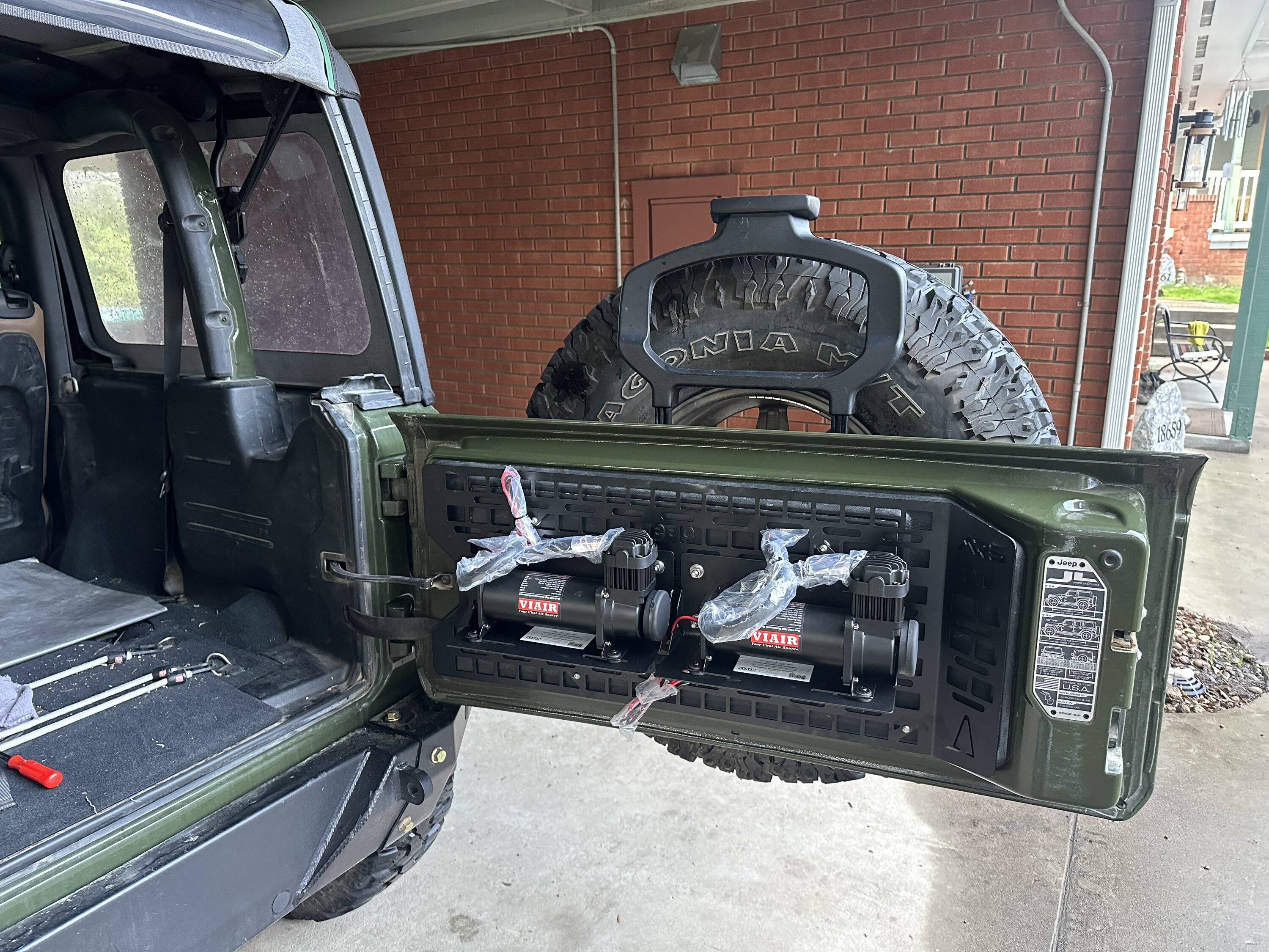

Figured I’d share what I’m installing. I haven’t seen much out there for Viair install options. So I made up my own. Decided to go with a Molly panel from MetalCloak and attached to that. Still need to wire to the Aux 1 and Aux 2 switch. I Happy with how it looks and where it’s sitting. Space is a premium in the 2 door. Almost mounted them to the roll bars.

Where did you get the brackets to attach to the Molle panel? Working on this project right now.

Right on. I have since ordered some dc, weatherproof, quick plug connectors and some T-handle bolts to secure the entire thing to the tailgate with instead of what’s included with the Molly panel. This way I can quickly remove the whole set up for more storage when needed. I haven’t needed the space so I haven’t changed over this new hardware yet. Enjoy the onboard air. I’m loving mine.
