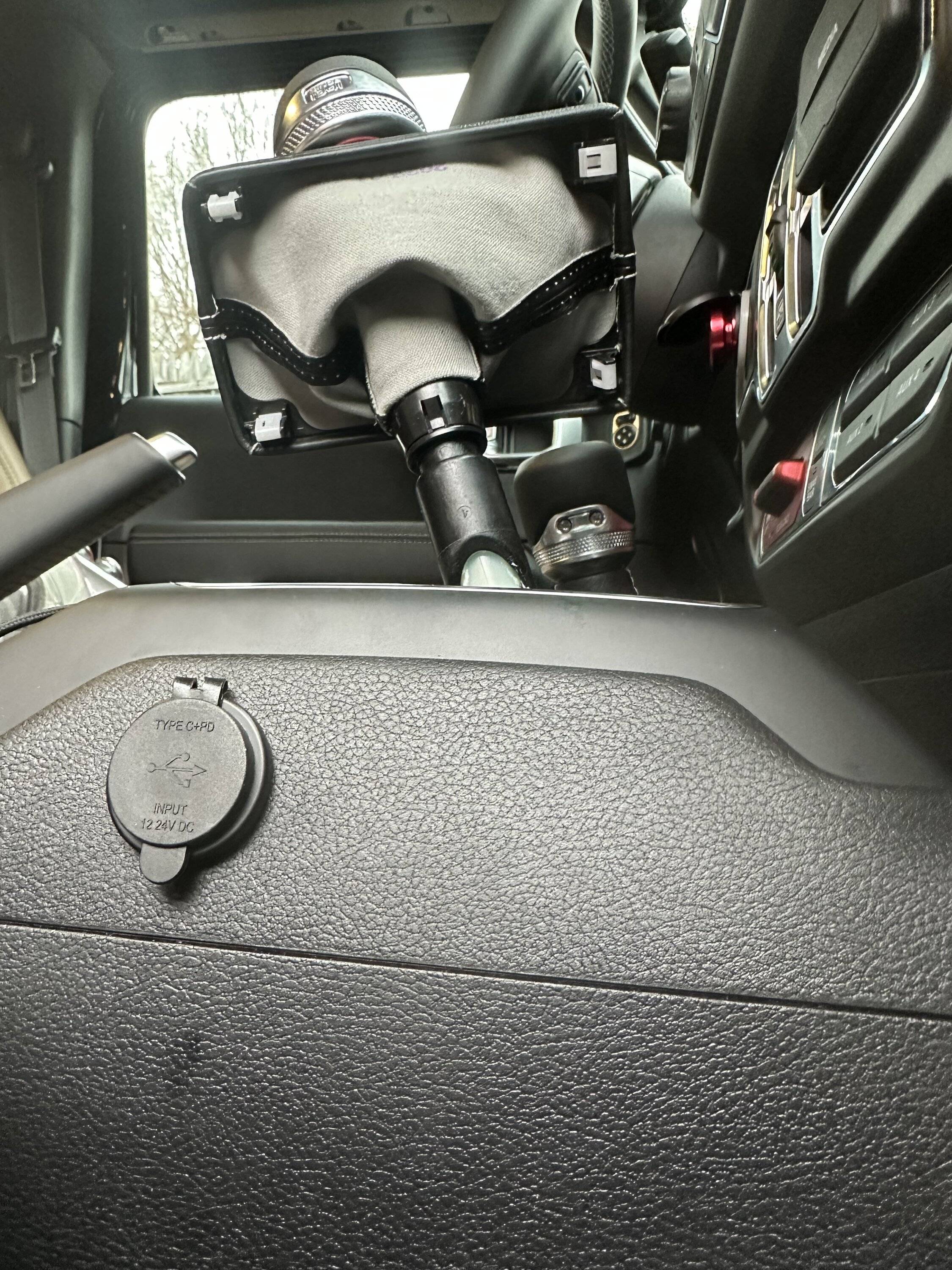

Has anyone found a good place to add a cigarette-lighter sized USB outlet in the dash? These things are a bit deep, so they require space of around two inches behind the flush mount. Right now I'm fishing around on the passenger side of the center console near the stick (It's a manual), but space looks to be tight there.
I actually wired up the thing and then found that where I wanted to put it probably wouldn't fit -- luckily, it was before I drilled the hole. So now this thing is sitting in the glove box, which may become its permanent home if I can't find a better spot.
I'm trying to avoid the tray by the windshield, because I don't want wires sticking up there.

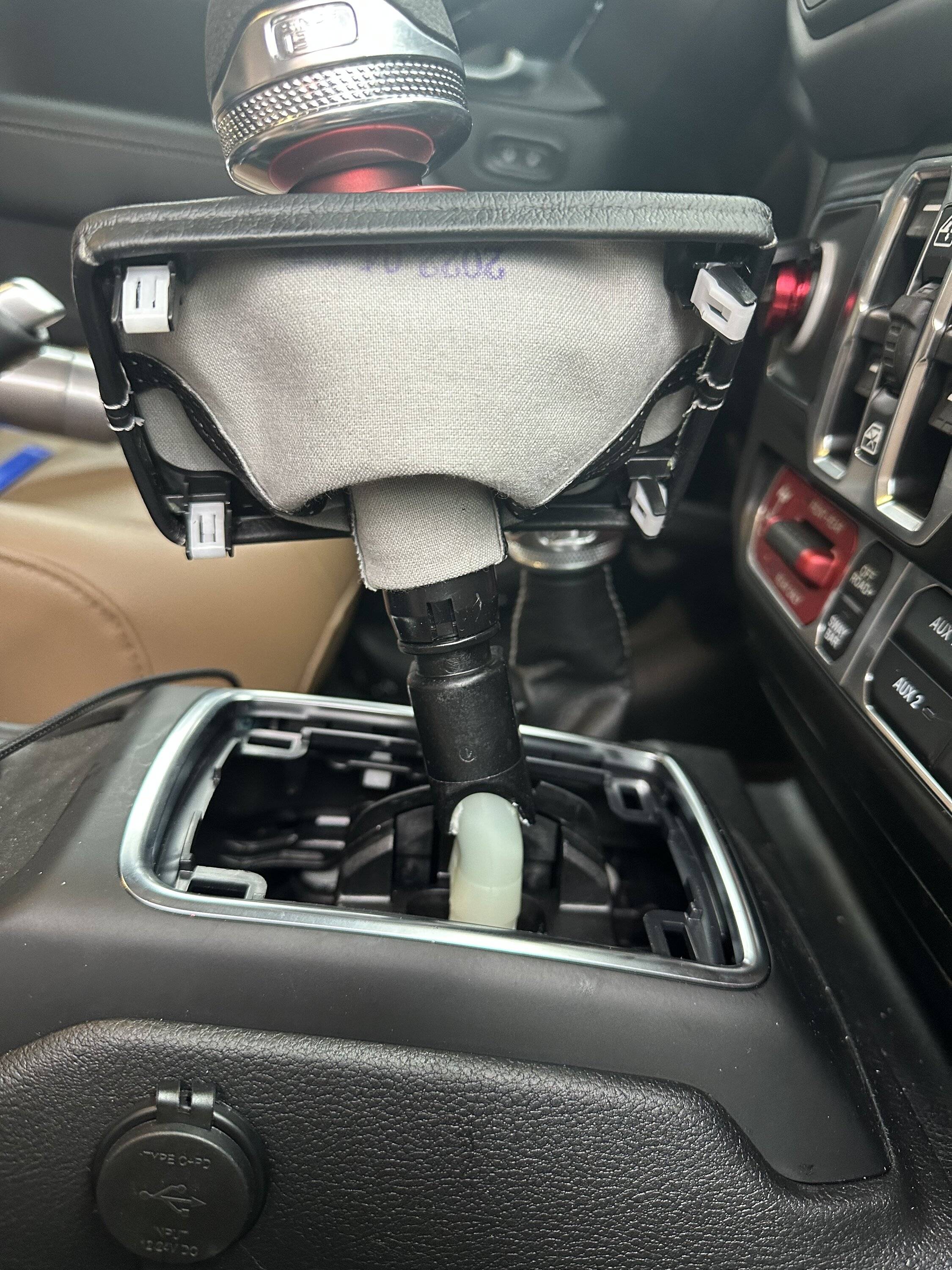

I need high-wattage charging for my wife's phone, tablet, etc. (Ok, for mine too.) The thing is wired and working. But I can't figure out a space to put it. I'm planning to pop off the boot for the stick to see what will *really* fit there (to its right or left), but I'm also looking for other options. I had hoped the corner of the front stack (to the right of the climate controls) would work, but that area is shallow.

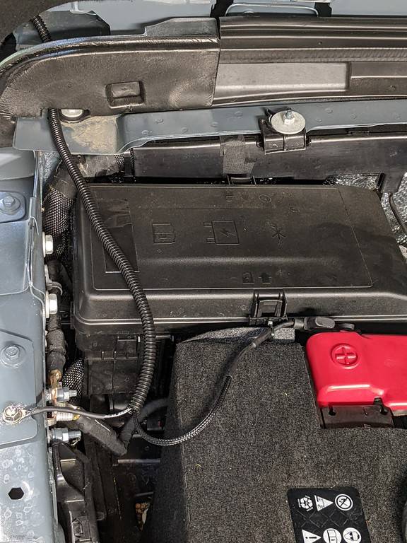

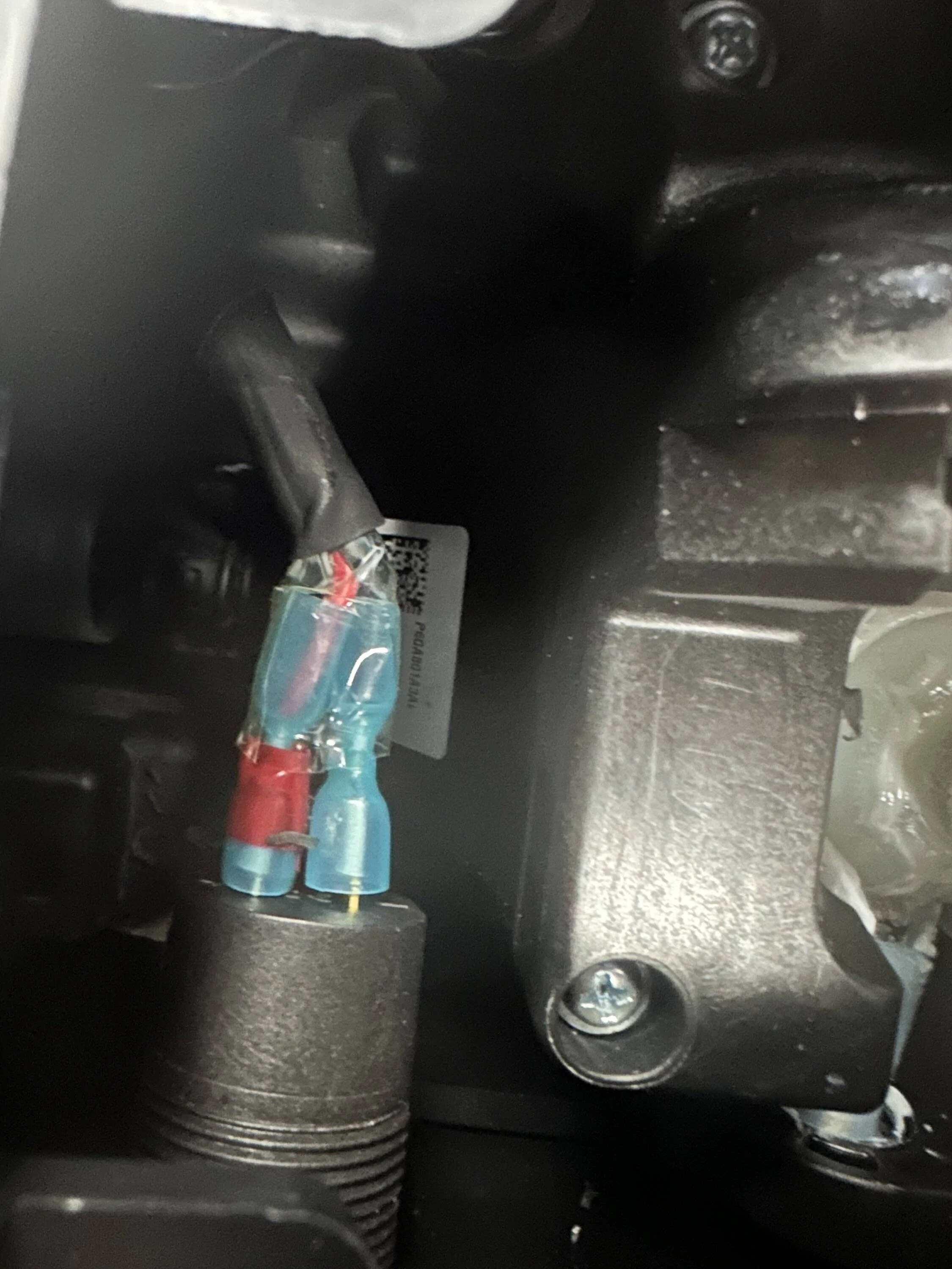

What power did you tap into to provide power to your USB? I'm doing the same thing and initially I planned to use the USB in the console to power it but apparently that only provides 5V, not 12+ needed.

Thanks. I ended up gong right to battery (with a fuse) to provide power all the time.

Outlet is installed "upside down" so the lid flips down, and because the orientation of the USBs is wrong if they are installed the other way (IMO, since other outlets are flipped).
Just a note: USB-C doesn’t have a right side up, so it can’t be “wrong.” The writing is upside down, but the flap isn’t connected to the rest of the thing, so you can orient that however you want. I wanted it to flip down, because that was the wires that get plugged into it can be routed up,, which is away from the lid. I never plug in anything that ends up on the floor.
