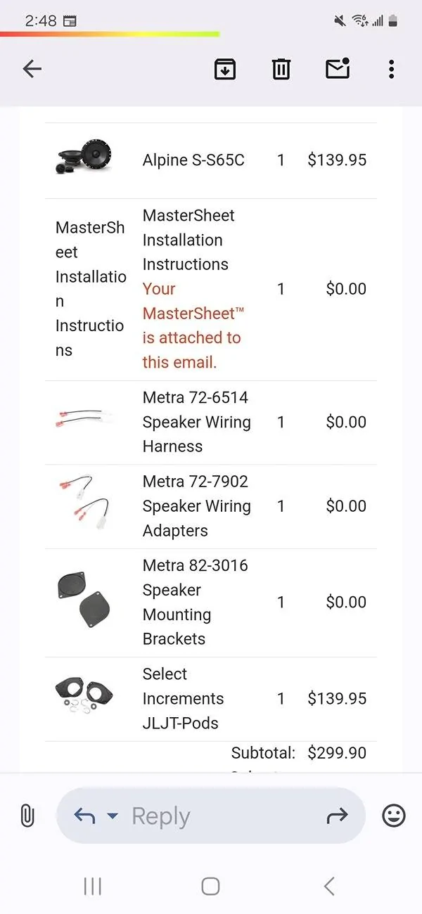

I have terra acoustics up front and this is what I did with my roll bar speakers. I'm very happy with the sound of this set up.

That receipt looks like Crutchfield?
Correct. I think I got the speaker grills from Amazon tho

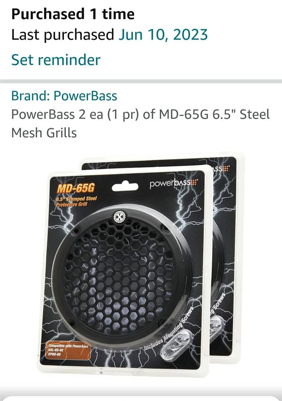

Jeep Wrangler JL Upgrade rollbar stock speakers? 1000018975
These are the grills I got. Another inmate posted them on their set up and I liked the look of them better than the fine mesh.

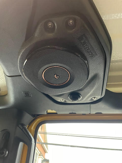

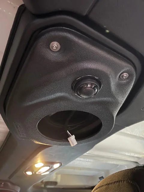

I've installed JLJT pods in my soundbar and installed Infinity Reference components. Tweeters take the wires for the smaller speaker, 6.5" speakers get the 4" wires. I also upgraded the upper dash speakers with Infinity's which took 5 minutes per side to change out.
I need to take the time and put the stock screws back in cos those silver ones stand out and look crap.
