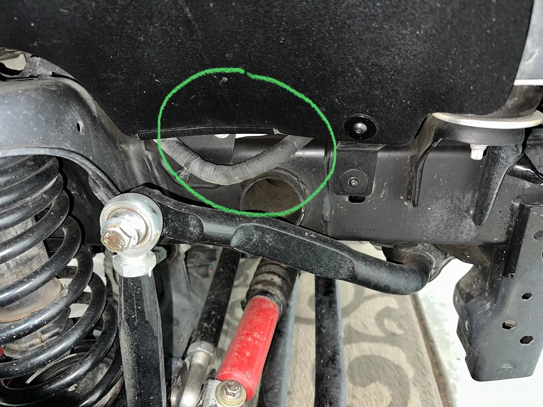

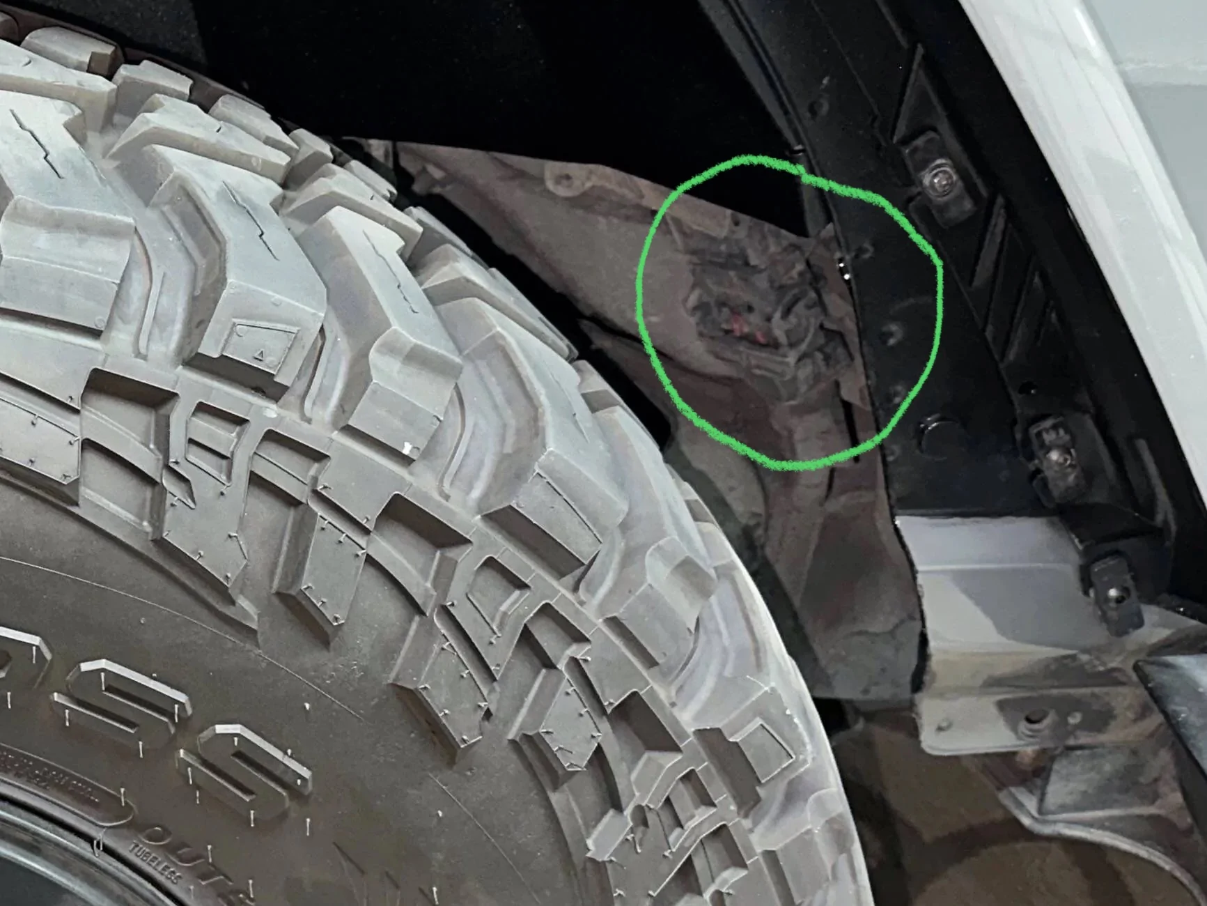

Do you mean the plug cluster in the lower front area in the passenger side rear wheel well? There’s also a main harness in the lower front area in the passenger side front wheel well.
Rear

Front
Jeep Wrangler JL Unidentified Plug IMG_4255
Rear
Yes pic 1, passenger side rear wheel well. Could the tpms module be plugged into that cluster?
Front

I don’t know but here are some wiring diagrams. The topology map of all the connectors in the second link makes it appear that it does.
https://www.jlwranglerforums.com/forum/threads/jeep-jl-wrangler-wiring-diagrams.19185/
https://www.jlwranglerforums.com/JL-Wiring-Diagrams/ENTIRE-VEHICLE-CONNECTOR-MAP.pdf
