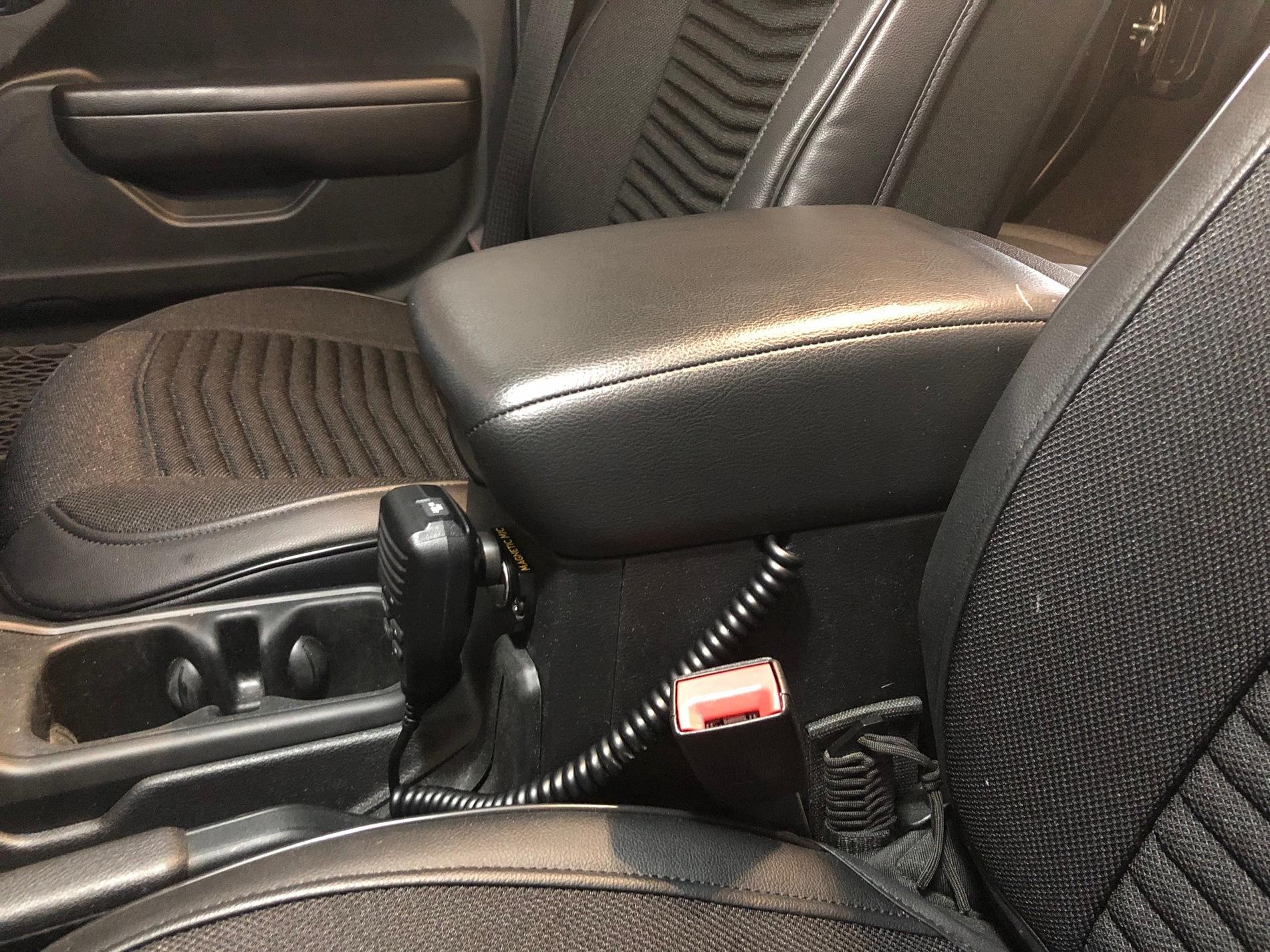

Finally completed my CMX-660 install.
Aux Audio runs under the center console and plugs into media center in dash.
I wanted to keep this as simple and out of site. I don't use it much, but when needed, it's there.

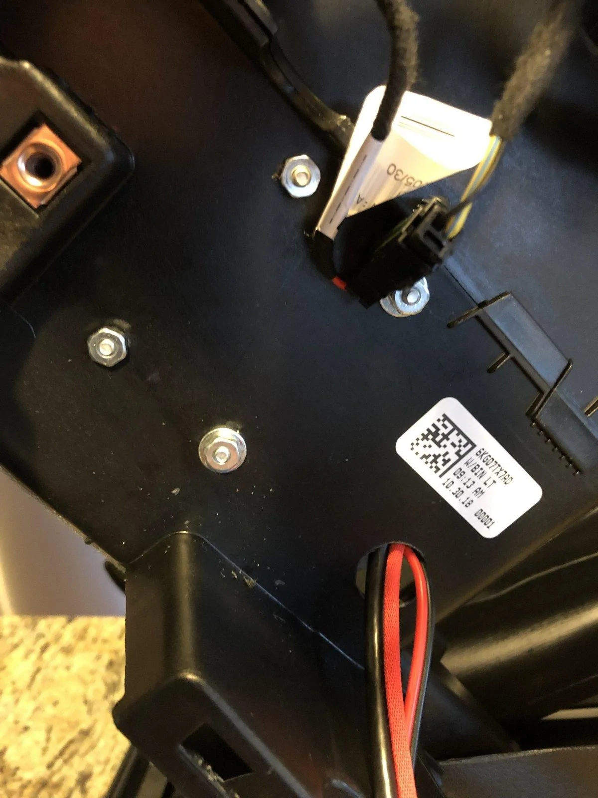

Taking the center console out of the vehicle was the easy part. Tearing it down sucked. Almost every screw had to come out to gain the access I wanted to mount the CB Mount Bracket. I also had to install a 90* Coax adapter to fit it in. It was a single ply of material at that point, and nothing went thru the outer shell so it's a clean look. The Coax is run under the carpet aft along passenger side to the drain plug in the rear. The PWR/GND are run forward along the console/under carpet. There is a ground stud at the base of the center pedestal, and the power wire is tied into the extra Ignition wire supplied with the Aux Switch Panel Option(or maybe these are standard?)

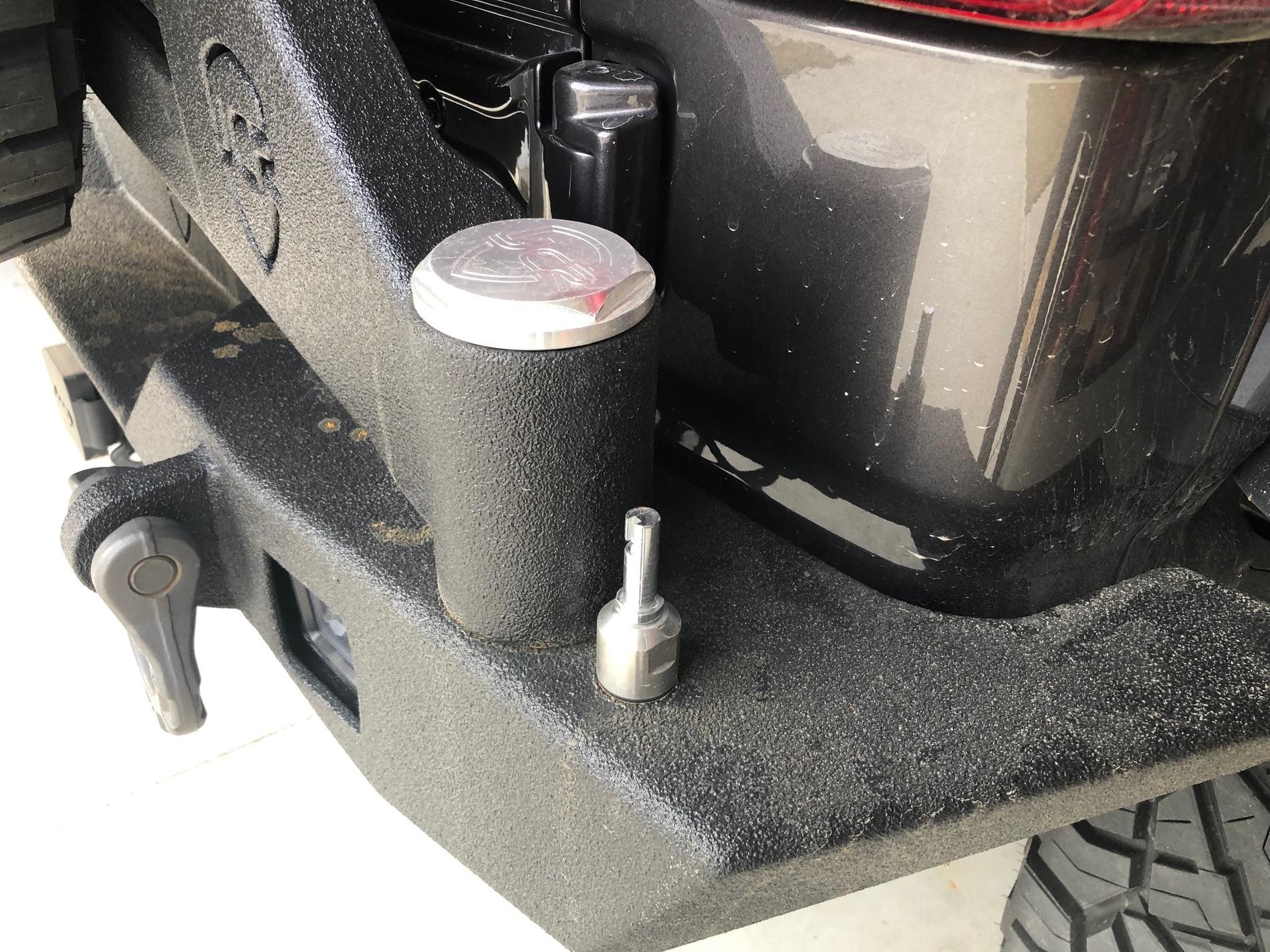

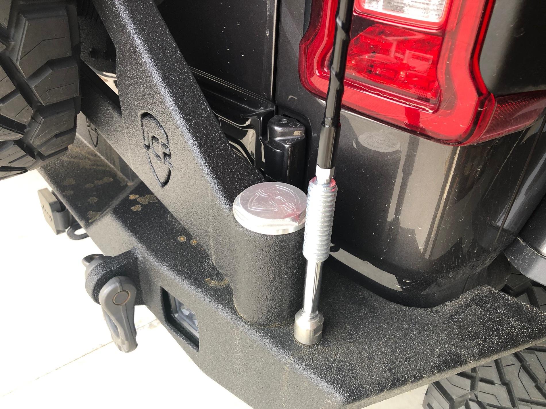

The Antenna was mounted to an existing hole in the JCR Bumper. Installed a heavy duty stud mount, quick release, and spring for the Firestik 4' antenna. Wishing I would have went 3' so I could leave it on to get it in the garage, but it will all be mute once the Rhino Rack is installed.
