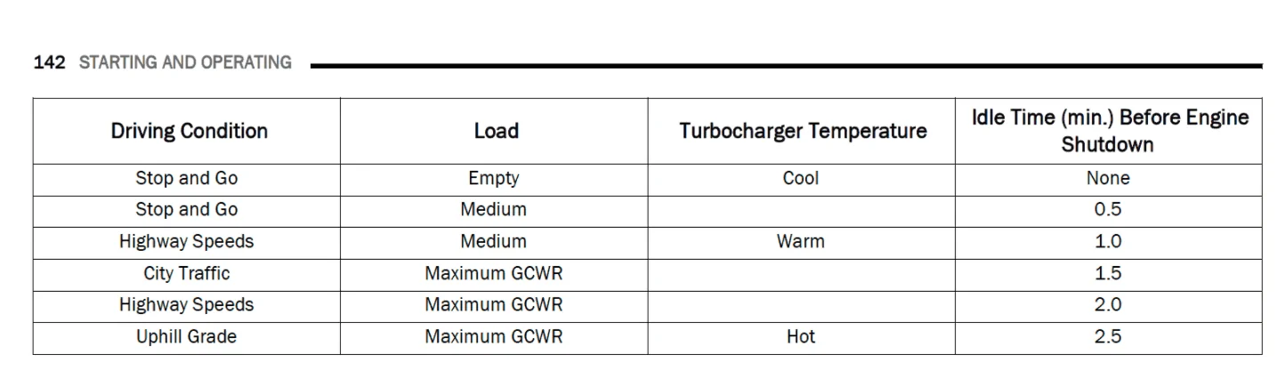

Get Scangauge, monitor regens and turbo temps.
In most cases, you would not need to idle more than 30 seconds on turbo temps.
Here is what the manual for Wrangler Ecodesel recommends.
Jeep Wrangler JL Turbo cool down time... 1649566507609
