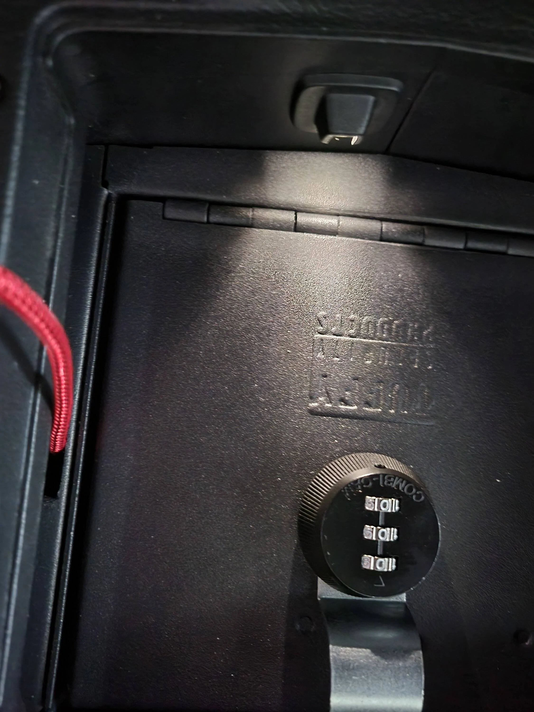

I cut a slot big enough for the usb end to fit thru.
Jeep Wrangler JL Tuffy Center Console 20220210_161021

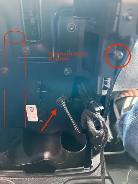

I think I figured out how to get my iPhone cable(s) out with our pinching them...
I removed the back of the center console (2 screws), took out the air ducts (2 screws), drilled a hole (I didn't really pay attention - but I think I used a 3/4" Spade Bit w/ 19mm Rubber Grommet) from the rear of console, into the interior of console. Passed 2 iPhone cables out the grommet and fished them down the console's duct bank to the "natural" exit point at the floor.
I will keep a 6' cord coiled at the passenger seat for charging use; and I am going to run a 10' (Anker + PowerLine II) under the center tunnel, into the glovebox, and behind the climate controls & display screen to the dash -- where I will exit with a similar hole/grommet for the Driver's side 67 Designs Phone Mount.
I know that people have had issues with the center console usb flaking out on CarPlay - but I haven't had an issue (yet) - so I am running the wire and hoping for the best. You'll only see the cable exposed at the mount - clean, clean, clean!
I probably won't get the cable hidden behind the dash for a little bit - but will continue to use the 10' cable and console usb with car play and see how things work.
Jeep Wrangler JL Tuffy Center Console Cable Exit
Jeep Wrangler JL Tuffy Center Console Drill Hol
Jeep Wrangler JL Tuffy Center Console Inside Pic
Jeep Wrangler JL Tuffy Center Console Remove Back of Console
