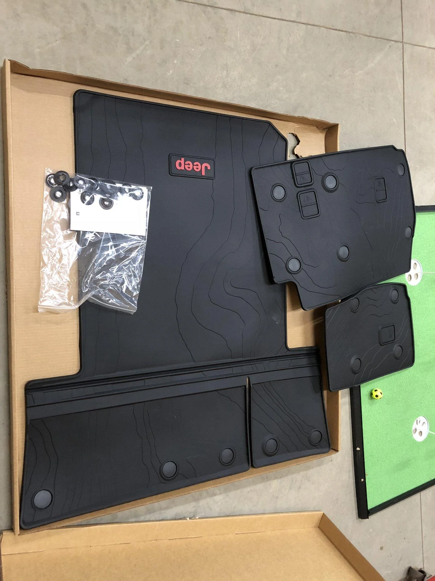

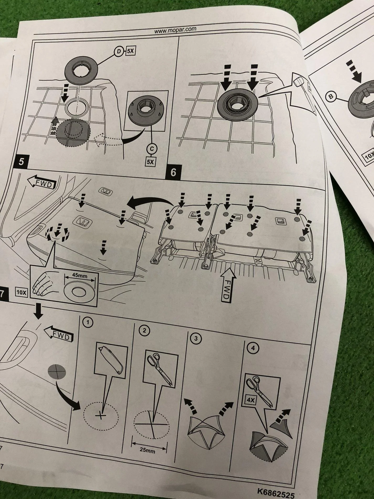

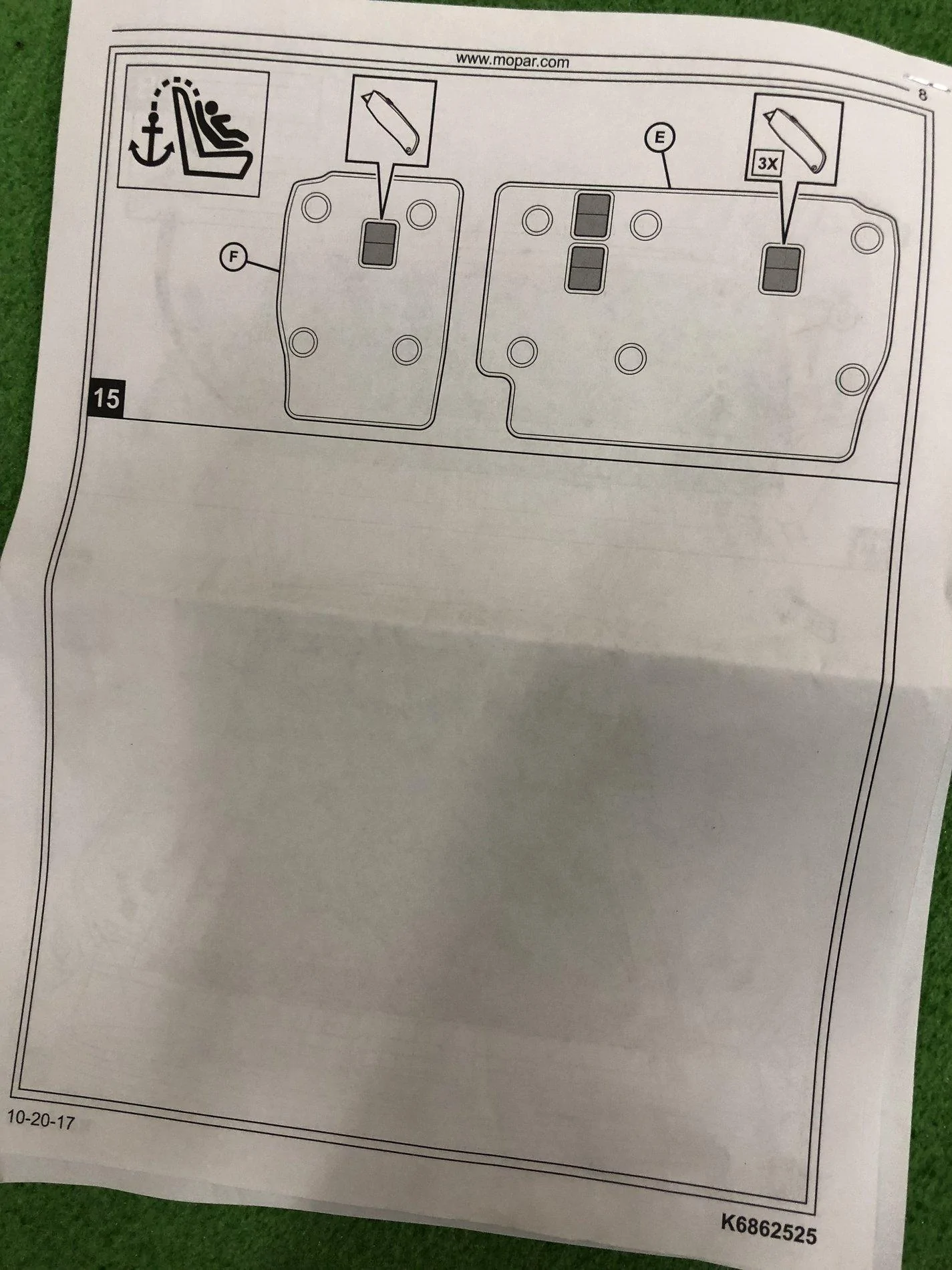

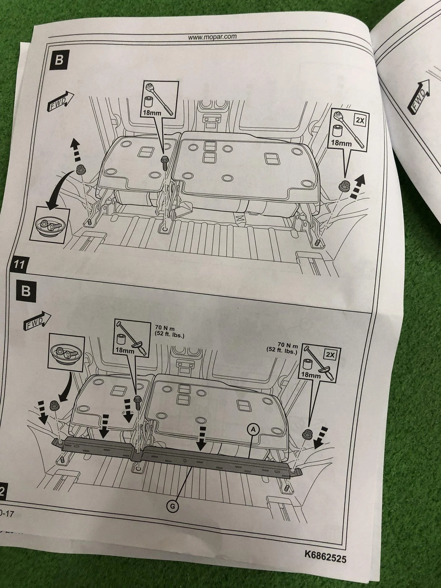

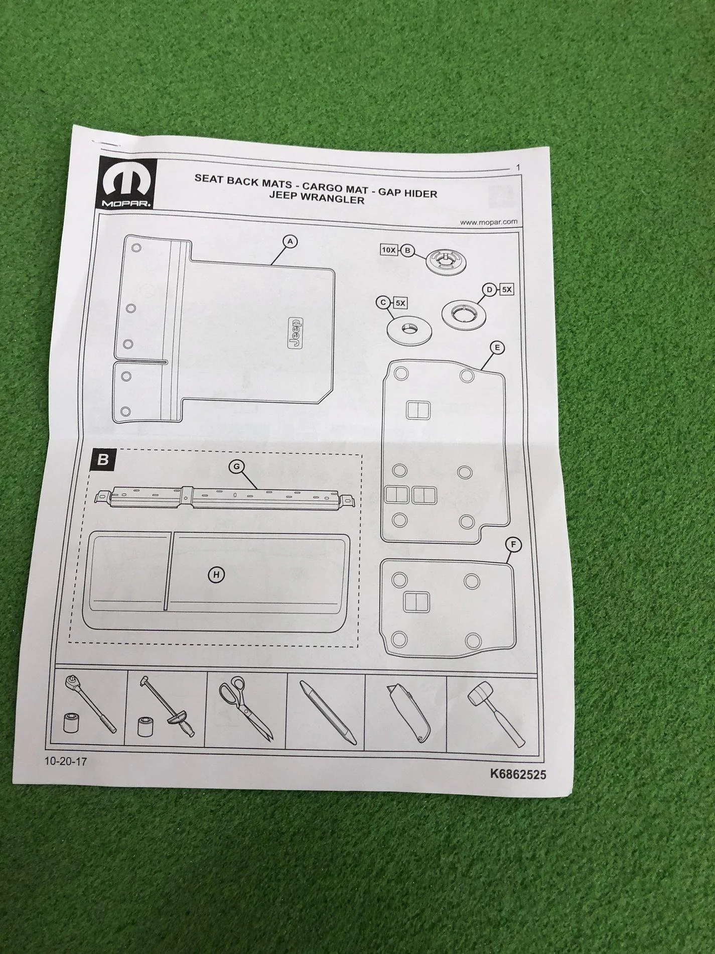

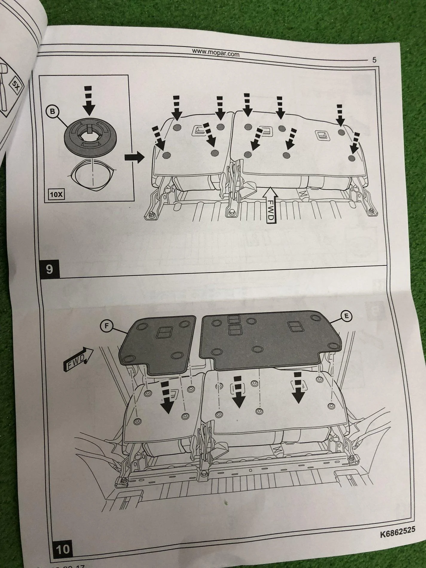

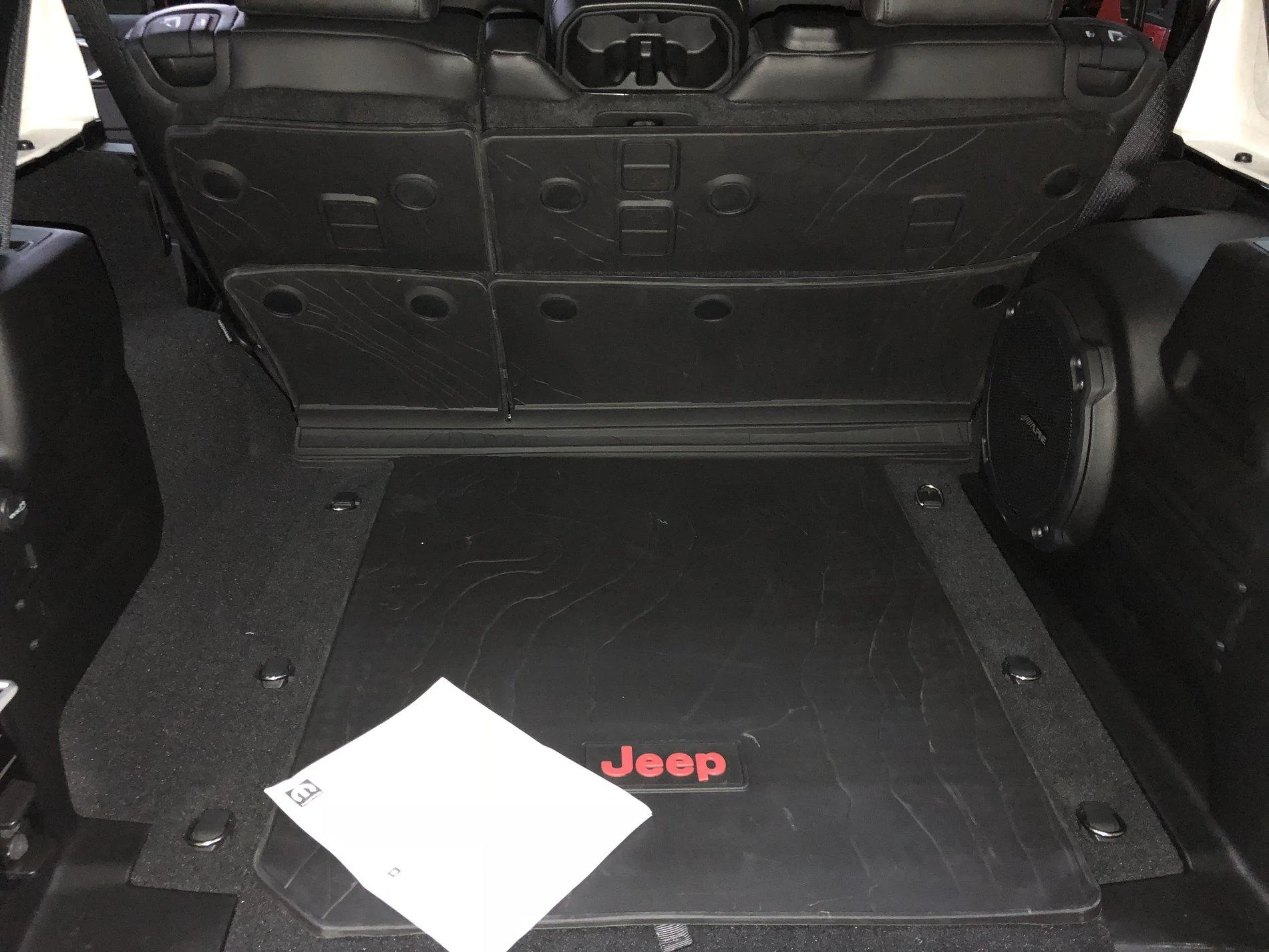

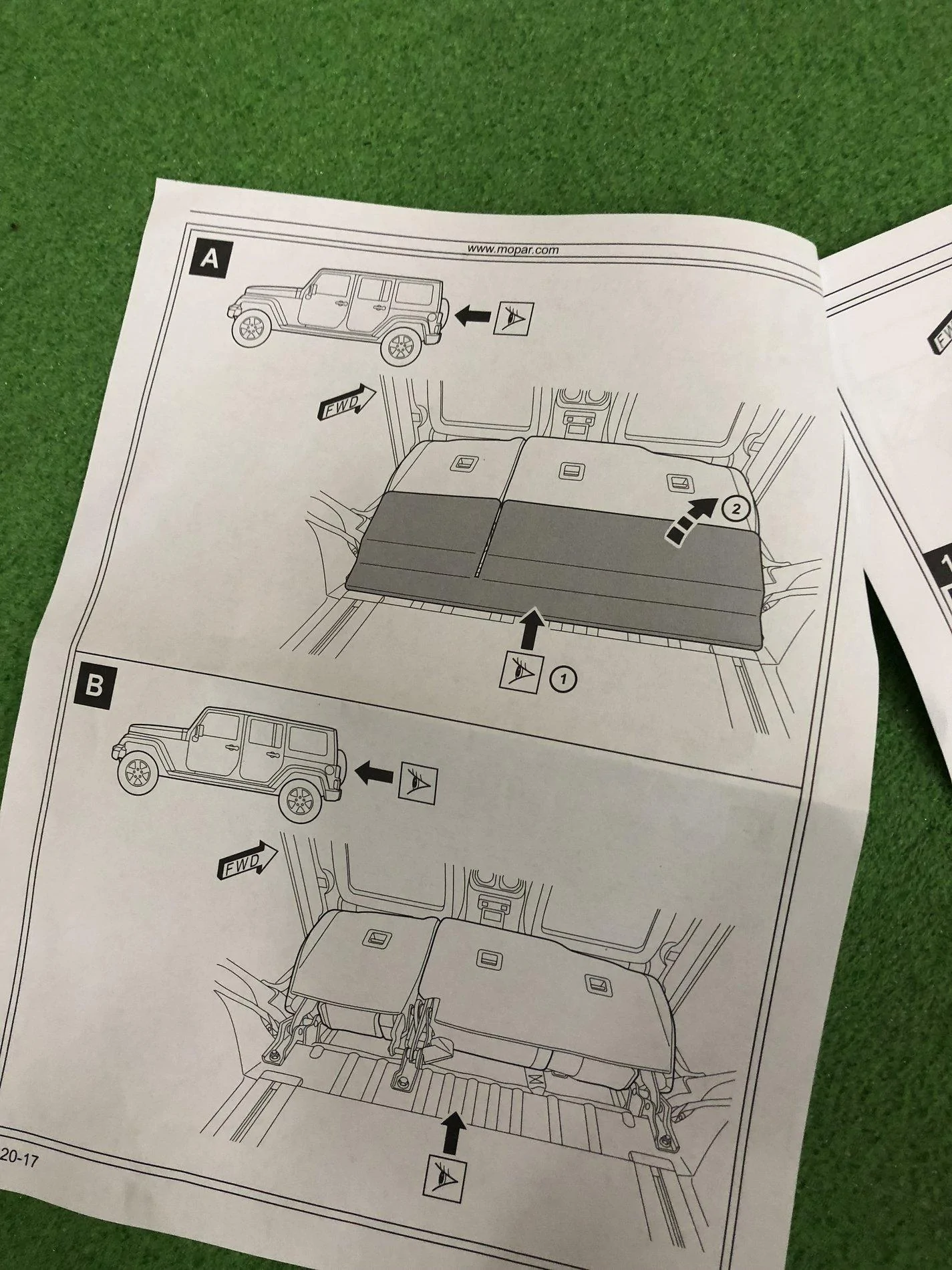

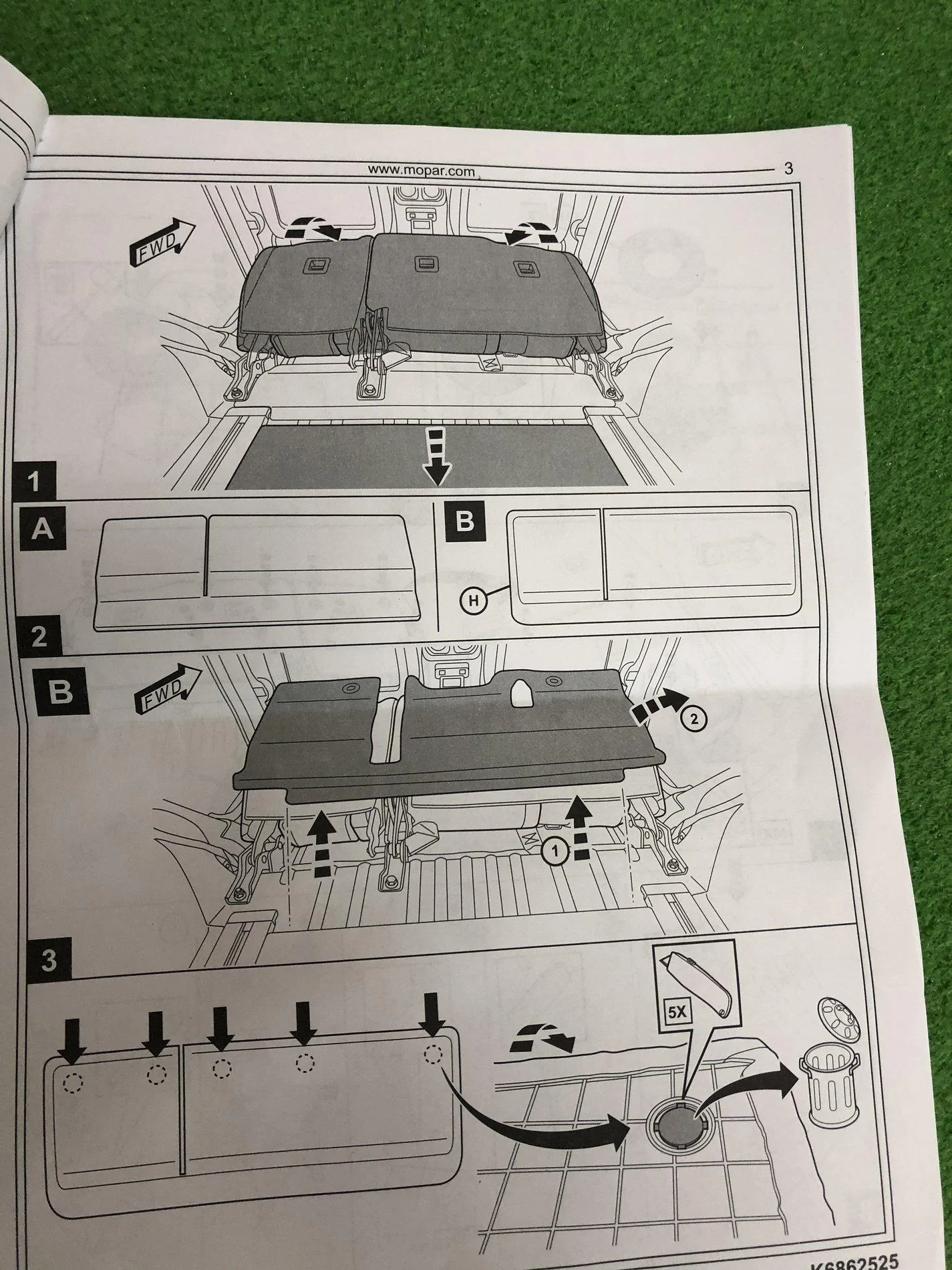

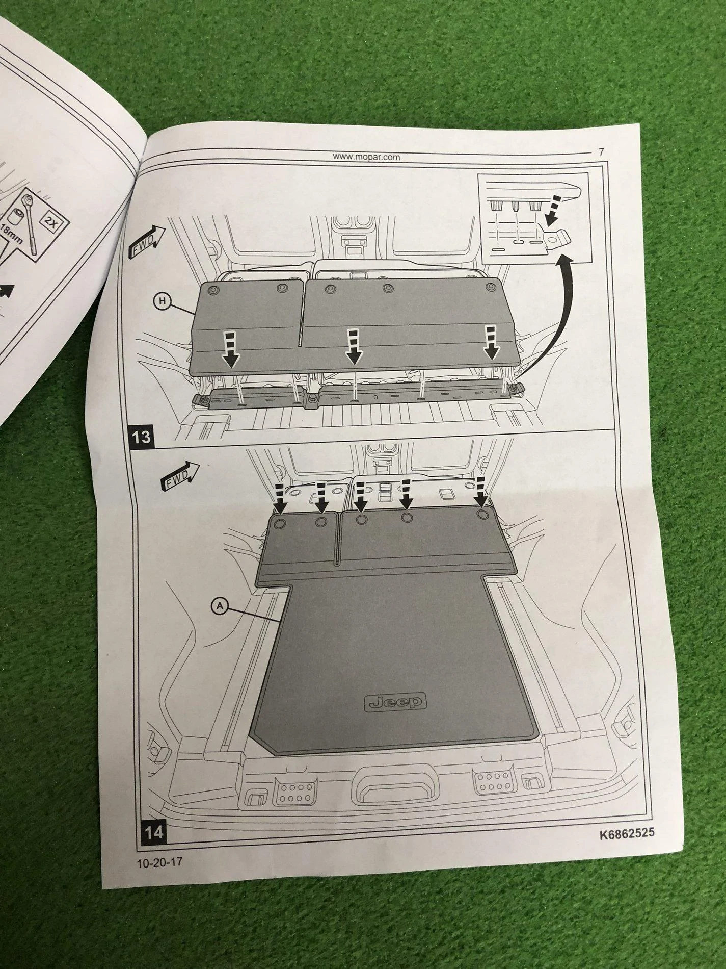

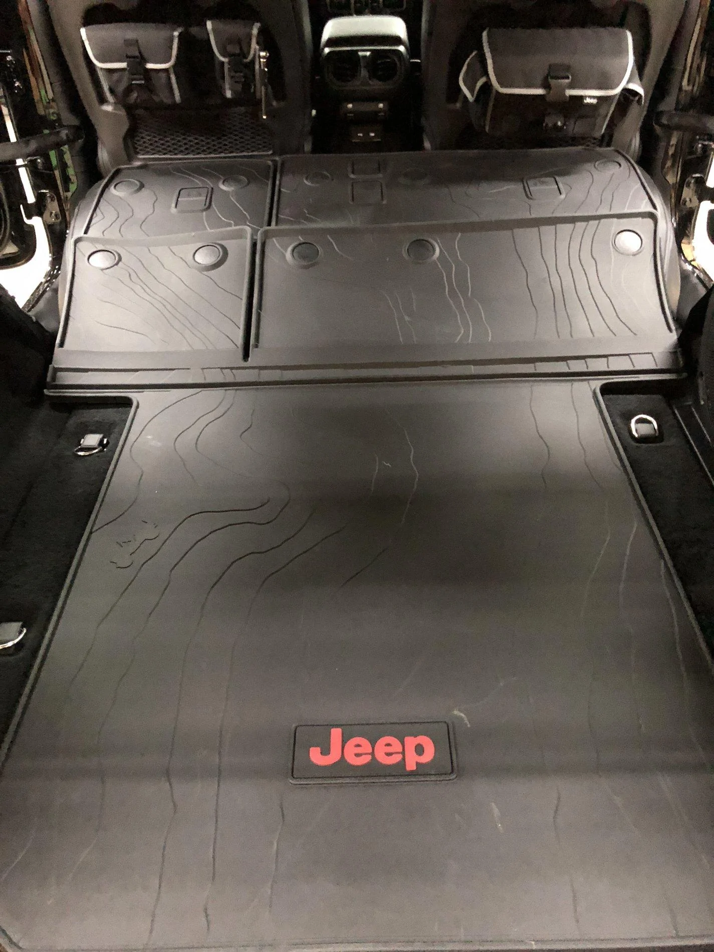

Here you go. Good and bad. Covers rear seat. Requires cutting on your rear seats. Not a quick install. Directions look a little different than what I got. I’m didn’t get the part G, but it doesn’t look like you really need it. It would be nice if the directions were more than pictures.

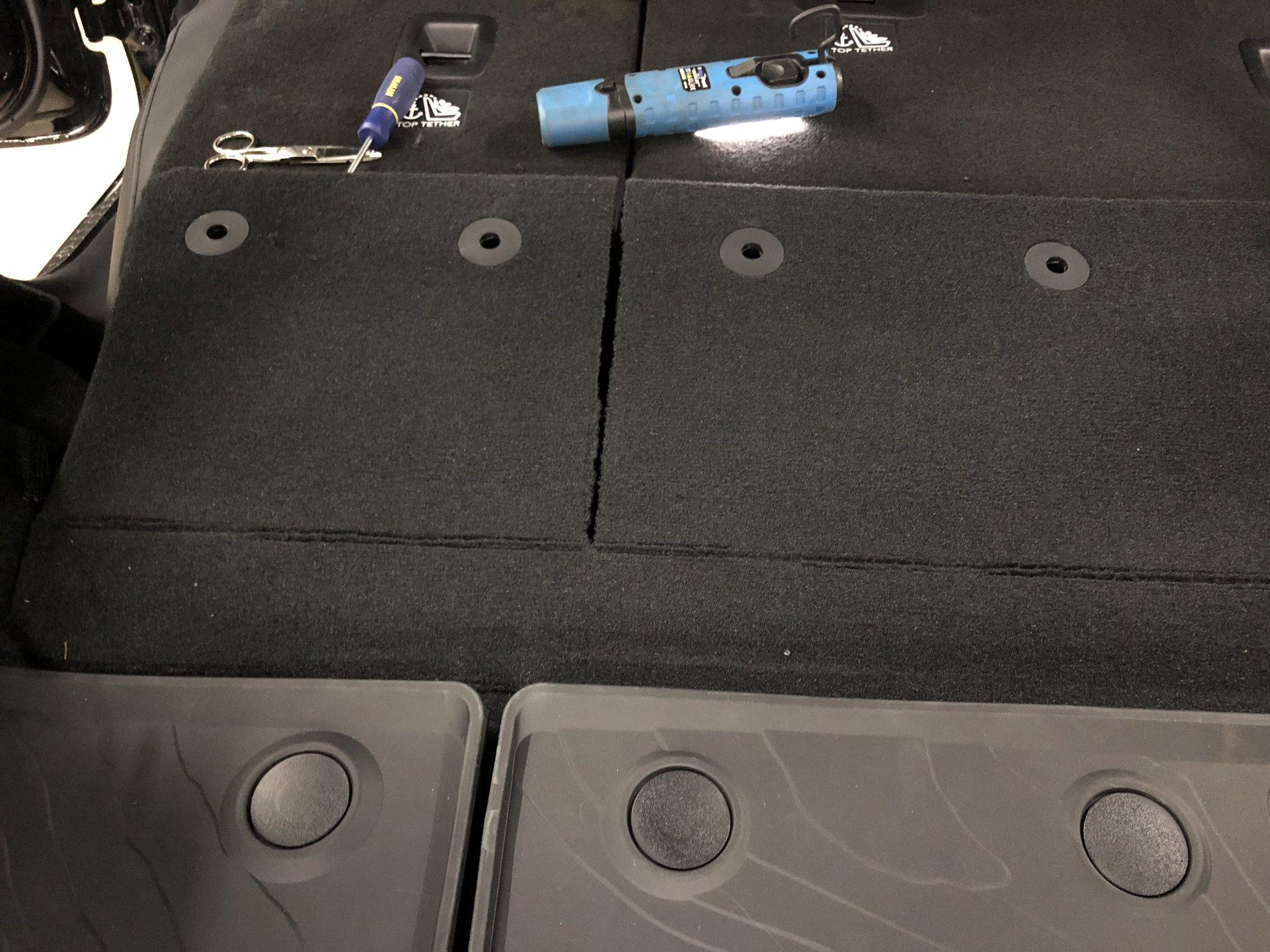

The gap hider is what appears to be missing, but the existing has the holes to attach the mat. I need to study this a bit. I can’t believe they want you to remove the factory gap hider.

Off topic, but where did you find those Mole bags for the seats? Very cool.

Looks sturdy, but does not cover the whole cargo floor. Due to dogs, I need something that covers everything :)
Agreed need something that covers the full floor almost tub like, dogs!...covering the seat backs not as important...just need a good quality cargo mat...cutting the seats does not sound fun...keep it simple

Update. I didn’t put the seat back rubber on. I’m content with it coming up 10 or so inches on the seat. I’ll probably never haul anything in the back, I’d take the truck. I think the reason it doesn’t cover the whole floor has to do with trail rail. From what I have seen, I think it replaces the carpet and existing hooks. I’m attaching a pic of the holes in the gap hider, with the supplied plastic pieces attached.
