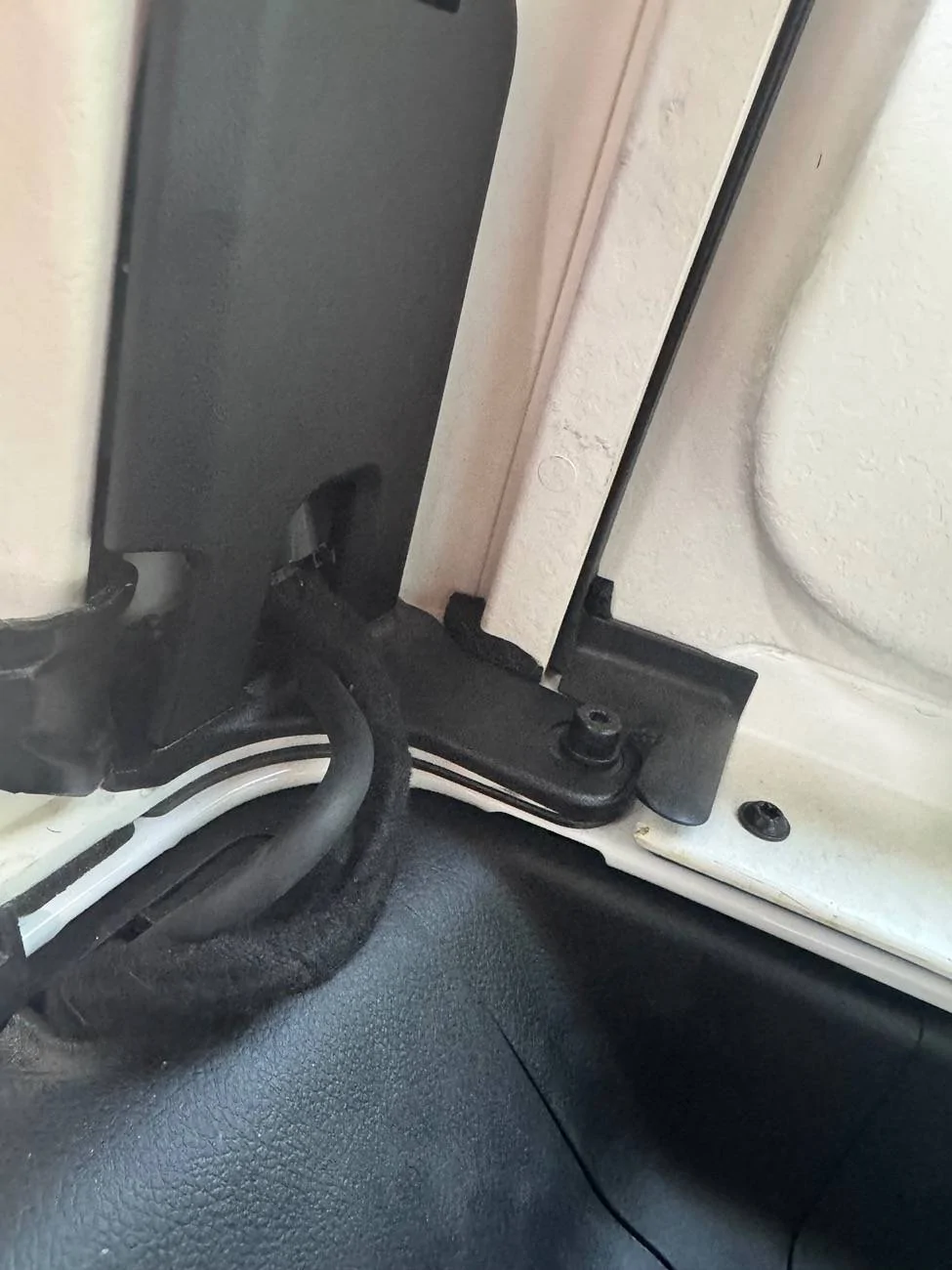

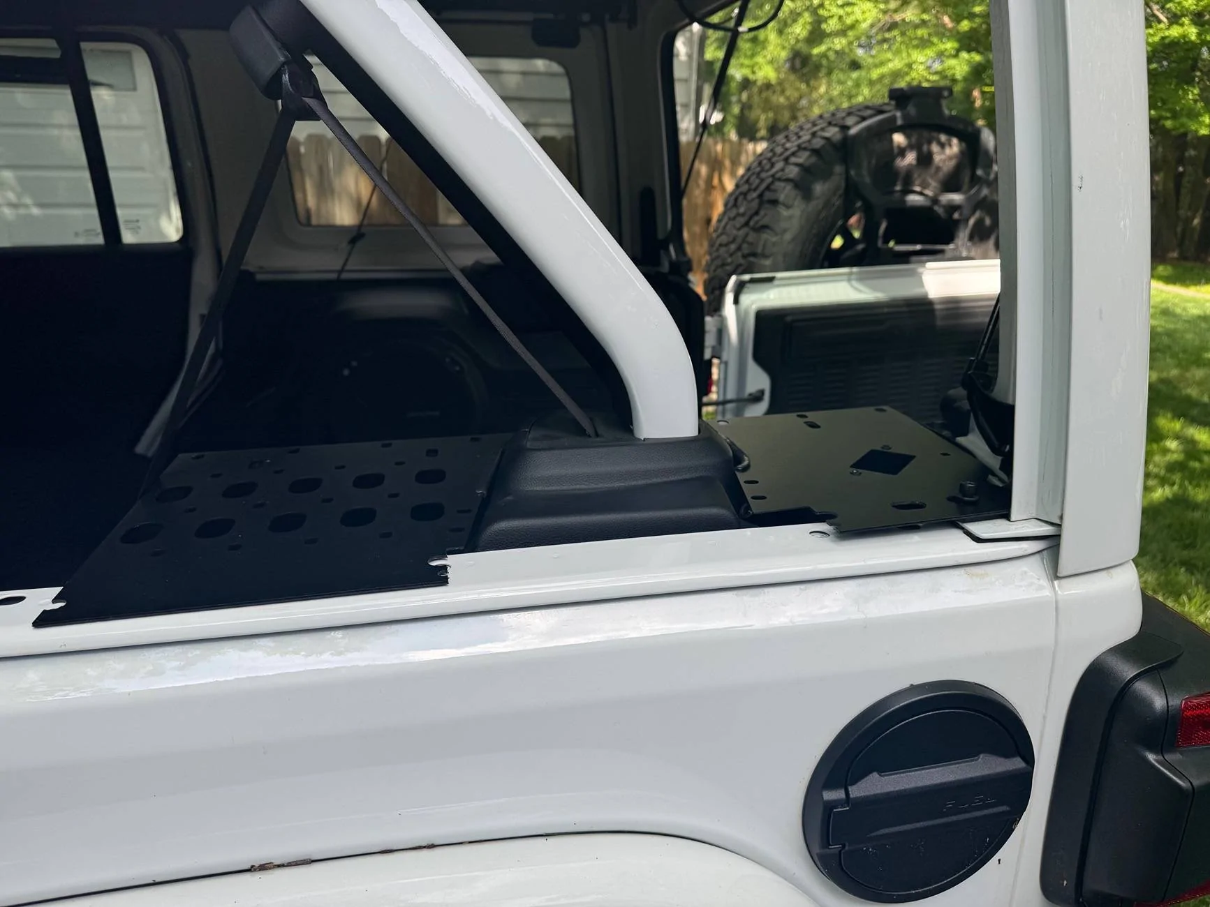

Has anyone installed this on a JLU with the one touch roof? The first issue I'm having relates to getting the side piece under the rear window frame. What bolts need to be removed to slide this under the frame? I've taken out the two on the bottom on each side but before I start taking off other screws I want to make sure of what I'm doing.
Jeep Wrangler JL EZ4x4 Extreme Trunk tempImageoH96oZ
Jeep Wrangler JL EZ4x4 Extreme Trunk tempImage0klF2P

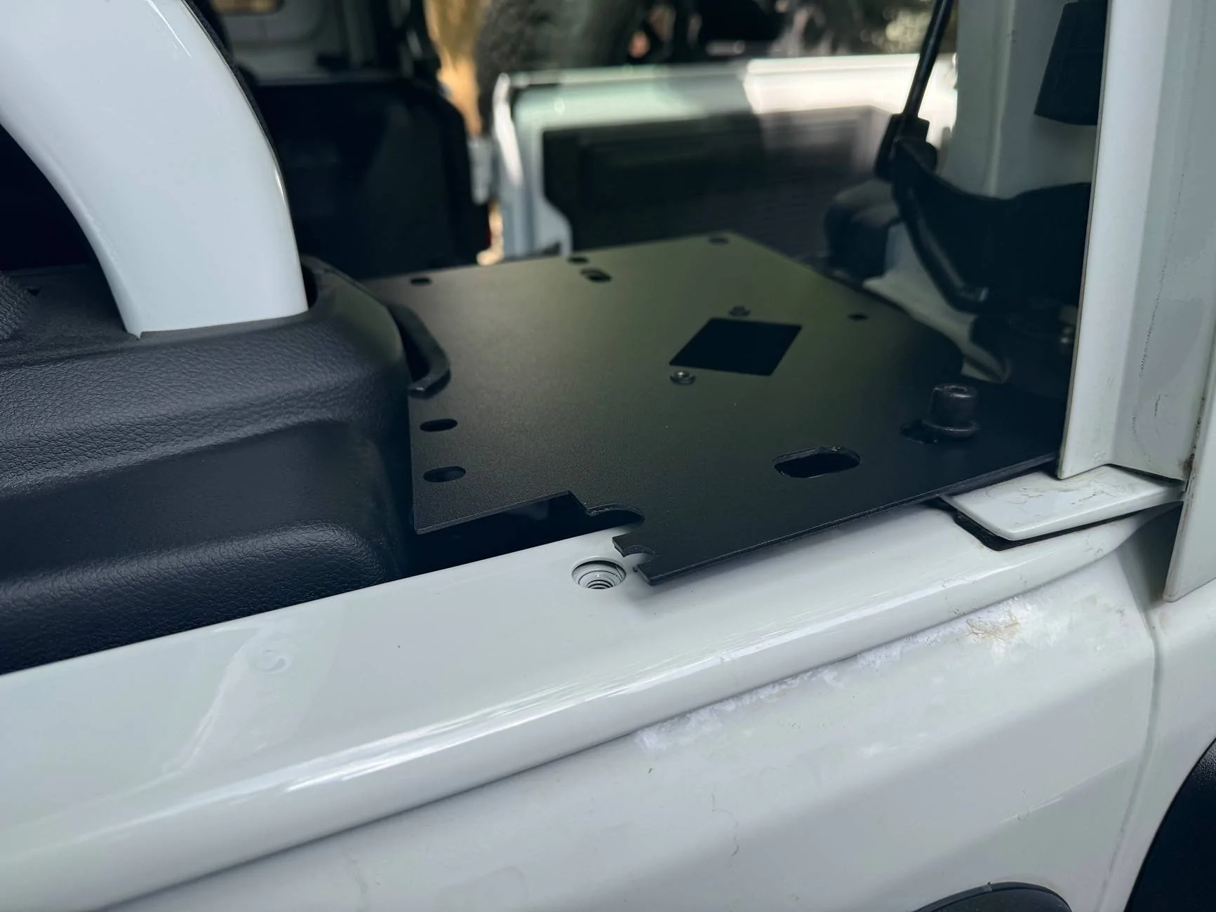

I've removed these two bolts on each side (the one is hidden behind the molding) with no joy.
Jeep Wrangler JL EZ4x4 Extreme Trunk tempImagepVBjJ6
TIA.

To get back on subject a bit. I think like the other options, you have to unbolt the top from the tub and slip it under before rebooting things down. On the flip side… you could cut a notch out and circumvent that.
