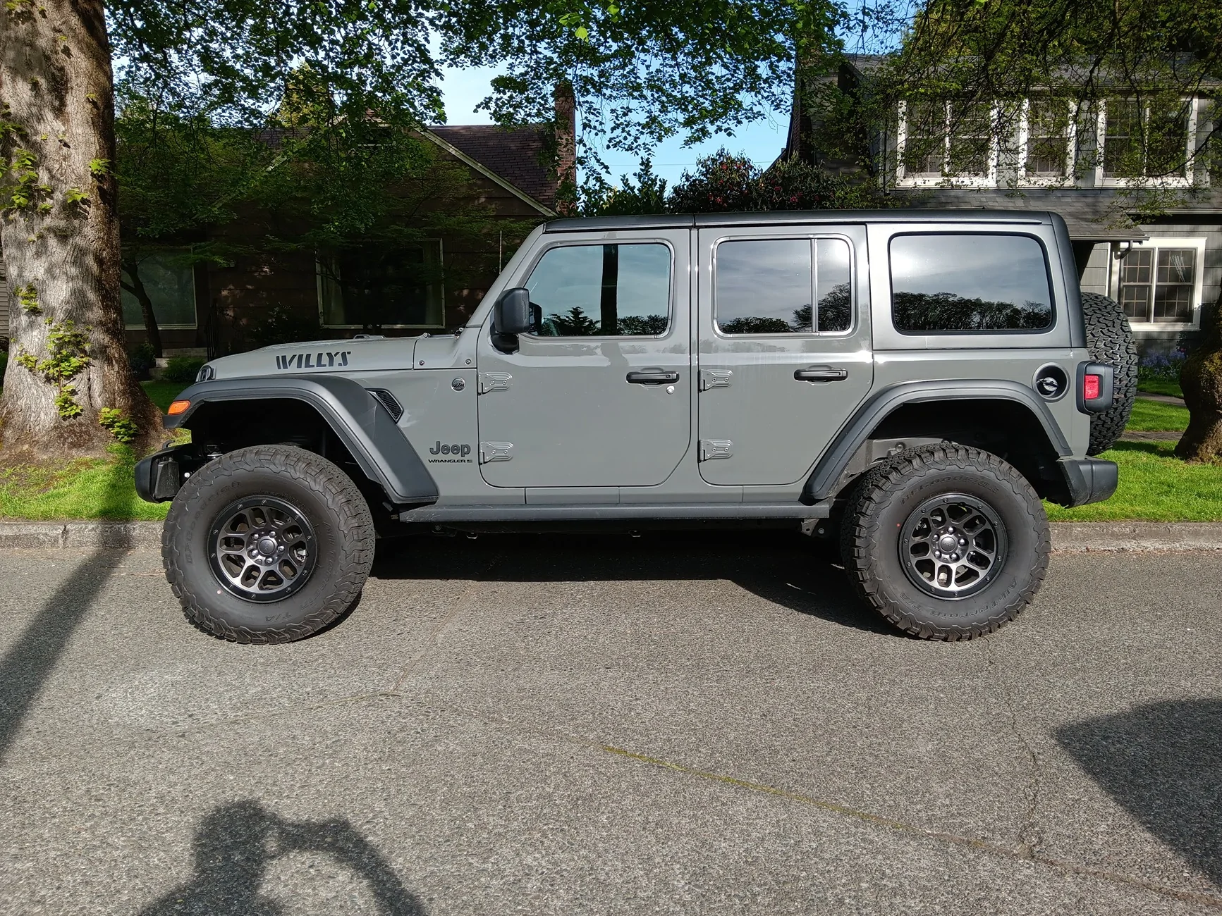

I had them front and rear in my 96 Dodge Ram 1500 (a beast in the snow), front and rear in a buddy's 98 Jeep ZJ, and currently front and rear in my 23 JLU Willys XR. Did a FAD delete up front when we put in the TrueTrac. No issues whatsoever.
Jeep Wrangler JL Truetrac in front 20230503_173517
