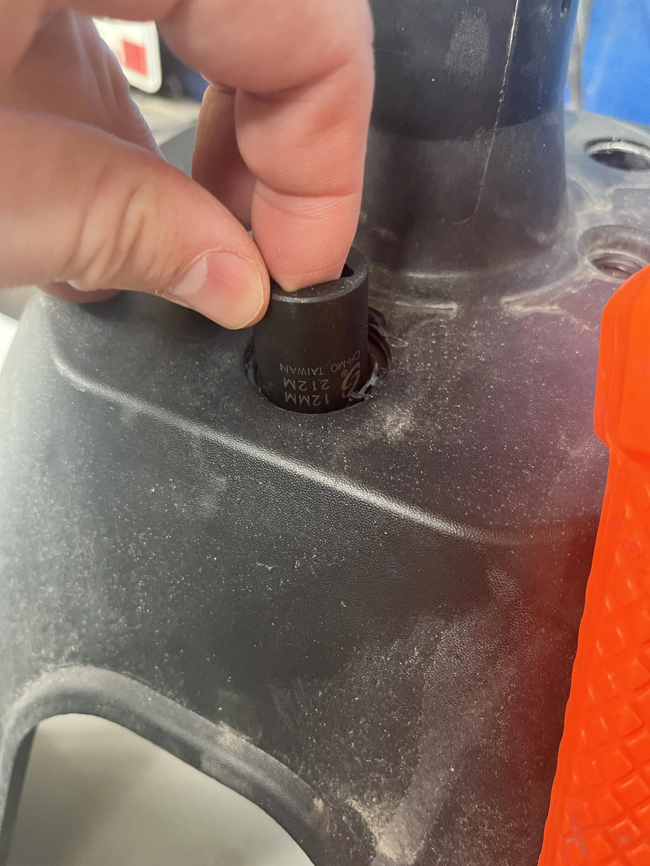

I’ve got a ‘22. The videos I watched skip over this part. I’ve been hammering and prying. Did they glue this POS in here on a ‘22 and has anyone found a good way of removing it?
Jeep Wrangler JL Trick to removing backup camera?? 88A980A2-E796-4D22-BFC1-418AB6255FA9

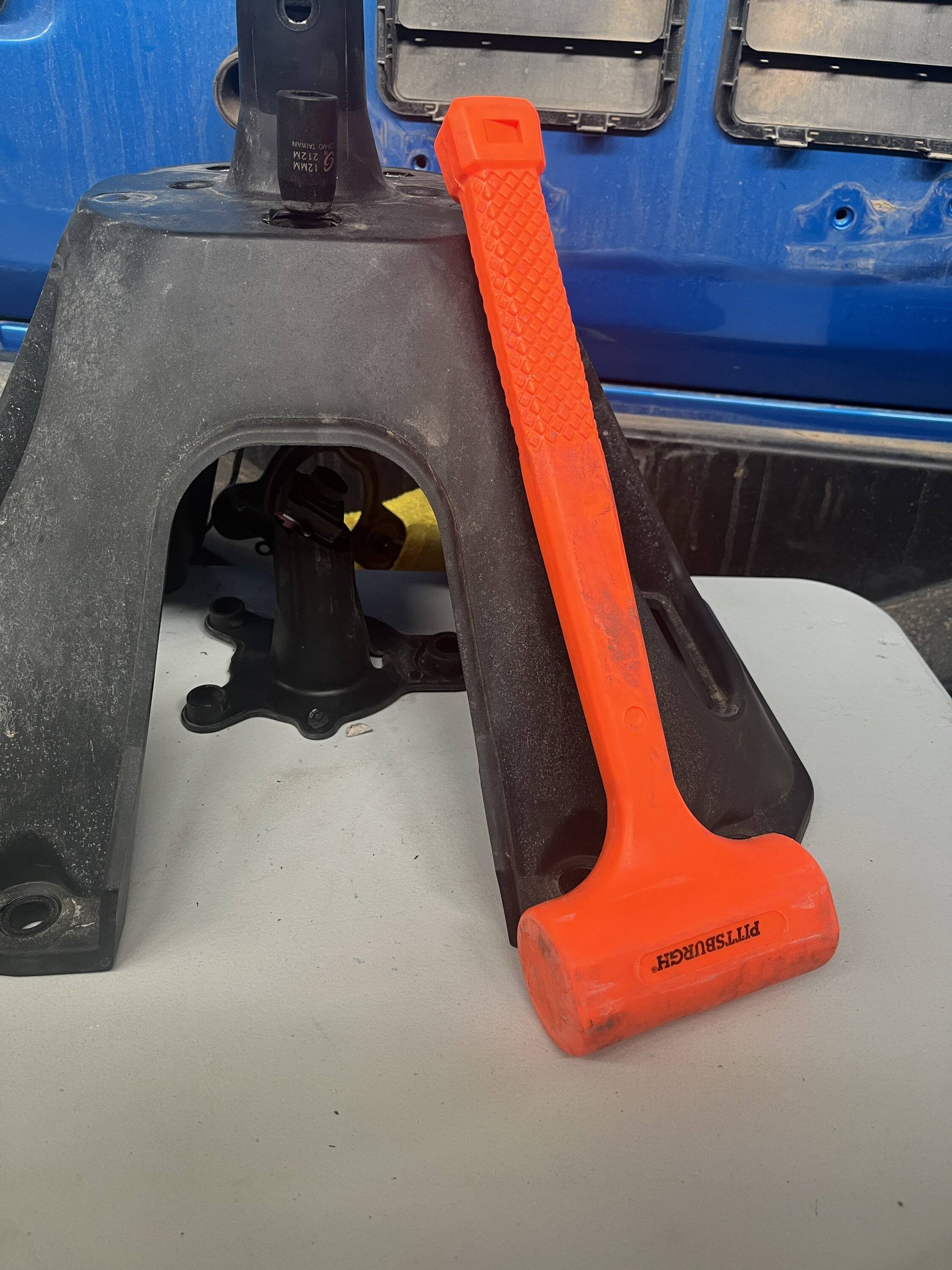

Problem solving… I took a tapered 12mm impact socket and beat the piss out of the bottom single hole, fell out. It took 3 good whacks.
Hopefully this helps someone else at some point too.
