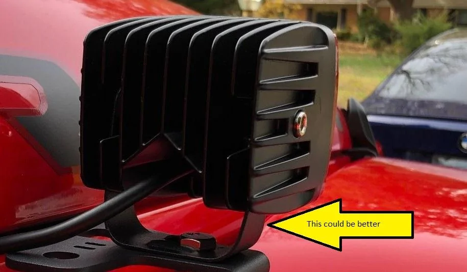

I'm running a pair of your 6 Cube Red Series lights (spot), and I think they're great. The red faceplate blends well with the red Rubi and the output is excellent. However...and there's always a "however..." the hardware and U-shape brackets leave much to be desired.
The brackets are thin and flimsy, and mounting the lights to them was difficult. There isn't an easy way to get the hex bolt to the mounting nut. I had to use a thin 10mm wrench to line it up & hold it in place. Pliers ain't fitting in between the slots. I have several pair of cube lights that have a built-in spot hold the mounting nut securely in place so only a hex bit is needed.

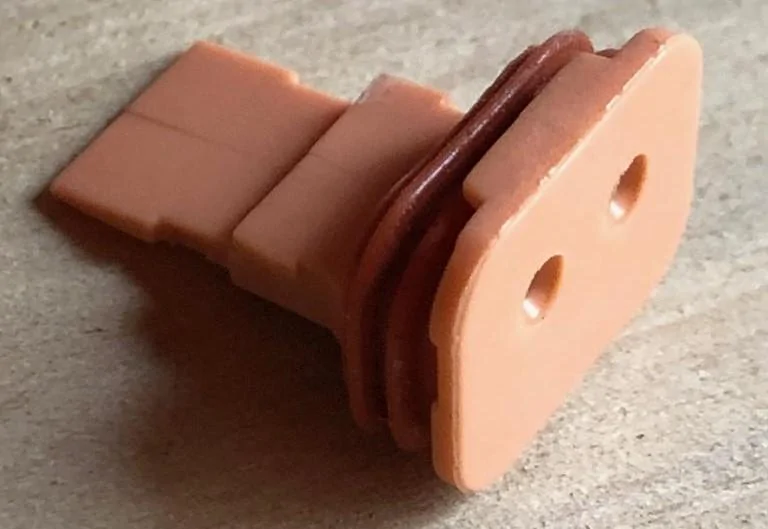

The small piece of waterproofing plastic with the rubber gasket immediately separated from both connectors when disconnected after testing the lights.. I managed to lose one and the other simply won't stay in place. The only way to connect is to keep this little piece out. This doesn't happen with my other lights, and I've disconnected/reconnected them a few times.

Since your order, we have changed the 6mm nuts that mount inside the light, so you'll only need the included allen key to assemble them. It turned out that a few sets got sent out with slightly thinner nuts making the install a bit more complicated. We can send out some of the newer style if you'd like.
In regards to the brackets, they are 18 GA steel, so they should be sufficient to hold the light, we have never had any complaints about them. Can you send us some more feedback on those? Are the lights shaking or moving around?
Ill take a look at some of our harnesses on the shelf and see if there are any issues but, the connectors on the light and harness are designed to be as water tight a possible, so sometimes when pulling the plug out that rubber does that. A bit of dialectic grease will help it slide in and out smoother. We try to build them to really tight tolerances for as much water dispersion as possible. We can also send out the part that got lost and some dielectric grease if you'd like.

I'm certainly happy with the lights. One of the mounts didn't line up properly with the mounting location and there's scraping when I pivot the light. I'll PM you with a picture, and about replacing the mounting hardware. Thank you for the reply.

Sounds good. We can get some new U brackets sent out as well as that part for the plug, and our new nuts.

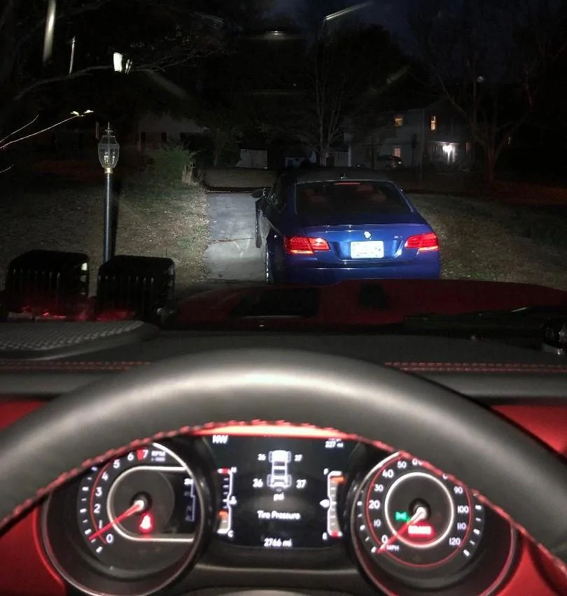

Thank you... here's what the pair of your 6-cubes put out mounted on the fenders... headlights and the pair of cubes mounted on the A-pillar are off. I'm sure by now I may have creeped out my neighbors by lighting up their houses for the past few nights.
