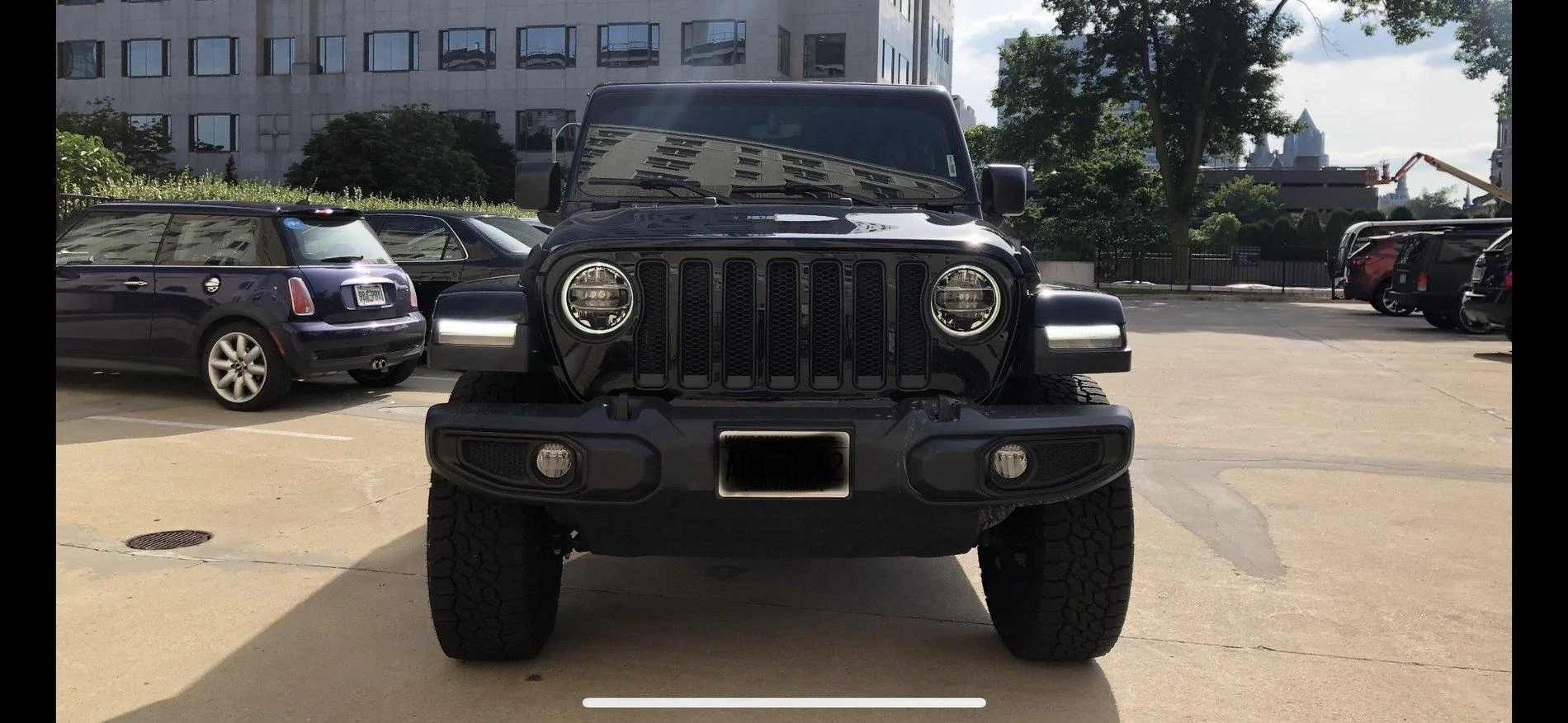

Jeep Wrangler JL Traxda leveling kit 9C02E7EF-29E6-42FE-BF45-1605EF542C1E
All level

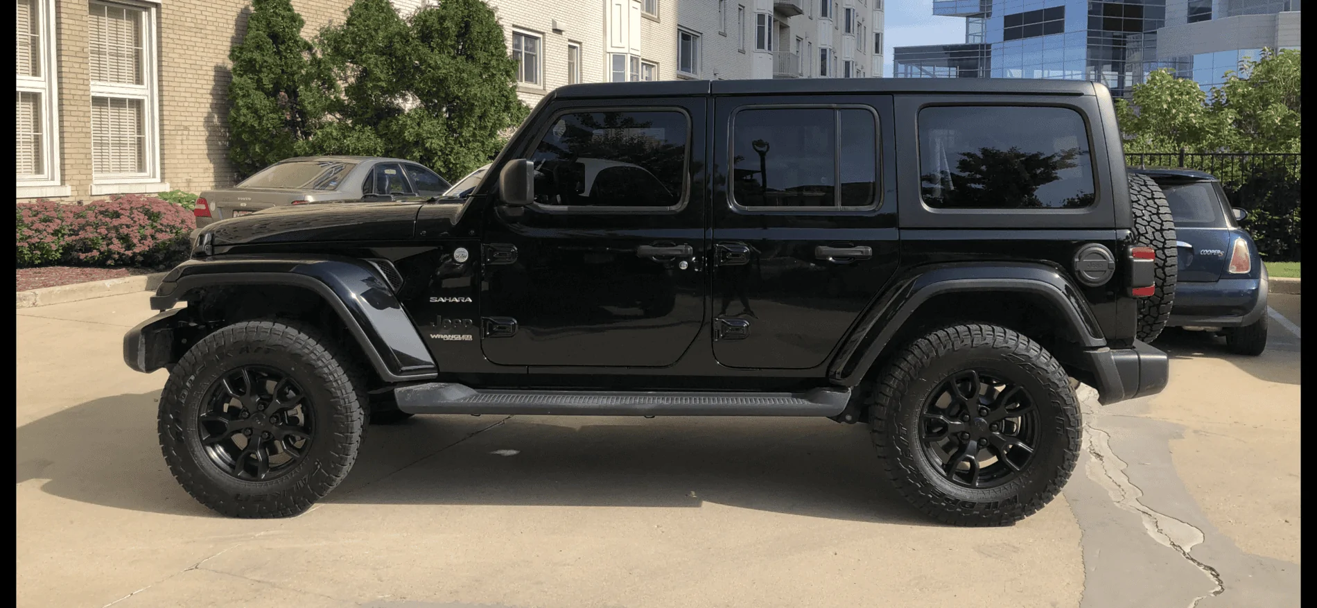

Jeep Wrangler JL Traxda leveling kit 2A0575D7-E5E7-4D0A-9627-A24984903F97

You happen to measure the wheel wells?
Front gap ~ 6.25”
Rear gap ~ 6.00”
Hardtop measured at leading gutter edge ~ 70.5” all around
