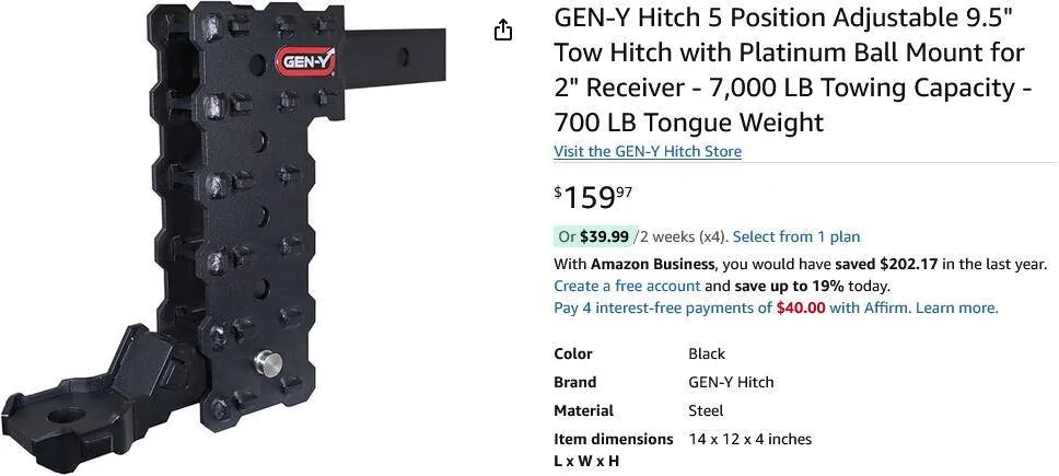

I got a Gen Y adjustable drop on Amazon, it was the most reasonably priced and rated for 7,000 lbs. For the harness, Curt makes a nice 4 way pretty cheap, but you still need to run power under the Jeep to the front. Spend a little more and get the Mopar harness with 4 and 7 way, then you can add a brake controller in the future.

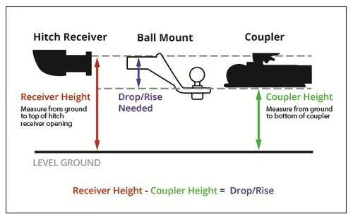

For a fixed drop, measure to the top of the hitch tube. A standard trailer is ~18" plus squat, so you'll want a drop equal to that measurement minus probably 19" to allow for squat (so if the top of the tube is 21", you'd want a 2" drop). Smaller boat trailers may have lower tongue heights, so I would measure the trailer level before buying a drop hitch.

Single axle definitely and no brakes. Ended up ordering the BulletProof ball mount for $119. I like all black. I'll try to grease it and if I have to touch up later, I'm ok with that. Not sure if it has the breakaway as I asked a few times and no answer, but I'm not gonna push it since they are trying to get me a trailer that fits inside my gates. If I can get it inside my yard, I won't need the breakaway feature. I priced UHaul for the wiring and yeah it's about $200. I might just get that done. I'm also checking with a few local places that specialize in accessories for Jeeps and other lifted trucks...I think they might do a great job, but will see what they charge. Hoping to give them some business so when I'm ready for tires and a lift I have a connection.

I see it has a 6" drop, which should work well for you. If you have a lift or an XR, you'll need even more. I use all of the 9.5" on this Gen Y. Made in the USA is a bonus.

No lift…the 6 would have been too much IMO. Considered the 3 or 4 inch drop/rise but having just ordered a new boat, I don’t see the wife letting me lift it or get rims/tires…yet
