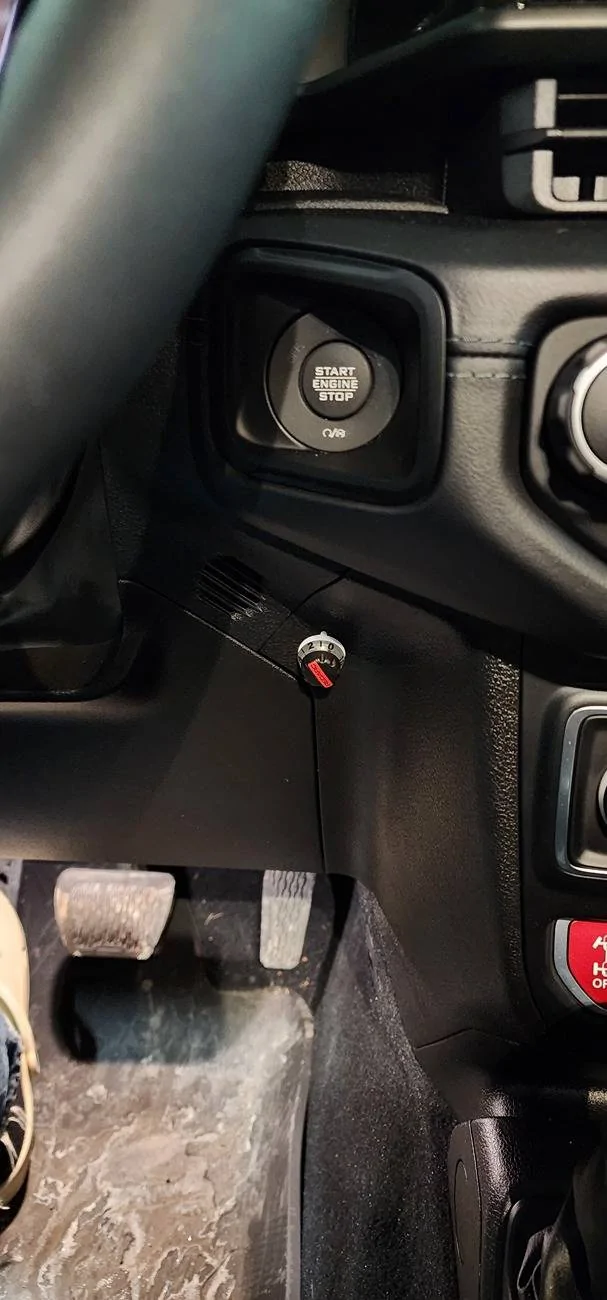

Agreed, with the tow package/harness factory installed, it take all of 5 min to install almost any brake controller. I also did the RedArc, love the look/size and ease.....the longest part was trying to determine where to install the dial.
I need up putting to the lower right of the steering wheel. Out of the way but still easy to get at.
(The final location is the blue tape circled)
Jeep Wrangler JL Trailer brake controller 20240908_123707

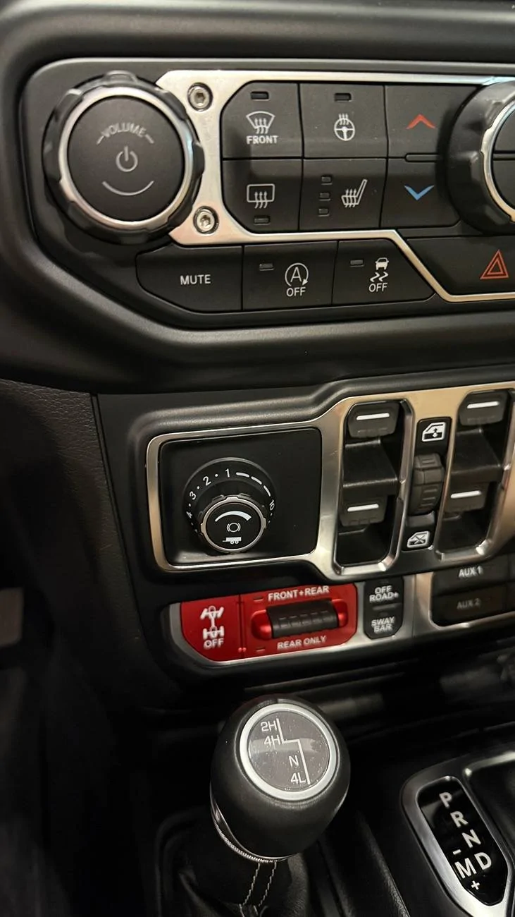

I have the Mopar controller in my '22 Rubicon with the factory tow package. Installed it myself pretty easily. Hardest part was removing the damn power outlet. Even with a removal tool, it fought me hard. I have a Redarc in my Grand Cherokee, but preferred the clean, factory look of this for my Rubicon.
Jeep Wrangler JL Trailer brake controller IMG_0548

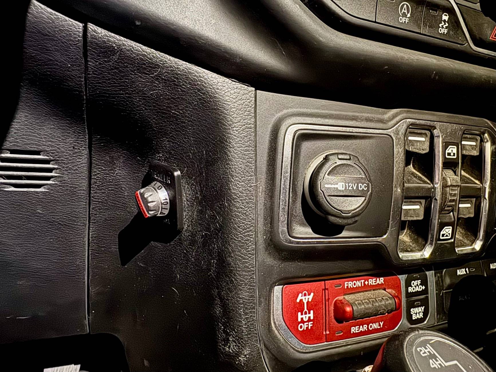

I put it a little farther to the side, and I included the rectangle base to make it look stock.
Jeep Wrangler JL Trailer brake controller IMG_3610
