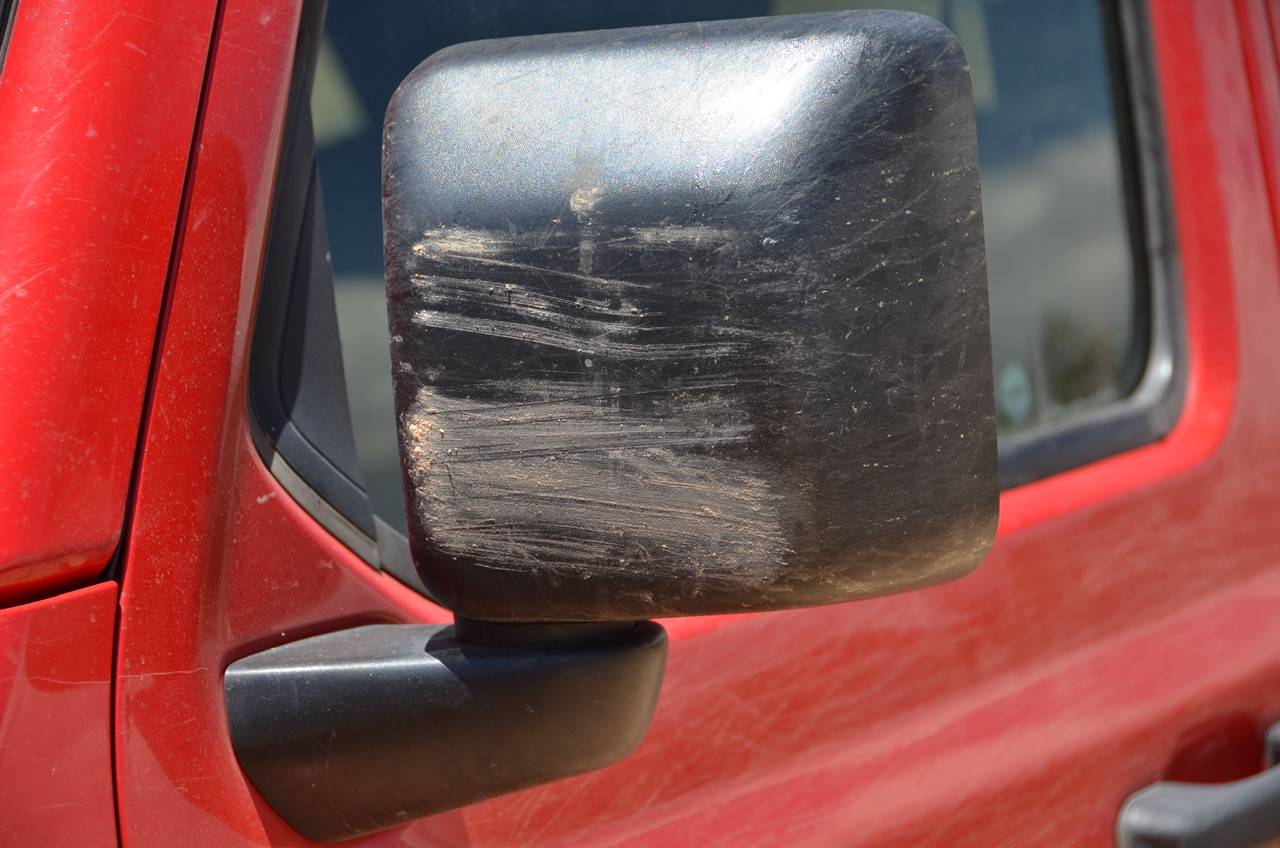

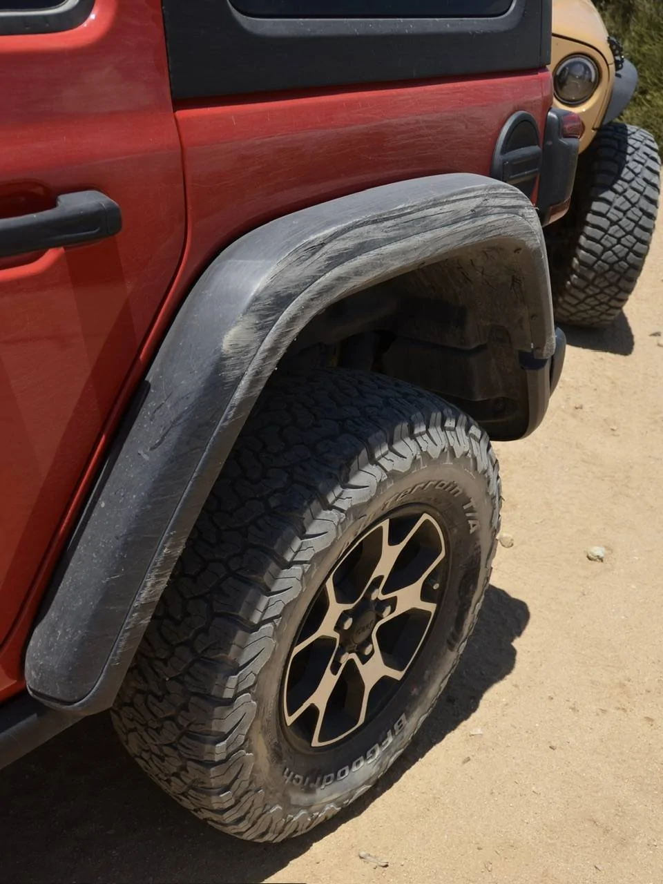

Yup… 😆
Please let me know if you have a technique for remediating trail rash on plastic. 🤕
OK, I found a way to make the texture. You have to sand all the deep scratches out. I used a ~150 grit. Then took my MAP torch and held it back around 4-5" and moved it smoothly back and forth until I saw some reaction on the surface, then let it cool. You can see the texture form when using the torch. Keep it moving smoothly. Don't get too greedy.
