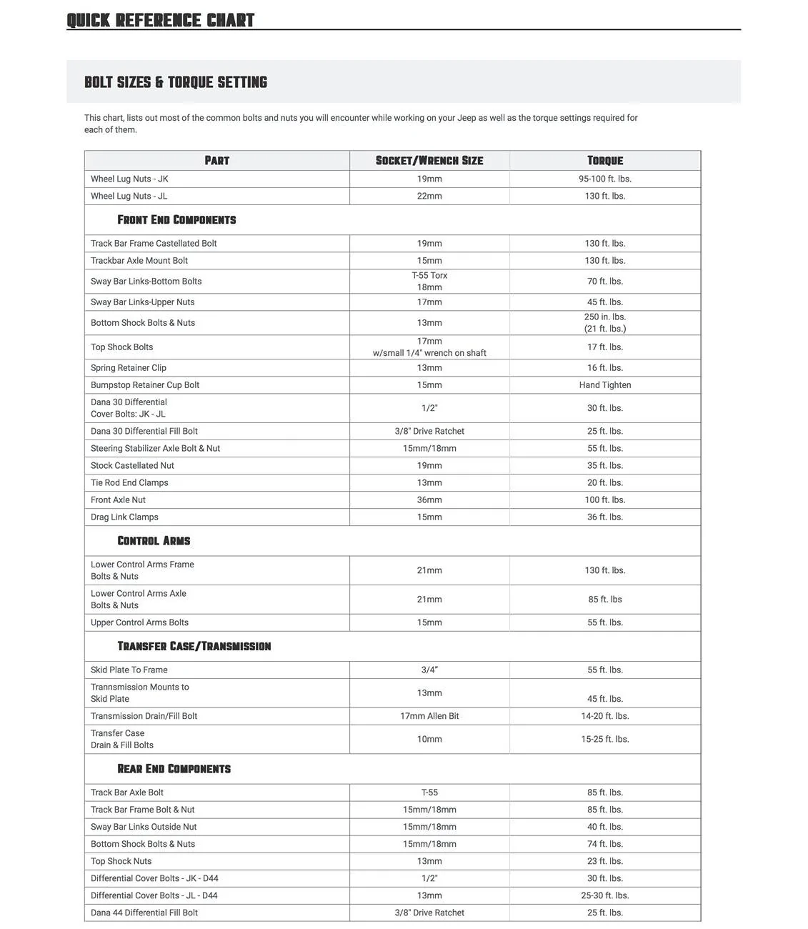

It depends on how thorough you want to be.
Northridge published a list some time back:
Jeep Wrangler JL Trail-ready inspection checklist? IMG_3869

If you go to the effort of checking your suspension bolts for torque you should mark them with a paint marker so you can visually inspect them later.
Most checklists I’ve seen are about safety.. on that note, check your fire extinguisher.
