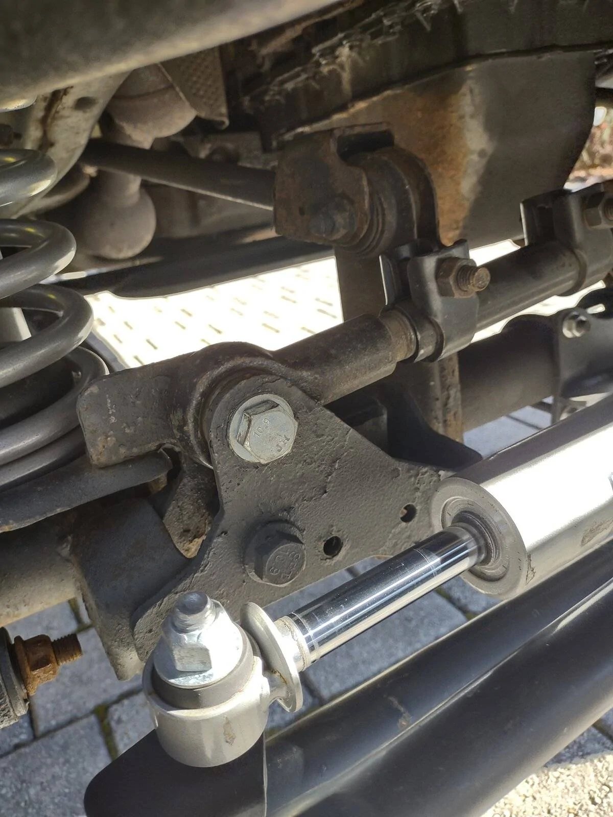

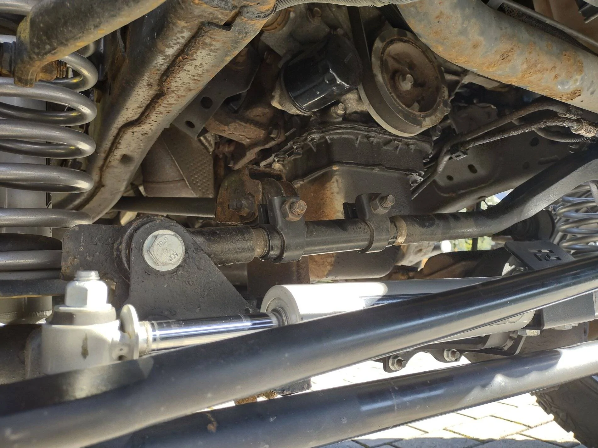

On my Daughters 2009 JKU the track bar bushing has some movement. She has a bad wobble after hitting certain bumps. The track bar has been replaced years ago and we don't know what one it is. The previous owner thinks RC... Does anyone know where I can find a replacement bushing for this? See pics

Looks like an RC. Just a heads up if you don't want to screw with the clevites, a new one is about $150.
If RC doesn't have replacements handy, you should be able to measure with a caliper and get a set from Energy or a similar aftermarket bushing manufacturer.

I would definitely just get a new one, or a different brand that’s rebuildable.
